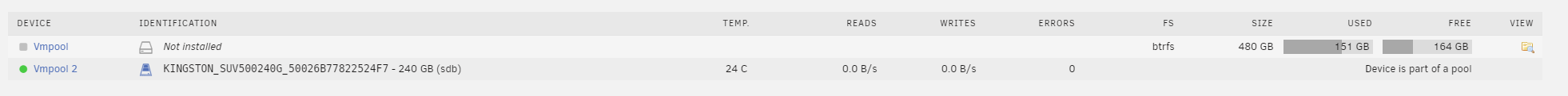

Now the thing is, I have a pool for my VirtualMachines and one of that disks looks to be dead, well OK

Oh that's interesting, I didn't notices that it had issues with 2 disks. I thought it was only 1 because in the UI only 1 disks is "not installed". But yes if both disks have issues (perhaps the same controller need to check) then I can assume it has trouble accessing my data.

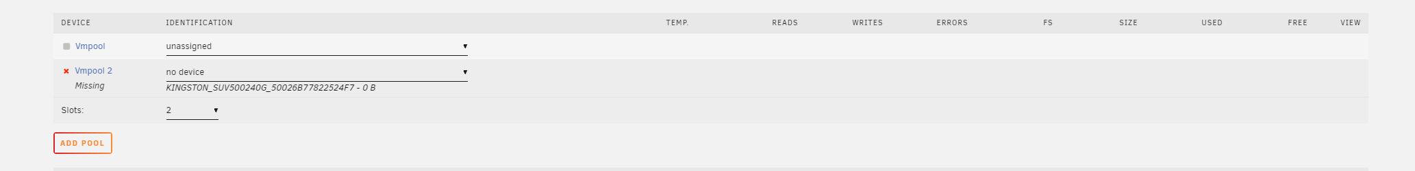

Well... that was strange:
When I stopped the array only 1 disk was missing the other one was "unassigned".
(They both where not listed in the "choose device" select)

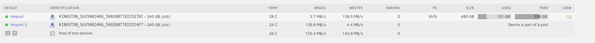

But then after replugging them:
Not really sure what happend. They where on the same controller yes, but also other disks where on that controller.

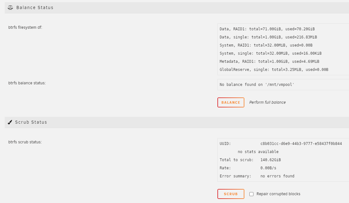

Oh and another question: I now notice my pool was converted to non-raid? So why?

GUI is not great for monitoring pools, see here for more info.
Ah great! I did not know that that was not fully integrated yet. I have now added the script (and yes this pool had errors, reset them now so i know if it still is a problem). Thanks for the tips!
