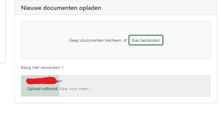

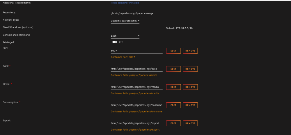

I just got Paperless set up and I can't upload any documents through the Web UI. The upload just times out and I get a "Connection Reset" in the browser console and "HTTP Error 0" on the upload progress bar. In the container logs I see:
[2021-04-13 22:43:22,109] [WARNING] [django.request] Method Not Allowed: /api/documents/post_document/
Any ideas of what to adjust?
Are you connecting directly through the port of paperless or a reverse proxy? I'm not sure but perhaps check the settings could be that it is disabled for your account (but I'm no expert so I'm not sure if that exists).
I’m connecting directly. The only change I have from a default setup is that the container is running on a VLAN but I don’t see how that should affect anything?
Edited by Adam1
A vlan should have no effect, a reverse proxy might do something with uploads.
You also never see the "Upload completed"?
Correct, the progress bar never moves and the upload fails. I’m not using a reverse proxy on this container.
Hm sorry I don't have a clue perhaps someone else. I assume the container has already been restarted? You can confirm if the directory is writeable for the uploaded files (although the message looks like it already stops before that but I don't know the source). Or perhaps check the paperless github to submit a bug report there.
I've tried different Redis images (just in case) but still have the same problem; That is, everything works fine initially, then when I come back to it the following day it no longer works. Paperless correctly detects a new file in the watch folder and the log shows it has added it to the task queue, but nothing else happens unless I restart the paperless-ng container. I do not need to restart the redis container to get it working again, just the paperless-ng one.
Has anyone found a solution for this? TIA

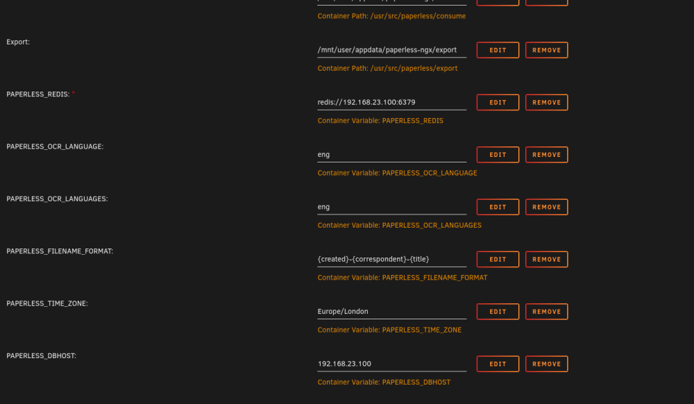

Error 500 when upoading via the WebUI
EDIT:
The Error was because i was using the wrong Redis Docker. With jj9987's Repository it worked.

Hey there,
I'm a bit desprate here with my paperless installation here.
I run it on Unraid and here is what I did so far, but always ending up in internal Server Error 500 while trying to upload a file as well as my consumefolder is still untouched so far:
Installed docker container of paperless ng
installed redis by jj9987 wit the correct port
changed OCR to deu, changed secret key, changed port to 8001 (8000 is already in use)
added a paperless.conf file in swag with following content
server {
    listen 443 ssl;
    listen [::]:443 ssl;
    server_name mordorpaper.*;
    include /config/nginx/ssl.conf;
    client_max_body_size 100M;
    # enable for ldap auth, fill in ldap details in ldap.conf
    #include /config/nginx/ldap.conf;
    # enable for Authelia
    #include /config/nginx/authelia-server.conf;
    #Organizr ServerAuth
    #include /config/nginx/proxy-confs/organizr-auth.subfolder.conf;
    #auth_request /auth-0;
    location / {
        # enable the next two lines for http auth
        #auth_basic "Restricted";
        #auth_basic_user_file /config/nginx/.htpasswd;
        # enable the next two lines for ldap auth
        #auth_request /auth;
        #error_page 401 =200 /ldaplogin;
        #include /config/nginx/authelia-location.conf;
        include /config/nginx/proxy.conf;
        resolver 127.0.0.11 valid=30s;
        set $upstream_app UnRaid _IP;
        set $upstream_port 8001;
        set $upstream_proto http;
        proxy_pass $upstream_proto://$upstream_app:$upstream_port;
restarted all of the dockers
Where am I missing the obvoius?
Thanks
4 minutes ago, prl3st said:
Hey there,
Thanks
What if you access paperless directly and not through a reverse proxy. Does it work then? If so the issue is not with paperless.
And about the consume: is there anything in the logs?
Yes the obvoius... the logs (sorry new to unraid always forget there are logs)
So Problem was that I defined the redis IP in the paperless docker to look upon the very same docker... so my mistake.
Thank you for the hint!
