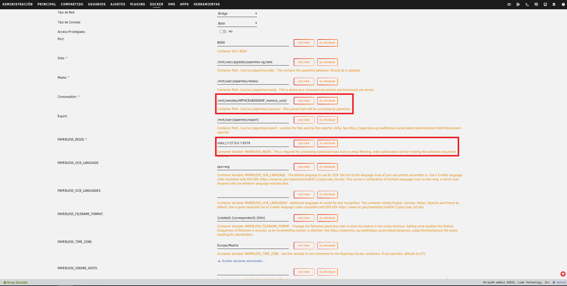

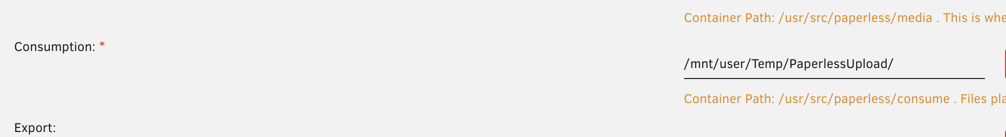

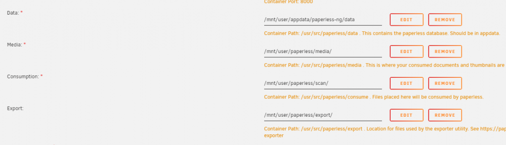

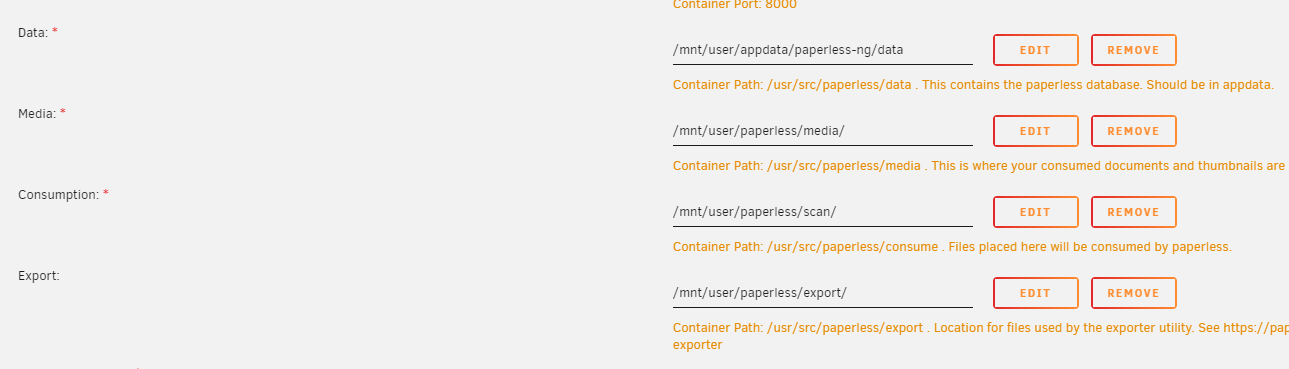

Set it up this weekend, and having a small issue.  I can manually add files just fine.  However, the consumption watcher never hits the directory I'm using.
I set the directory to a share on my server so I can export from my scanner, etc135806170_ScreenShot2021-05-24at2_16_12PM.thumb.png.da9d0c811922a71856b2ca7f222f6413.png
Looking at the logs, it seems to be watching a different directory for changes:
846859565_ScreenShot2021-05-24at2_17_44PM.thumb.png.bf37ba8cc3a5602e48528f1c689a8d82.png
I'm sure I made a simple mistake but I think I've looked at it so long now I'm overlooking it.

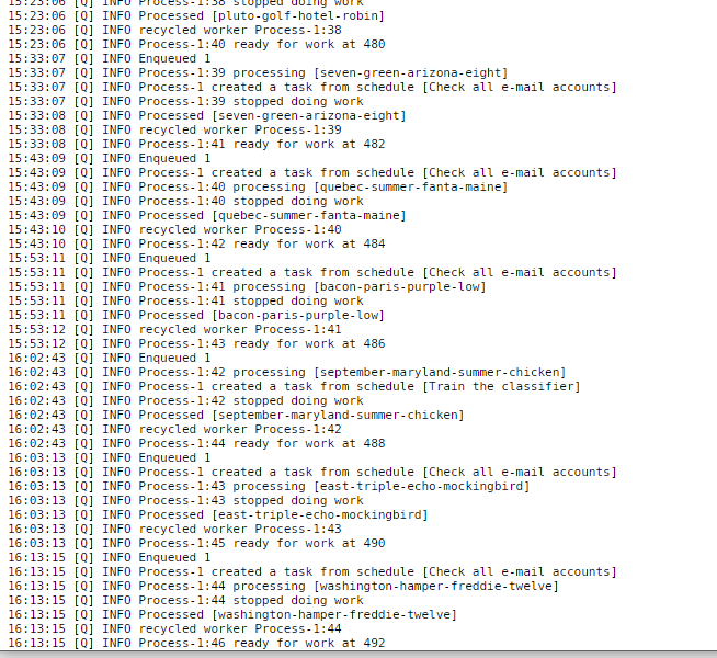

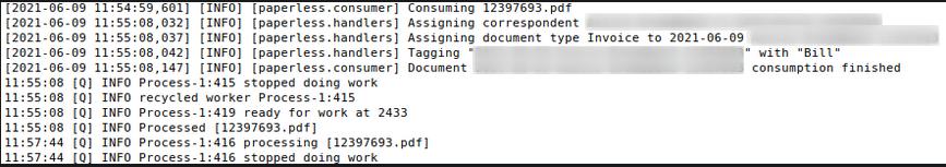

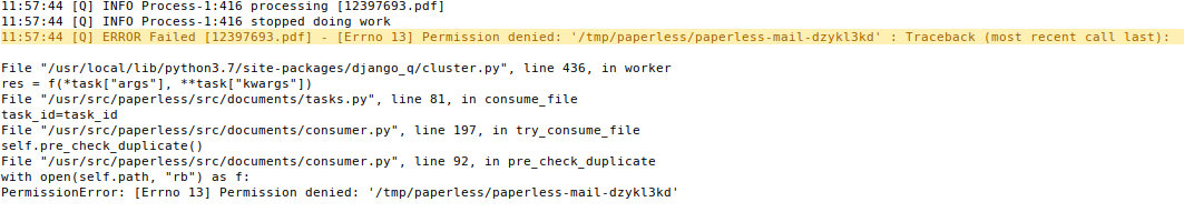

My Paperless was working well for a while but my mail fetching doesn't seem to work anymore.  When I manually add files by drag and drop or browse files it all works fine.
When I run the mail fetcher I get this in the paperless.log
This is also shown in the docker log:
The mail fetching side of things seems to be working fine:
I have 777 permissions on my three mounted Media, Consume and Export directories and as I said - manual uploads work fine. Has anyone had any issues with mail fetching lately?
I have no issues with the latest version (no update available). Does this happen with all mails? Or only a certain document?
Every email and on both accounts that I have fetching.

Hi there folks, here another user with some configuration problems.
Here are the steps I've completed so far:
1) Redis docker installation with default configuration. No password has been configured, just plain installation:
2) Paperless-ng installation; folders have been configured and here comes the problem: redis IP config (and maybe the consumption folder). I'm trying to follow the same workflow explained by the OP. This is, taking documents from SMB folder in printer and process them. Here is my docker config. Must say I've tried with localhost, 127.0.0.1, server name and so on, and nothing seems to work.
3) Finally, paperless-ng logs:

What does the log tell you when you use your server IP address i.e. `redis://XXX.XXX.XXX.XX:6379`. I think `127.0.0.1` will not work, because it tries to resolve Redis in the paperless-ng container then. Keep me posted.
Great! Changed IP to 192.168.x.x and seems network issue has been solved.

    self.read_xref_from(parser, pos, self.xrefs)
  File "/usr/local/lib/python3.7/site-packages/pdfminer/pdfdocument.py", line 806, in read_xref_from
    (pos, token) = parser.nexttoken()
  File "/usr/local/lib/python3.7/site-packages/pdfminer/psparser.py", line 493, in nexttoken
    self.fillbuf()
  File "/usr/local/lib/python3.7/site-packages/pdfminer/psparser.py", line 219, in fillbuf
    self.buf = self.fp.read(self.BUFSIZ)
PermissionError: [Errno 13] Permission denied
[2021-08-19 11:37:20,763] [DEBUG] [paperless.parsing.tesseract] Calling OCRmyPDF with args: {'input_file': '/usr/src/paperless/src/../consume/scan.pdf', 'output_file': '/tmp/paperless/paperless-rhgt24hs/archive.pdf', 'use_threads': True, 'jobs': 3, 'language': 'spa+eng', 'output_type': 'pdfa', 'progress_bar': False, 'skip_text': True, 'clean': True, 'deskew': True, 'rotate_pages': True, 'rotate_pages_threshold': 12.0, 'sidecar': '/tmp/paperless/paperless-rhgt24hs/sidecar.txt'}
Thank you @T0a!
Forgot to say I'm using unassigned devices plugin to mount SMB folder
Edited by lgb
Adding some info
For reference:
127.0.0.1 IN A container refers to the container itself. So that will only work if you have a single container with for example paperless AND redis.
