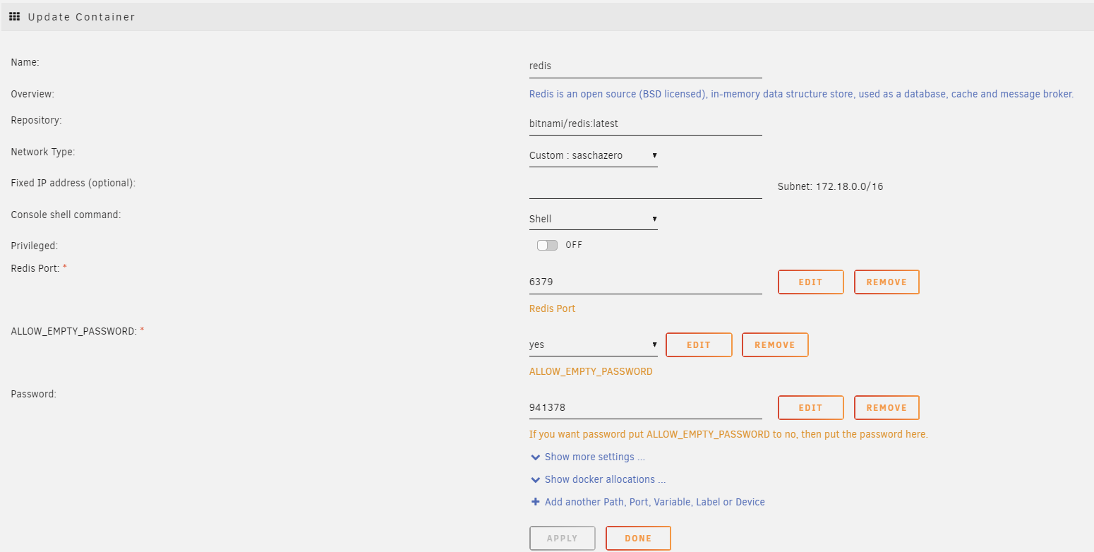

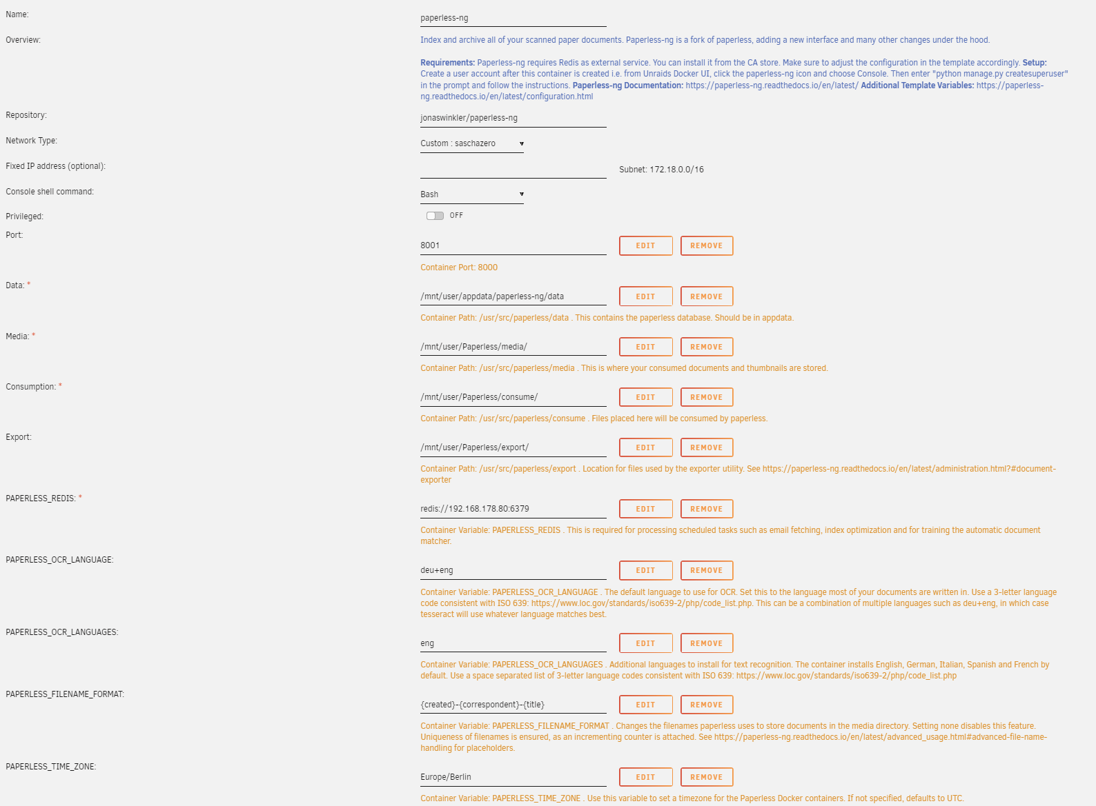

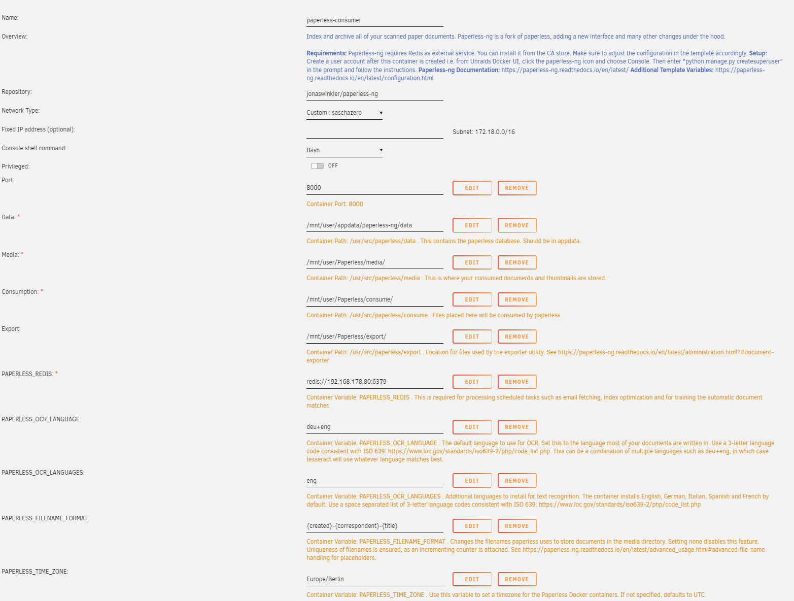

My setup:
Redis:
paperless-ng:
paperless-consumer:

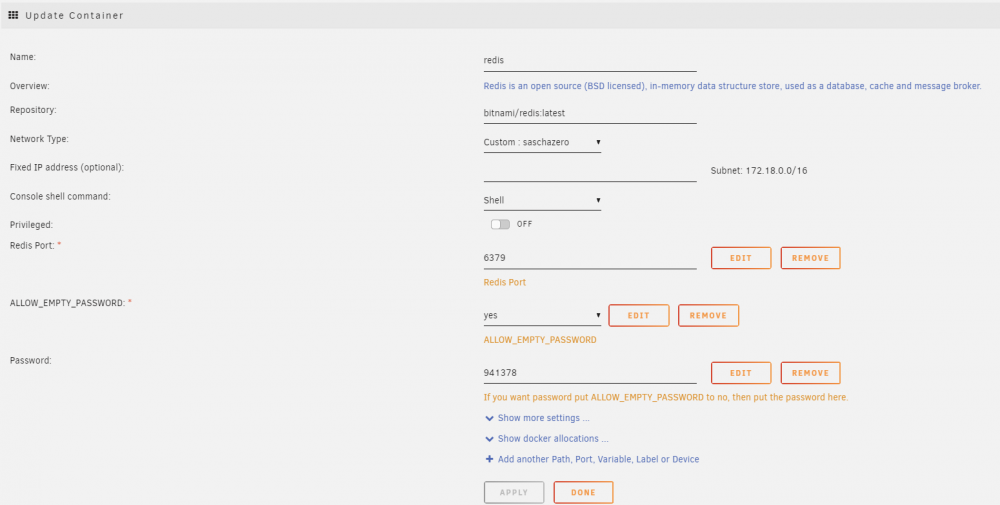

try removing the password from the redis container. you've got it set to allow a blank password (ie no password) but then have a password set. Either set ALLOW_EMPTY_PASSWORD to no and specify the redis password in the paperless-ng config or blank the password in the REDIS container config
Dave

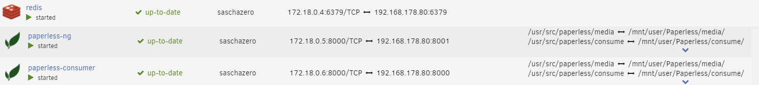

@FlubsterThanks for your answer. It works now. I also had to do a few more steps. Not exactly sure what the problem was. I did the following:
1. Deleted the password from the redis container. (didn't work yet)
2. checked the ports, and gave the docker container paperless-consumer a new port, i.e. 8002
3. reinstalled another redis container (from jj9987)
