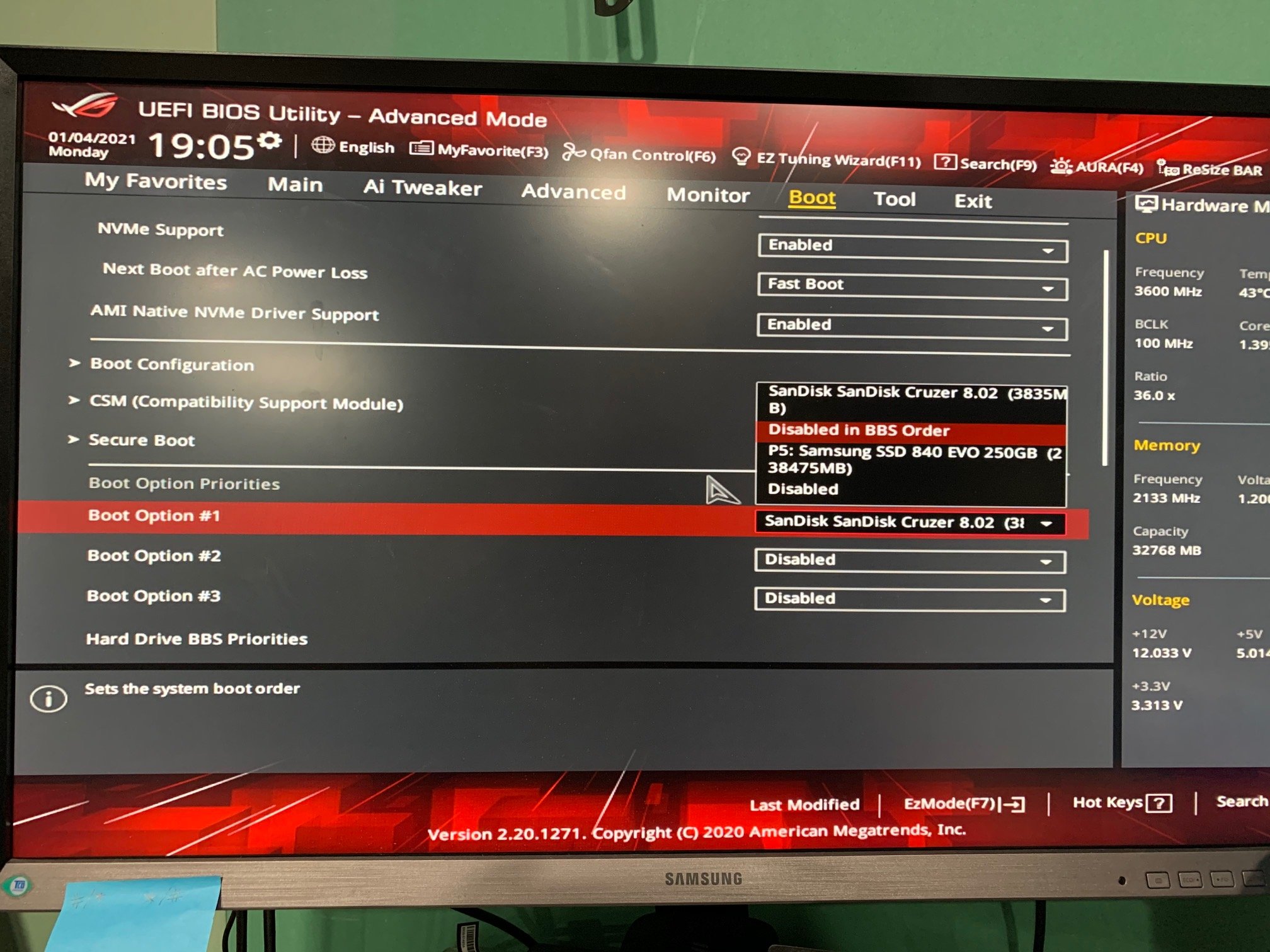

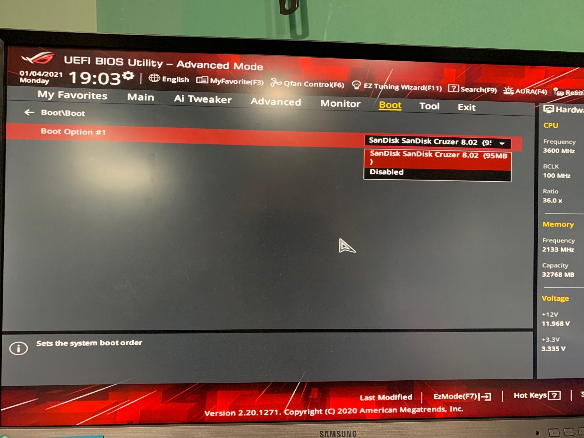

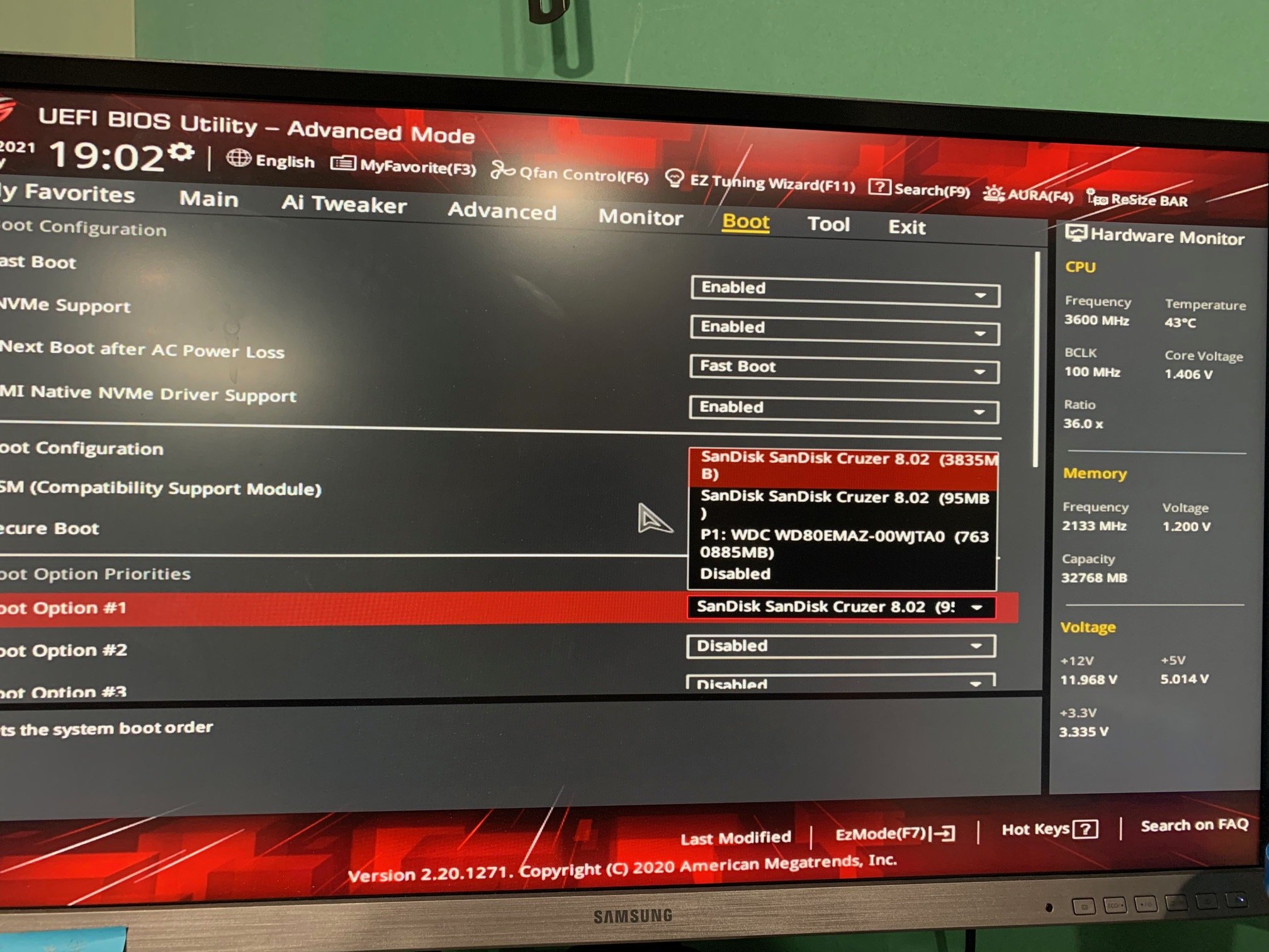

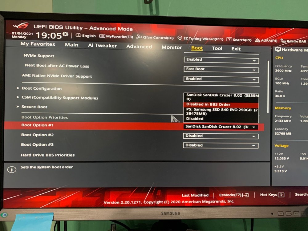

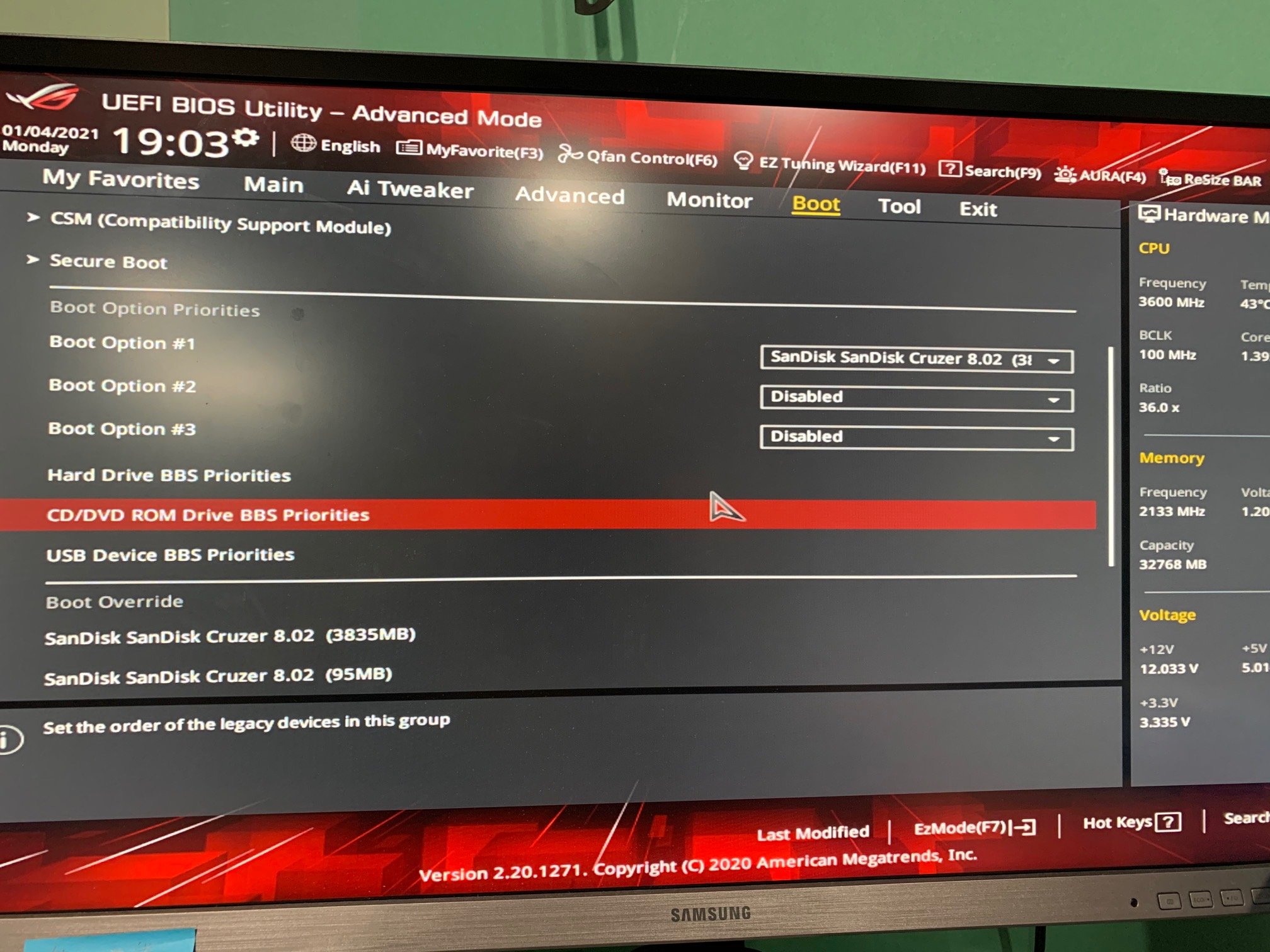

I booted back into the BIOS so I could share what I see.  I've attached the image showing the two bootable items from my flash drive, one of which matches closely to sr0 (95/96MB).  I then seen only the 95MB item showing under CD / DVD ROM Drive BBS Priorities which was selected.  I disabled it and then see it shows "disabled in BBS Order" for Boot Option #1.
I'm not sure what all this is but I've selected the 3835MB item for Boot Option # 1 and disabled for all other Boot Options and BBS Priorities.
I've also re-uploaded the diagnostics.zip for reference since I'm not sure where you seen all the sr0 errors.

15 hours ago, jonathanm said:
Google "remove U3 sandisk"

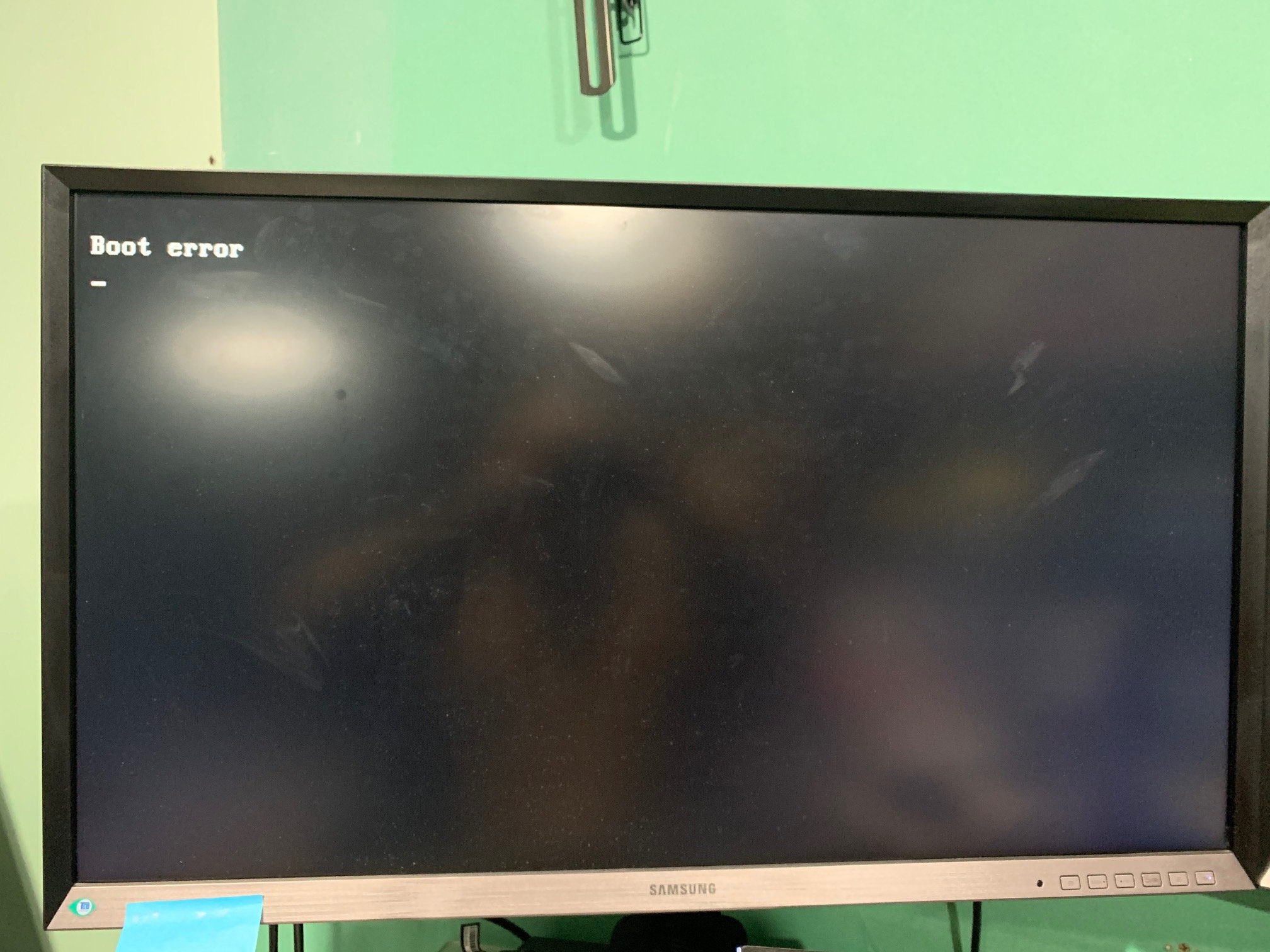

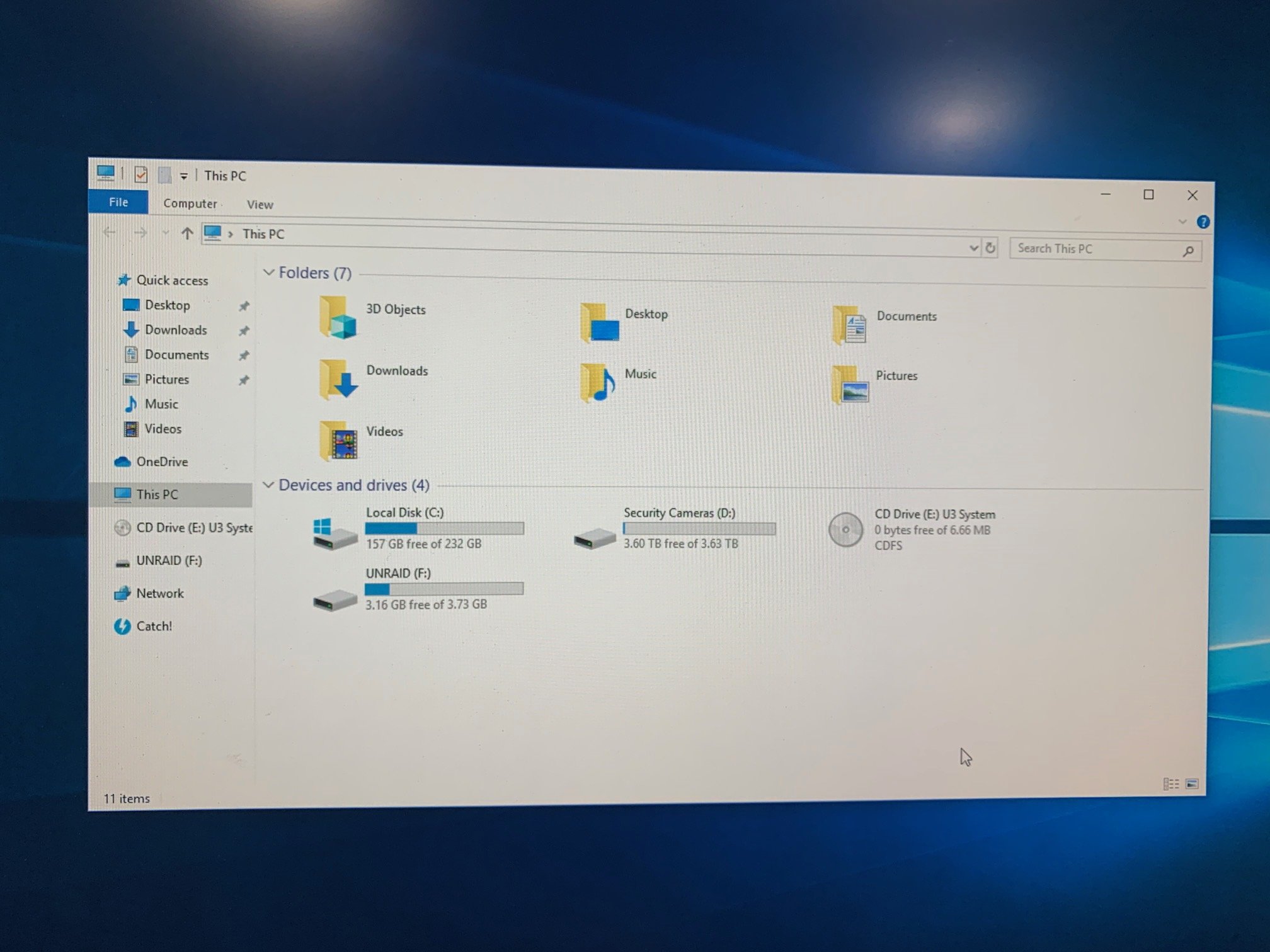

Good catch!!  I've removed the U3 software which removed the 95MB bootable item from the BIOS but unfortunately can no longer boot the drive.  All the files are there but I receive a Boot Error message.
I see there's a "make bootable.bat" but didn't want to run it as administrator before checking here ... please advise.  Also, I've read I should avoid booting unRAID UEFI ... is this correct that I should avoid and will it have any affect on my Docker/VM performance?
Edited by bugsysiegals
Just backup the config folder from flash, prepare it as a new install, copy the config folder back. UEFI is preferred if it works for you otherwise legacy.
I read make bootable wouldn't hurt the configuration files so I tried it and it worked! :)
I no longer see the sr0 drive showing up and log has been 1%.  It seems it should be good to go other than my Gaming VM performance which I'll open a new thread for.  Thanks guys!
