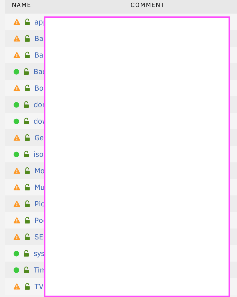

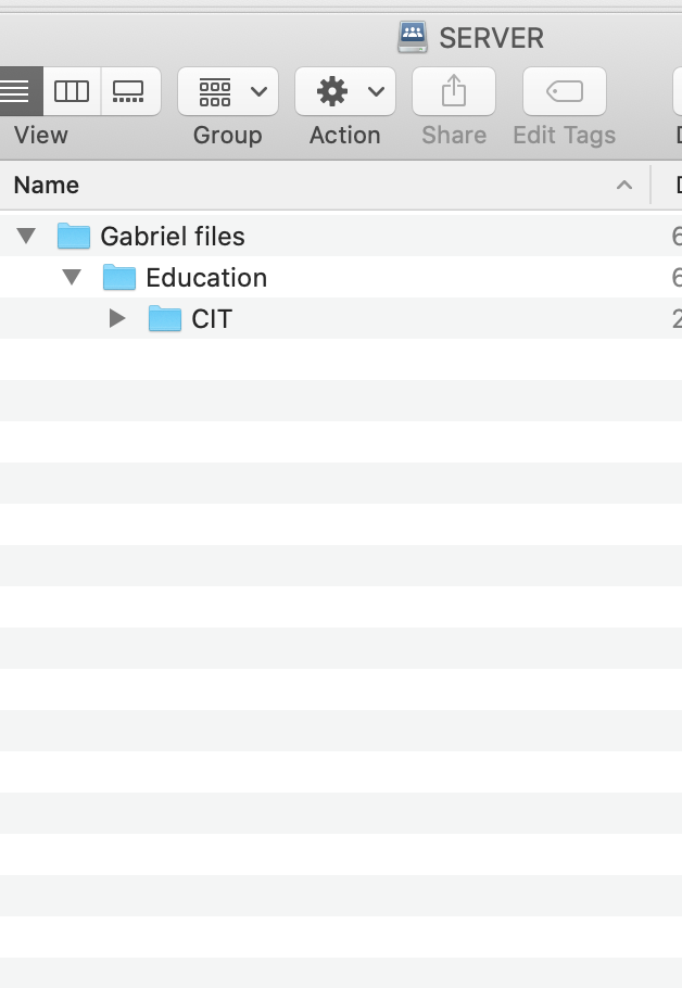

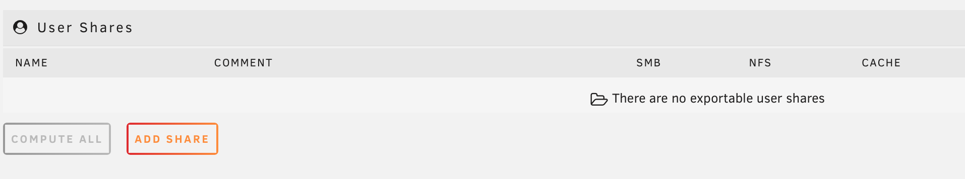

3. as part of the whole 'weird errors are happening' situation, I have also discovered that user shares do not show up in the 'SHARES' menu, and when I connect to the server I can only see select trees and everything else is missing, requiring a restart to fix.
Before restart:

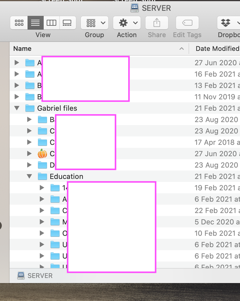

After restart:
1932526443_ScreenShot2021-02-26at7_04_48am.thumb.png.e06c7e5c853503537c03bf19b4d9277d.png1163946971_ScreenShot2021-02-26at7_04_16am.thumb.png.a19cf3a4e2ad3dfc88f4dad23aeaf0a4.png

  4. The user shares are simply the aggregate of all top level folders on the pools and array, just another view of the disk files. If you create a user share, Unraid creates a top level folder named for the share on the pools or array as needed according to the settings for the share. Conversely, any top level folder on the pools or array is automatically a user share named for the folder. Problems reading the disks can sometimes interfere with aggregating the folders and so the user shares are "broken"
