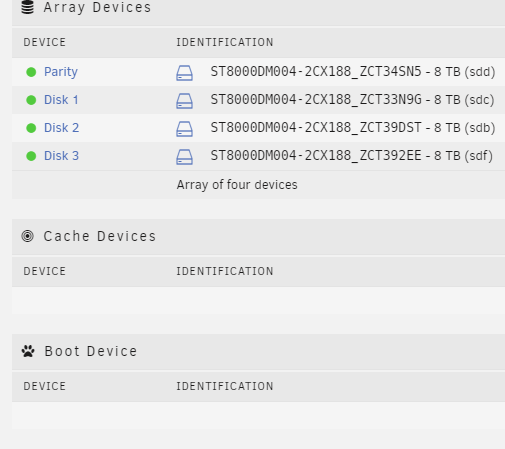

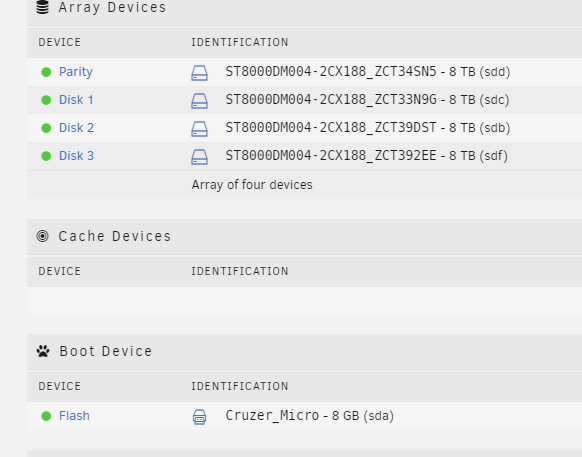

This is where the current issues seemed to begin. After I installed the license I noticed by cache drive missing from the main tab. Reselecting the Main tab refreshed things and then drive groups randomly did not appear. Sometimes the Boot device, sometime the Cache drive, sometimes the array, sometime the Shares on their tab would not appear. Sometimes the Boot device AND the Cache would not appear. I was worried that the video card might be an issue so I pulled the 1050ti and reinstalled the GT 710, no change. I had researched as much as I could but could find nothing that seemed to match my server's symptoms. I gave up for the evening, but left things running.

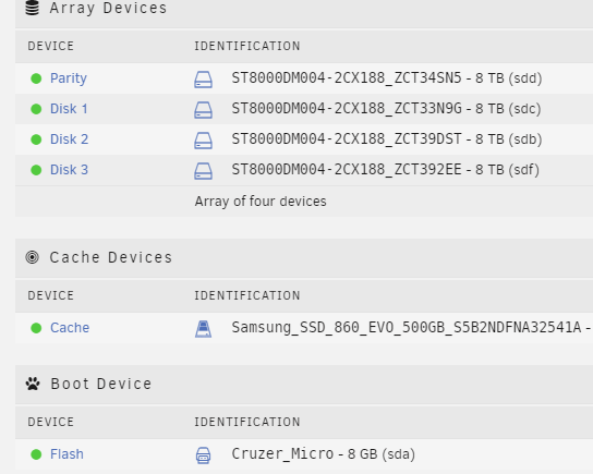

I've also included a couple of screen shots of what I'm seeing at the Main tab. Sometimes everything is there...sometimes not. The clips were taken after successive refreshes.
Jim

That's a GUI problem, cache device is always there, try rebooting in safe mode.

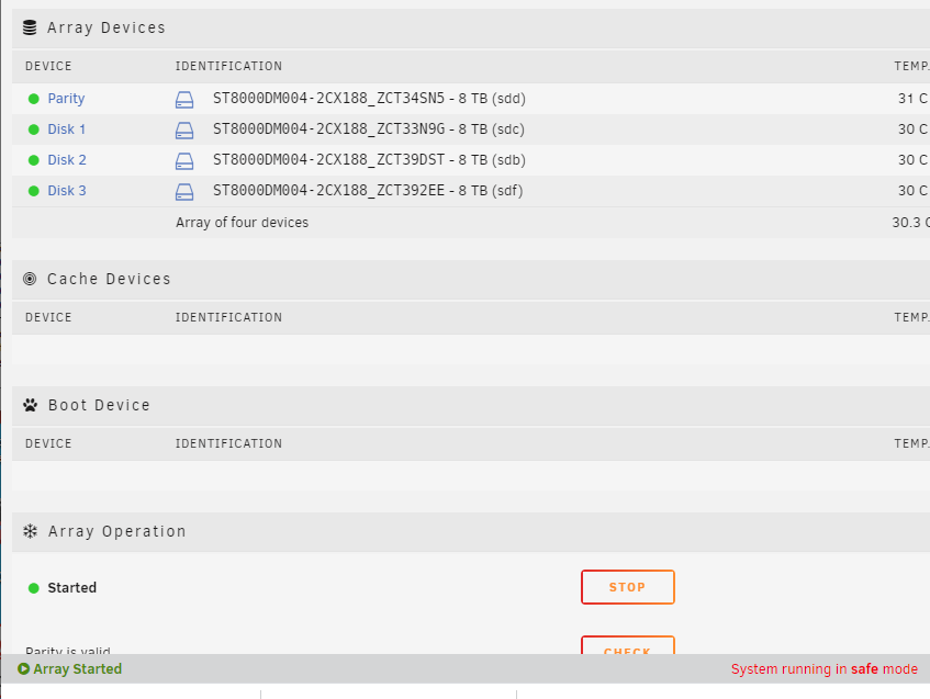

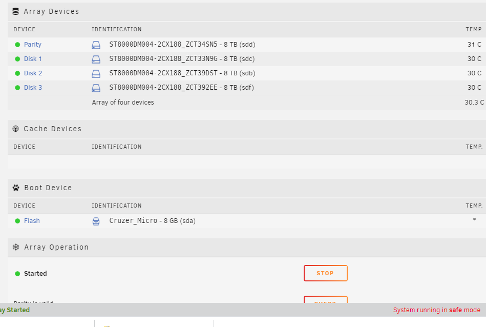

Booted to Unraid OS GUI Safe Mode (no plugins). Same results and same seemingly random docker behavior. Can't access Plex Web UI and while I can get into Home Assistant, I can't access a number of options menus.
I did an additional reboot into safe mode after also telling the dockers to not autostart. Same results. The diag file at 1626 was pulled after that reboot.
phoenix-diagnostics-20210104-1542.zip phoenix-diagnostics-20210104-1626.zip

Do you have adblocker or anything else that might interfere with the Unraid webUI? Have you tried other browsers?
No ad/popup blockers.
However, you know, I suppose everyone overlooks the basics now and again. But dang it!
Cleared the cache and cookies and restarted Chrome. Docker web UI's are fine now.
Still getting random disappearing drives, but as long as the underlying system is running fine I can live with that until 6.9 moves to stable release. Maybe upgrading will knock something loose and fix that too.
