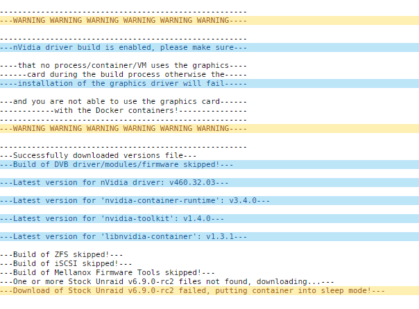

January 23, 20215 yr Hi, Thanks for posting this. I'm trying to pass through my NVIDIA GeForce 1060 to my Windows10 VM and get the following error when starting my VM: "Failed to set iommu for container: Operation not permitted". I downloaded the Unraid-Kernel-Helper and set the RMRR Relax Patch to "True". When viewing the log files, it says "Download of Stock Unraid v6.9.0-rc2 failed, putting container into sleep mode!---". Any suggestions are most appreciated. Edited January 23, 20215 yr by Therapists_For_200
January 23, 20215 yr 9 minutes ago, Therapists_For_200 said: Hi, Thanks for posting this. I'm trying to pass through my NVIDIA GeForce 1060 to my Windows10 VM and get the following error when starting my VM: "Failed to set iommu for container: Operation not permitted". I downloaded the Unraid-Kernel-Helper and set the RMRR Relax Patch to "True". When viewing the log files, it says "Download of Stock Unraid v6.9.0-rc2 failed, putting container into sleep mode!---". Any suggestions are most appreciated. Have you stopped the Unraid-Kernel-Helper once? Please try to delete every file from the 'kernel' directory that is located in your 'appdata' folder. I think the main problem is a failed download and now it can't download the file again.

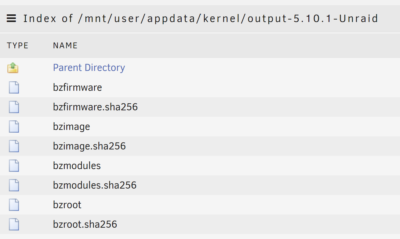

January 23, 20215 yr Thanks for the quick reply. I might have messed it up upon first download. Below is a screenshot of that folder now. Just to confirm, delete these two folders and all their contents?
January 24, 20215 yr 15 hours ago, Therapists_For_200 said: Thanks for the quick reply. I might have messed it up upon first download. Below is a screenshot of that folder now. Just to confirm, delete these two folders and all their contents? Exactly, does the container have exclusive access to the internet (eventually PiHole or something else is blocking the container from accessing certain sites)? From the log that you posted it seems like it can't access the CDN where the Unraid files are hosted (keep in mind that the container needs access to the internet because it downloads, the drivers, Kernel source and other important stuff dependent on what you select in the template).

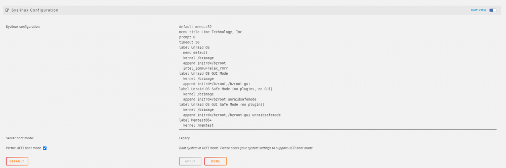

January 27, 20215 yr @ich777, Apologies for the delayed response. The recommendations you made fixed my problem, and I was able to download the files using Unraid-Kernal-Helper. (I temporarily disabled pfblocker inside my pfsense firewall to get it to work). I copied all the files beginning with bz* onto the /boot, and rebooted (see image below) When I type "dmesg | grep 'Intel-IOMMU'" into terminal, I don't get the active patch response (i.e. DMAR: Intel-IOMMU: assuming all RMRRs are relaxable. This can lead to instability or data loss). I'm assuming this indicates I did something wrong? Edited January 27, 20215 yr by Therapists_For_200
January 27, 20215 yr Author 6 hours ago, Therapists_For_200 said: @ich777, Apologies for the delayed response. The recommendations you made fixed my problem, and I was able to download the files using Unraid-Kernal-Helper. (I temporarily disabled pfblocker inside my pfsense firewall to get it to work). I copied all the files beginning with bz* onto the /boot, and rebooted (see image below) When I type "dmesg | grep 'Intel-IOMMU'" into terminal, I don't get the active patch response (i.e. DMAR: Intel-IOMMU: assuming all RMRRs are relaxable. This can lead to instability or data loss). I'm assuming this indicates I did something wrong? Yes. In some step, something is incorrect. Without knowing everything you did and verifying each step, there is no way to know so you will have to try the process again. But I can already see that you didn't follow the steps as written because it says to only copy over the bzimage and bzmodules. That may not matter, but it shows inattention to detail. So now you should roll back to stock unraid, reboot, and start over and follow the steps as written, and then report back. Edited January 27, 20215 yr by 1812

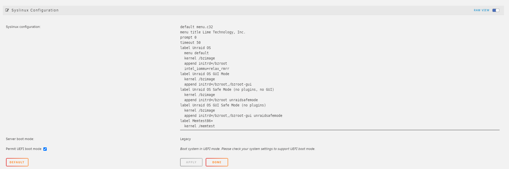

January 27, 20215 yr @1812, Thanks for the reply. Don't mean to be an annoyance and really do appreciate the work both of you have done. I forgot to mention that I did try bzimage, bzimage.sha256, bzmodules and bzmodules.sha256 on my first attempt with the same result. I'm assuming the *.sha256 files should have been excluded, too? Also, I wasn't sure where to paste the "intel_iommurelax_rarr" in syslinux.cfg (or if it matters), so I guessed and added it to the bottom of group "label Unraid OS". Is this the correct placement? I will attempt to roll back to stock unraid using the usb backup I made and try again.
January 27, 20215 yr Community Expert 1 hour ago, Therapists_For_200 said: Also, I wasn't sure where to paste the "intel_iommurelax_rarr" in syslinux.cfg (or if it matters), so I guessed and added it to the bottom of group "label Unraid OS". Is this the correct placement? i would expect it to be added to the ‘append’ line for whichever boot option(s) you are using.
January 27, 20215 yr Author 3 hours ago, Therapists_For_200 said: Also, I wasn't sure where to paste the "intel_iommurelax_rarr" in syslinux.cfg (or if it matters), so I guessed and added it to the bottom of group "label Unraid OS". Is this the correct placement? modified the original post to make it clearer. It should go under menu default

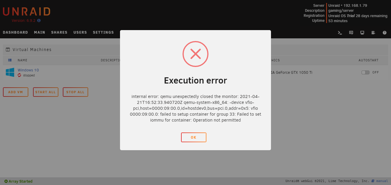

April 21, 20215 yr I believe i did everything right and when i try to passthrough a 1050ti to a w10 vm it still gives the same error, after using this "dmesg | grep 'Intel-IOMMU'" it gives me the right response saying the patch is enabled, but something isnt working, complete noob in unraid, trying to see if this works, if i get it working then i will buy a license. Specs: Hp dl360 g7 2x x5650 64gb ecc ram gtx 1050ti 1 WD black 750gb (Unraid) 1 Samsung 860 evo 500gb (W10 VM) Thanks in advance unraid-diagnostics-20210421-1819.zip
