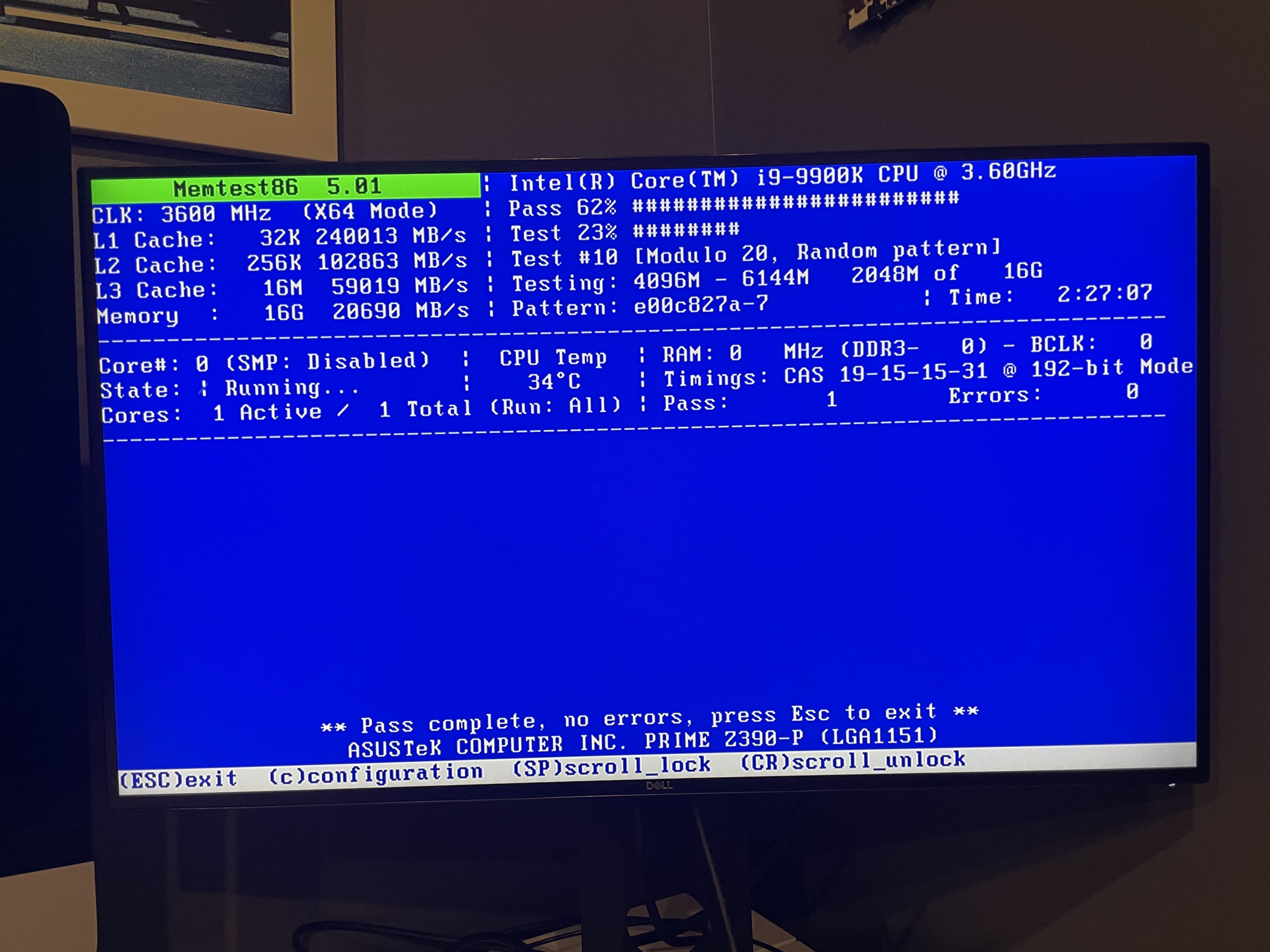

running from built unraid boot menu option now.  i will report back when its done.  thanks.
not done but one pass complete with no errors.
passed twice.  and it crashed again twice in a row within 10 minutes of eachother.  im at a loss.  any other suggestions?
