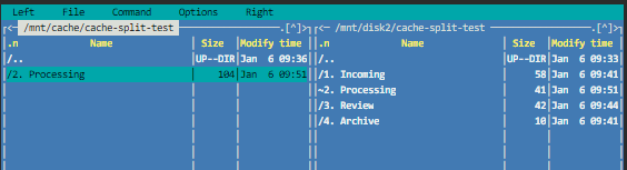

This is how I would approach it:
  1. Create Photography share with cache settings set to "No",
  2. Manually create a folder on the cache i.e. /mnt/cache/Photography/Processing/
  3. Symlink the cache folder to a folder on one of the array disks, in the Photography folder.
New files added to Processing will land on the cache, everything else will land on array.
Please test this thoroughly, however it works as intended for me.
image.png.accb79dc05f64a5e48ed0e444fa07742.png  image.png.7808b623a53635ed028468fe7c10123c.png

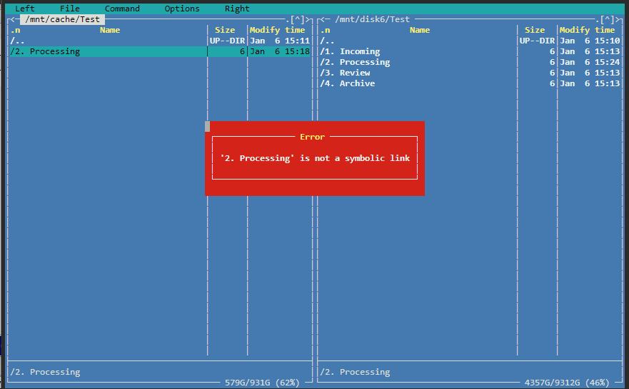

I'm trying what you suggested but I'm guess an error message:
I've tried several different ways in case I was doing it in the wrong order but can't seem to get it to work.

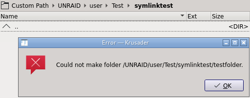

So I was able to create a symlink eventually and the folder structure appears in windows but when I try to copy to it I get an error:
I also get an error if I try to create a folder within that folder using krusader:

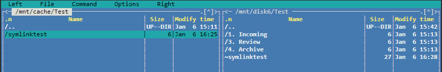

For reference, here are a couple of screenshots from MC of what I did and what the structure looks like.
Any idea why I can't write anything to the symlink folder?
Thanks!
Edited by Conrad Allan
48 minutes ago, Conrad Allan said:
Thanks @tjb_altf4!
The keystrokes you need to do are hold Ctrl, press X, release Ctrl, press S
Holding Ctrl for X+S is a symlink edit shortcut, hence the error.
You should also remove the Processing folder on disk6

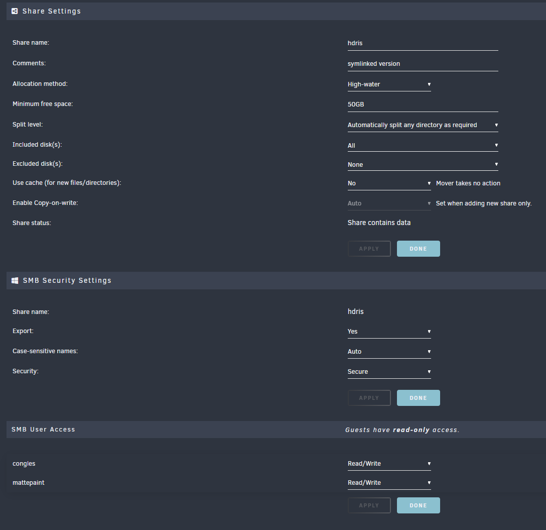

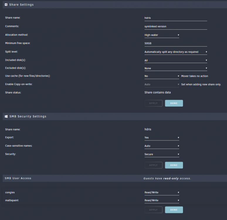

Can you screenshot your (Photography) share settings
Edited by tjb_altf4
Sure, here they are. This is the test share I created which I've been doing all the testing on.
Try resetting the minimum free space (set to 0KB), that is the only difference I can see to my own config that works as you would expect.
Still nothing. I even tried recreating the share just in case but still didn't work.
Should I contact LimeTech support about this potentially? I'm at a loss
