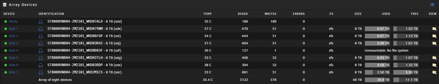

Was working on my unraid server today and it went through a few power cycles. The issue im having is my disk 4 is throwing an error, Unmountable: no file system.

After these steps i'm still having the issue.

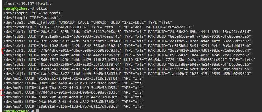

23 minutes ago, MEEXXX said:
XFS (md4): Filesystem has duplicate UUID 77844dfc-e01b-4d6d-b906-66598a67833c - can't mount
This means there's already an fs mounted with the same UUID, please post output of:
blkid
Something is mounting the disk before Unraid:
Jan  7 00:36:52 RyzNas kernel: XFS (sdf1): Mounting V5 Filesystem
Jan  7 00:36:52 RyzNas kernel: XFS (sdf1): Ending clean mount
Also note that because of that parity won't be 100% in sync.
I have a 10TB HDD UD that mounts on boot. It changed from /dev/sdf to /dev/sdb due to using dev names instead of UUID in the boot script.
Thanks @JorgeB
