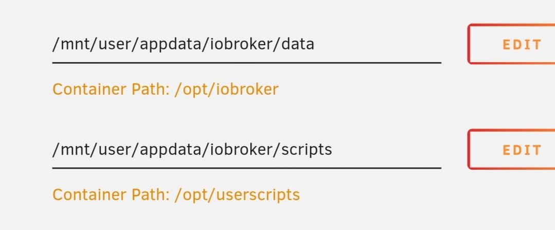

  • Create a script with the following content: #!/bin/bash apt-get update apt-get -y install libpcap-dev   And save it under /mnt/user/appdata/iobroker/scripts/userscript_everystart.sh.

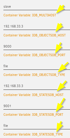

7 hours ago, darkreeper said:
I am not sure if I have set everything correctly:
Your ENVs are not named correctly. Please see here: https://github.com/buanet/ioBroker.docker#environment-variables
Regards,
André
Are you sure? They look correct to me?!
Exactly what I wanted to ask as well [emoji2]
The Pi is set as master. Using the normal procedure with the help of the console is working.
What about the password for connecting the slave to the master? How is this handled with the variables?
I will add the output of the log tomorrow when I am back at my PC.
Gesendet von meinem MI 8 mit Tapatalk
Sorry, my fault. Thought the left is the name of the variable. It has been a long work day. :)
As I do not use the unraid docker interface I'm not familiar with the settings as well.
So if the envs are correct it is not possible to say anything without the startup log.
Regards,
André
Sorry, my fault. Thought the left is the name of the variable. It has been a long work day. [emoji4]
Regards,
André
Strange. Now it is working. Do I have to manually connect before it can be used with the variables?

6 hours ago, Lucas Mietke said:
Leider muss ich für diese lösung jedes mal Iobroker Root Rechte im Docker geben
Nein. Aus meiner Sicht ist das Mist. Der Container ist extra so designed, dass der iobroker nur die Rechte hat die er benötigt. Diesen Maßstab solltest du auch anlegen wenn du selbst am Container Änderungen vornimmst.
MfG,
André
PS: Es gibt m.W. auch Adapter für ioBroker die WOL können. Hast du danach mal gesucht? Das wäre die sauberste Lösung...
