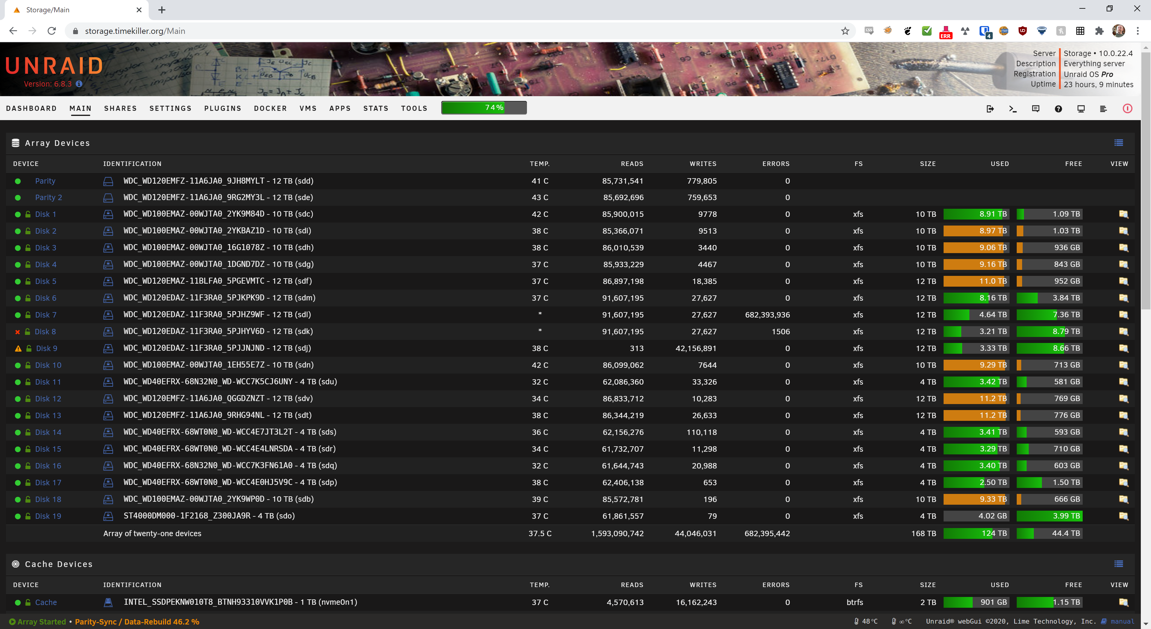

I can't see your Main page, but you should be able to see all of it very clearly in the webUI. The rebuilding / emulated / invalid disk9 is marked by a yellow triangle, the disabled / emulated disk8 is marked by a red X, and all the disks getting errors have nonzero in the Errors column.

thanks @trurl I was dealing with some other (non unraid) stuff. Everything you said makes total sense. Going to shutdown and check cabling now. Fortunately I am backed up. I sync everything to google cloud regularly, and the replaced drives have not been wiped yet, so worst case I can swap them in and create a fresh array and I shouldn't lose anything. Also, yes I can see everything you were talking about on my main screen:
