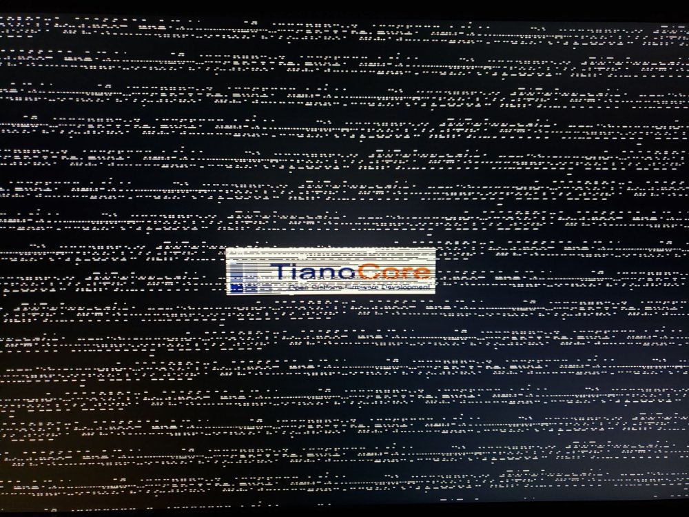

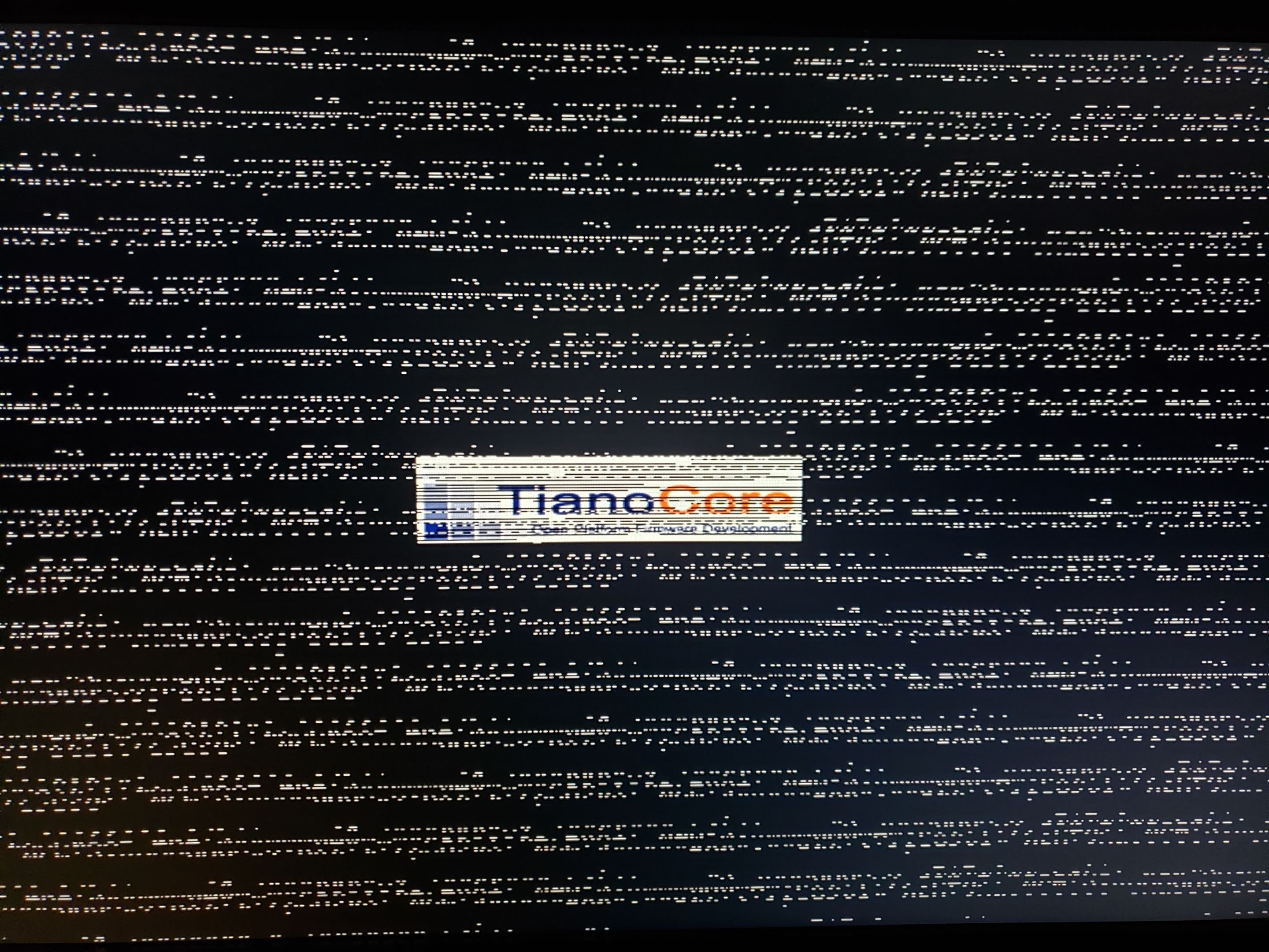

Help With GPU Passthrough after System Upgrade
Unraid 6.9.0-RC2
CPU: Ryzen 7 3700X
Motherboard: ASUS Prime X570-P
RAM: 32GB
Primary GPU: Radeon RX 5600XT
Secondary GPU: NVIDIA GTX 745
VM: WIndows 10
I recently upgraded to a Ryzen 7 3700X, which included a motherboard upgrade (ASUS Prime X570-P) and a RAM upgrade. The upgrade seemed to go without any problems, however I am no longer able to start my Windows 10 VM with a gpu passed through. I have a RX 5600XT that I passthrough and an old NVIDIA gpu I use for transcoding. I am aware of the reset bug present in 5600XT, but this seems to be a separate issue since now when I start  the windows 10 vm I see the TianoCore boot screen, then nothing happens for a while, then white pixels appear all over the screen.
I checked IOMMU groups since upgrading and the GPU is in it own group and have tried to run the VM with only the GPU passed through with no luck. I have a vBios I dumped from the card added. I have attached diagnostics from a fresh reboot and running the VM once until the pixelation occurred, then forced stopped it after that.
Passing through the NVIDIA GPU works without issue so it seems to be specific to the 5600XT. I came from an intel CPU which had a iGPU so it may have to do with the 5600XT being the primary gpu.
If there is any additional information needed let me known. Before upgrading the hardware everything was working perfectly so I'm really at a loss as to what else I should try.

nateserver-diagnostics-20210106-1711.zip
Edited by ndetar

My hunch was based on the video corruption, so my next guess would involve the video BIOS you dumped. What happens if you start the VM without the vbios specified?
The same thing. I think the video corruption might actually be incorrectly displayed console text, but i'm not completly sure. I recently noticed that if I hit enter or type the pixelation shifts.
Additionally the last time I rebooted the pixelation started shift up the screen like it was just incorrectly rendering the console reboot text.
