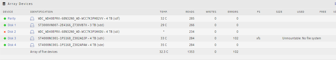

I have two problems as listed in the title. For some reason I can't get the public image uploaders to work for my screenshot to show you. So I'll just say Disk 2 is disabled, and disk 3 us the unmountable: no file system. I don't really know when this all started happening. I am not a Linux guy. Just getting this box to work with Sonarr/NZBGet/Plex and all that comes with operating that via the helpful guides of SPACEINVADERONE was easily over 40 hours of work for me.
What are my first steps into correcting this problem? I stopped the array, started it in maintenance mode, and have clicked on extended SMART test for the disk 3 so far. However it's comfortably sitting at 10% and don't see this being done tonight or maybe even tomorrow. I've searched a bit about these issues, but they seem very specific for the problems that each person is having. I'll be happy to do all the legwork that is asked of me if I can get some help from here.

47 minutes ago, AustinTylerDean said:
since I have disk 2 disabled, I am worried that I will mess something up by trying to put the array online without disk 2 fixed first.
The only way to fix the disabled disk is to rebuild it. It won't hurt anything to start the array with it disabled. It won't even use the disabled disk. It is emulated from the parity calculation.
We can work on the rebuild before or after you fix the unmountable disk. Might be better to go ahead and get the array protected again first by rebuilding disk2.
SMART for those disks look OK.
Looks like disk3 was already unmountable before you booted up, but it looks like it may be having connection problems. I assume disk2 was already disabled before you booted up too since I don't see any errors on it. If it weren't already disabled possibly it would show connections problems too.
Shut down, check all connections, power and SATA, including splitters. Then reboot, post new diagnostics and a screenshot.

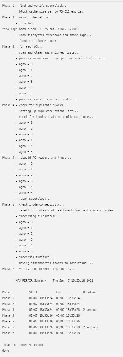

1 minute ago, AustinTylerDean said:
I ran it both with -v /dev/md3 in terminal, and in the GUI as just -v. I didn't see any difference.
Did you do that after I mentioned the nomodify flag? What was the output from running it without -n?

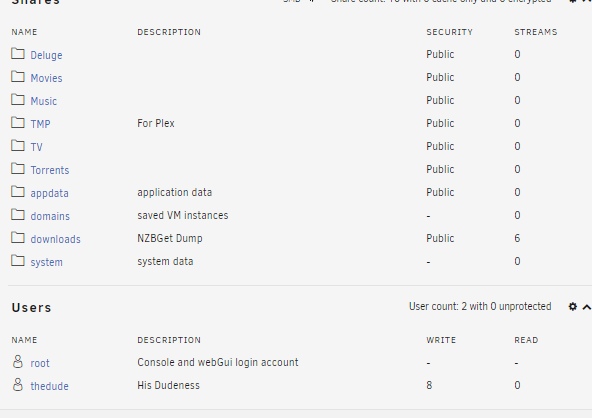

Did anything get put in lost+found? (you would have a new user share by that name).
I don't see any shares present. Would this only show up if I had the array started?
Yes you have to start the array in normal mode to see any of your shares or files. And hopefully that repaired disk3 will be mountable now.
I started the array! It doesn't look like I have any shares that were added. Disk 3 looks normal. Disk 2 is obviously still disabled. AND I also see that I have a SMART error on my parity disk now. Both screenshots attached. What is my next step? Getting after the disk 2?

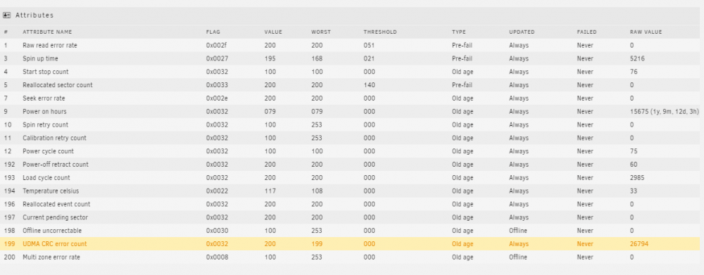

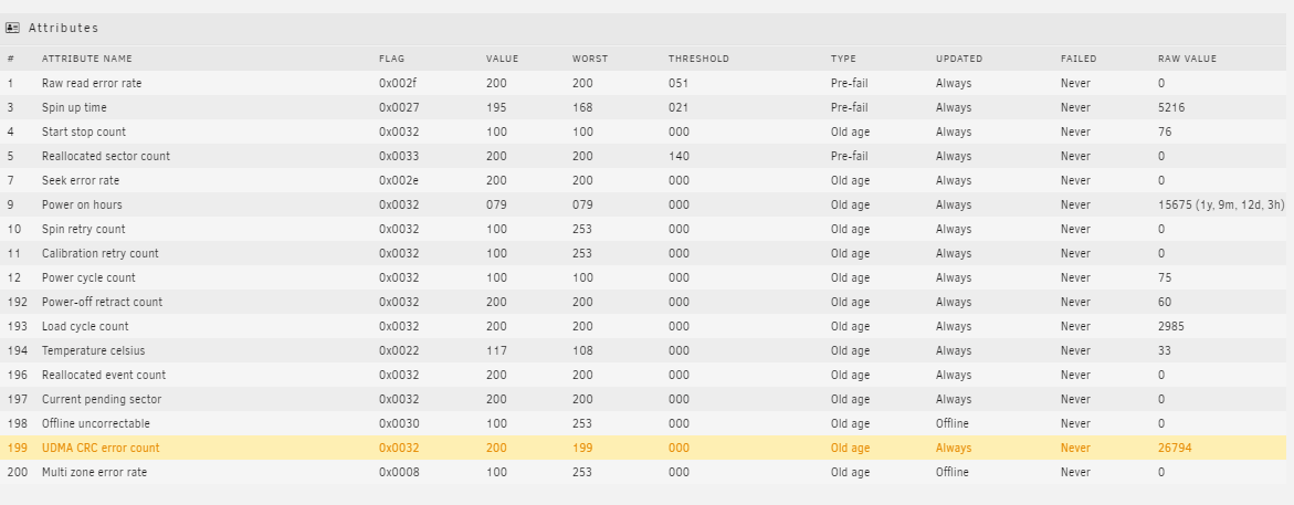

I feel like I am having a bunch of these UDMA CRC error counts happen every once in awhile.

5 minutes ago, AustinTylerDean said:
UDMA CRC error
These are connection problems counted by the disk and not a problem with the disk itself. Many connection problems the disk won't even count since it can't know about them when it is disconnected.
You can acknowledge the current count by clicking on the SMART warning on the Dashboard page and it will warn you again if it increases. That is a lot of them though.

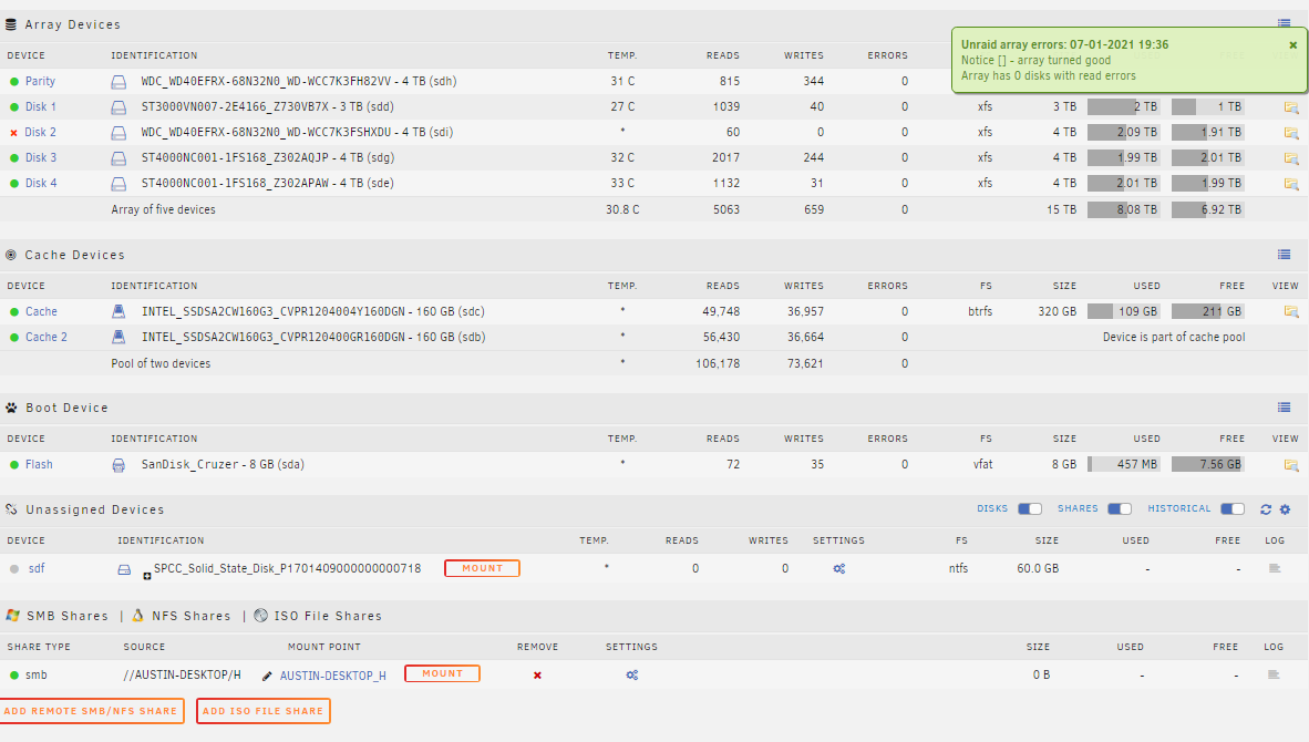

Alright! So before this last check and reboot, the message that stated the parity was invalid was the floating status box which came up in red. NOW I get a much better status box that states the "array turned good". This is much pleasant. My fingers are crossed that we are good to this point! Trurl, I can't thank you enough for your time and expertise!

All disks are mounted, including the emulated disk2. The emulated data is exactly what will be rebuilt so it looks pretty good.
To rebuild to the same disk
  1. Stop array
  2. Unassign disk
  3. Start array with disk unassigned
  4. Stop array
  5. Reassign disk
  6. Start array to begin rebuild
During rebuild, you should see lots of Writes to the rebuilding disk, lots of Reads of all other disks, and zeros in the Errors for all disks.
I would estimate 4TB to take 8-12 hours. Using the array during that time won't break anything, but it will make everything go slower.
