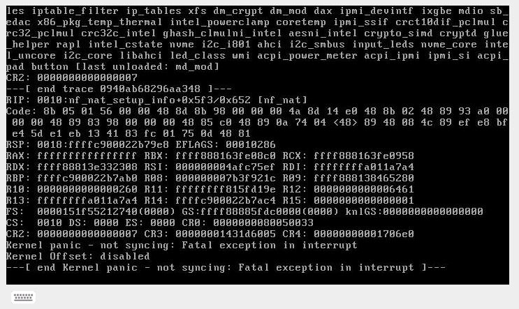

Crash tonight: end kernel panic - not syncing: Fatal exception in interrupt
I noticed my server was not responding. I went in via IPMI and saw this so I rebooted. The GUI is up and I'm logged in. This is freaking me out. I rebooted and when I started the array I got this message, But the NVME Cache drive seemed to mount ok.
Any Idea what caused this? Really appreciate some help.
Should my next step be a MemTest?

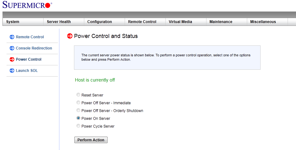

Thanks Jorge. When it crashes does it risk the data on the disks? Or does it gracefully shut them down? Is there something I can do to make sure the disks are stopped properly when I reboot? I get the option to "Power off - Orderly Shutdown" with my motherboard BMS
