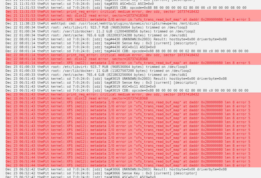

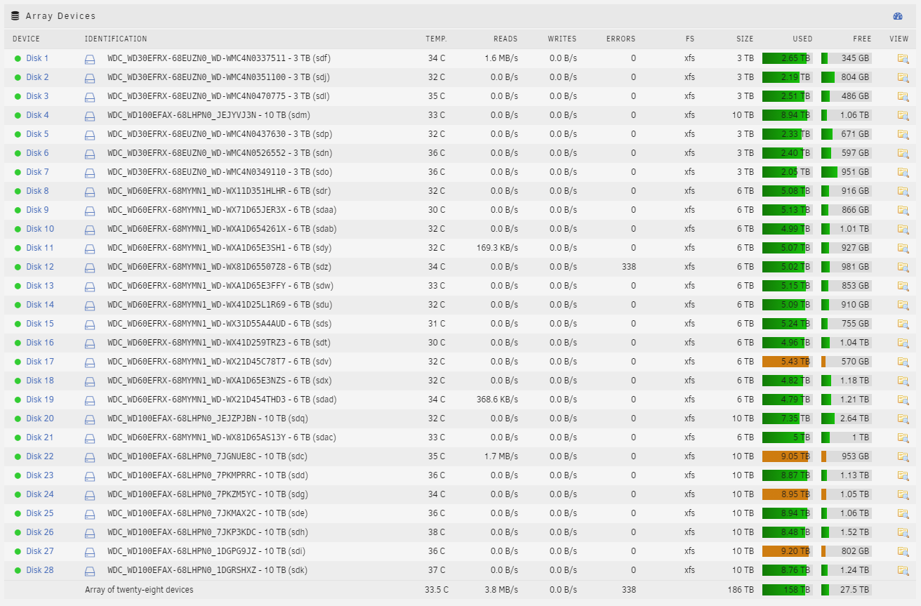

I checked the unraid webui and saw that disk12 had 32 errors. I checked the syslog and found that disk12 had XFS errors.

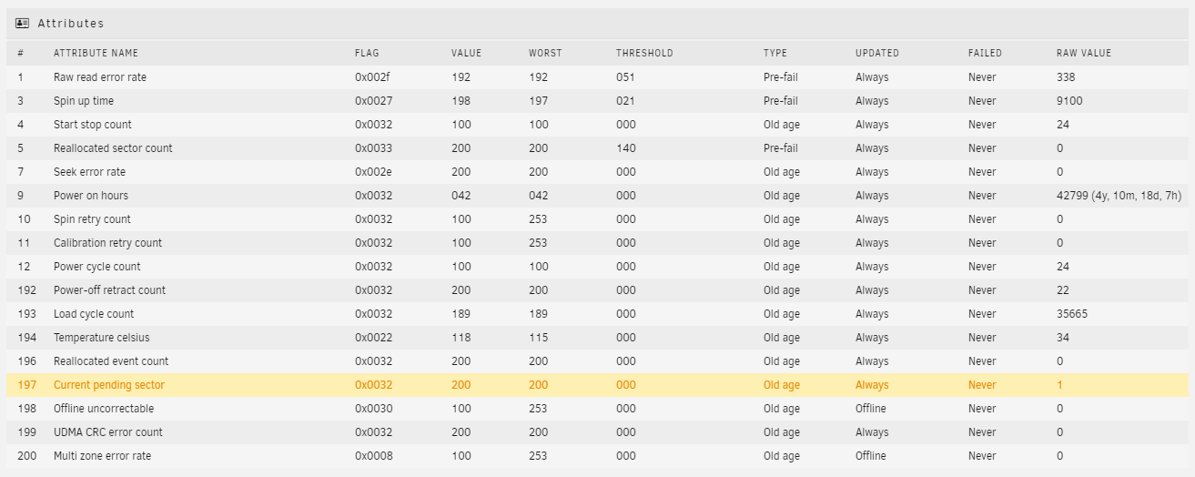

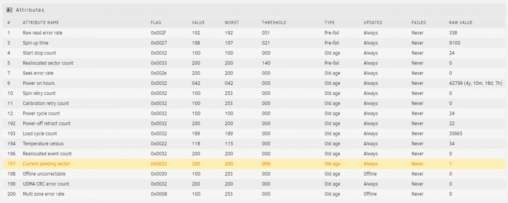

Without parity best bet is to use ddrescue, after the clone run a filesystem check.
Note that for the clone to mount in Unraid it needs to be the same size, if you use a larger disk you can still mount with UD.

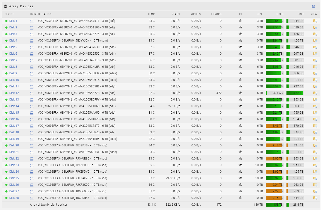

Interesting - the drive should be completely empty, as the only thing left is that borked folder, which shows up empty over network. But unRAID webUI shows drive is still using 321 GB, which is actually the size of that borked folder, ie: the size of all teh files inside that folder, that are now gone... 🤔
Does this mean, that unRAID somehow sees the actual files?

A screenshot - notice the 321 GB used by the ghost files on disk12 👀

There's filesystem corruption on disk12, but it might not be fixable on a failing disk, hence why I suggested ddrescue.
