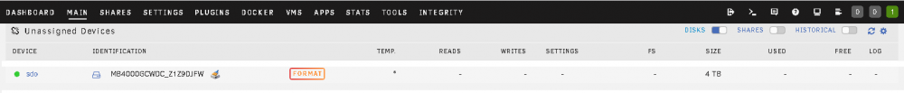

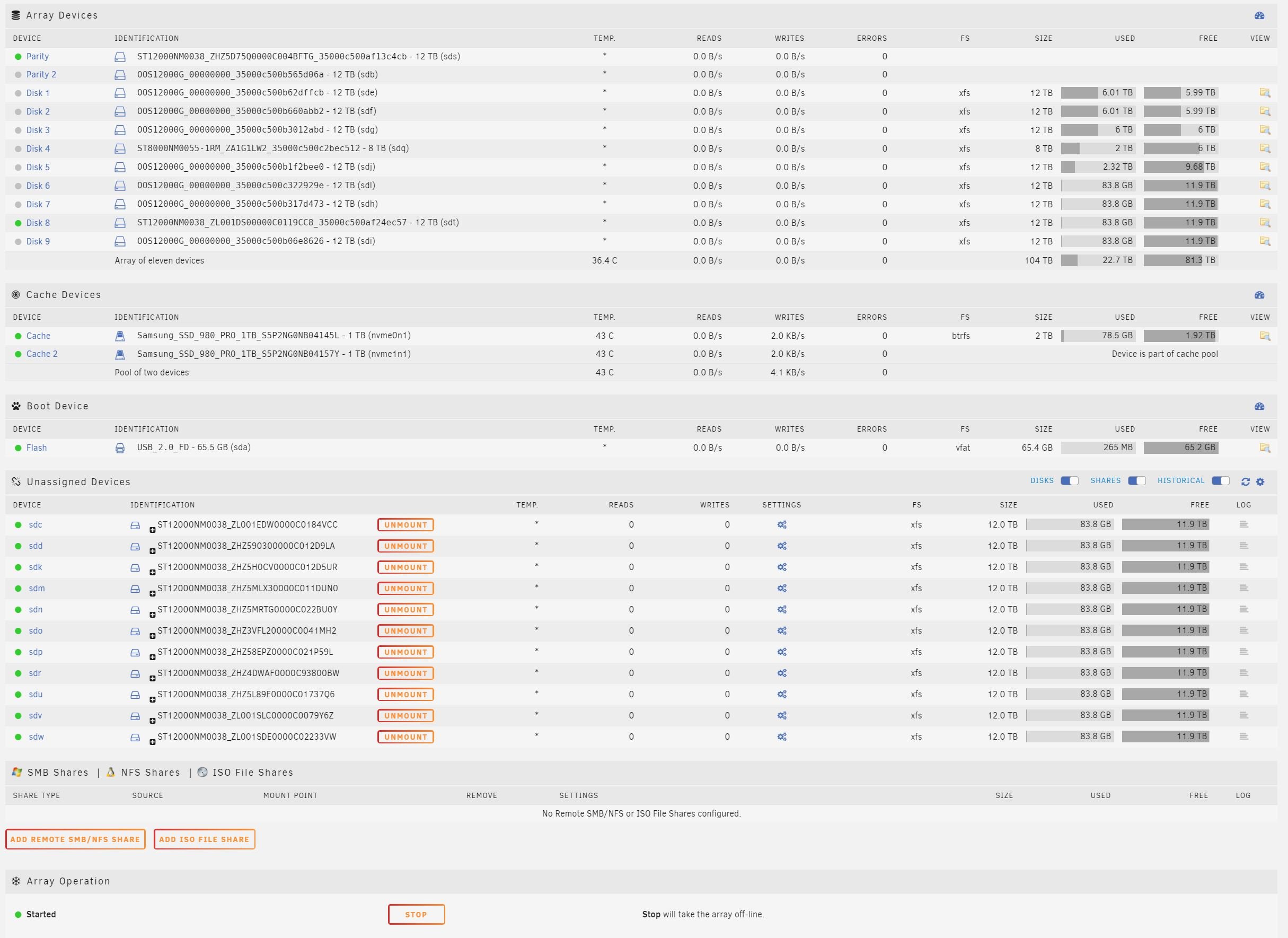

Ok, well, i had a moment so i thought i would remote in to start this. And the first issue I have found is the "format" option is greyed out on all of the unassigned drives. I have installed everything you have requested as well as rebooted the system. All the drives show up, just the format option is grey and unclickable. Both when the array is up and down.
Either UD+ isn't installed, or destructive mode hasn't been enabled in UD settings.

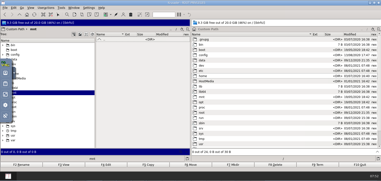

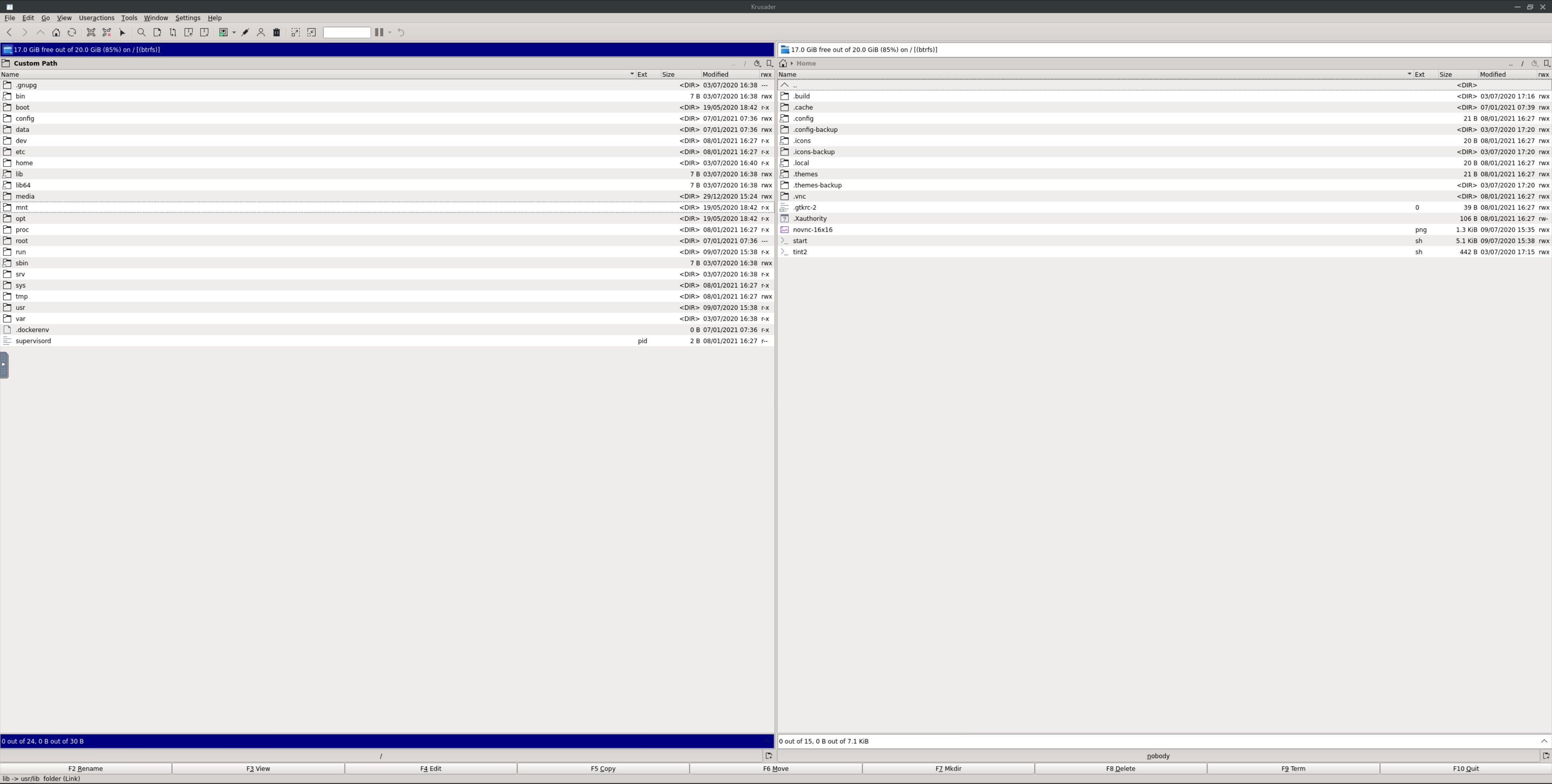

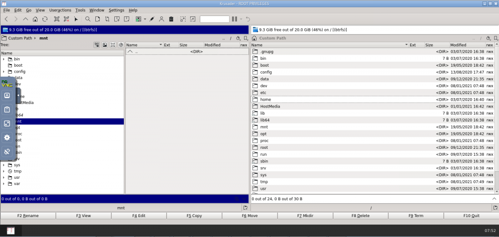

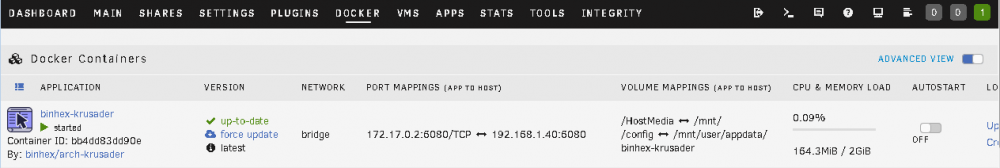

I am home now, and that was correct thank you. "destructive mode" was not on thank you!  I have however reached a new issue.  'HostMedia' does not seem to be present in my system. I did however go into each folder looking for 'driveX' and did not see that either. Maybe I set unraid up wrong? I have included pictures of krusader and my 'Main' tab for inspection.
Capture.thumb.JPG.5dccebee723a5c72bd221122c059c40f.JPGCapture2.thumb.JPG.096a28146d63717773b4dc30f3bd9947.JPG

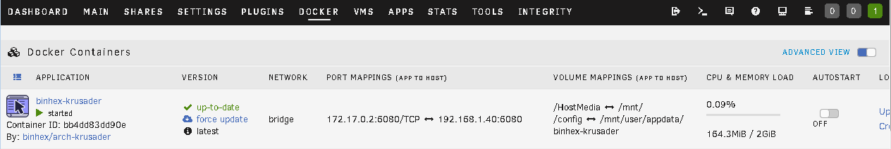

Look in the docker tab, for Krusader, and see what the volume mappings are.
If you edit the container, mine says:

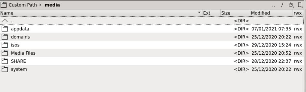

Here is the information you requested. I looked in the '/media' folder and did not see the drives in their as well. Included is a picture of that folder.
Capture4.thumb.JPG.abc6f9d2d596ae14d95bb96cbf7f4de7.JPGCapture5.thumb.JPG.771a9fe99a2322a13ba16f93f2c7c155.JPG
