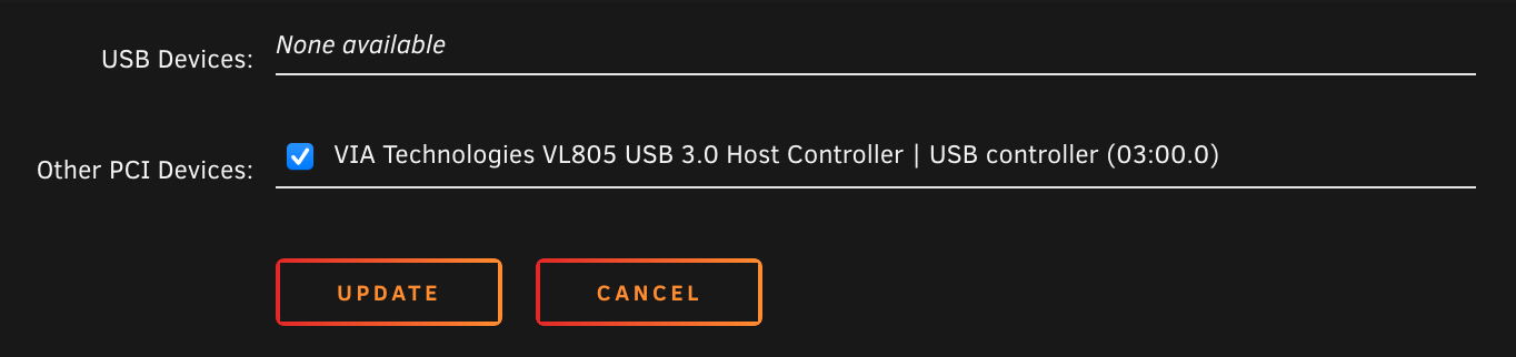

Hey! Can you help me figure out why my USB PCIE connection drops when my MacOS VM boots?
1. Starting my High Sierra VM successfully with USB PCIE passthrough
2. Selecting boot drive successfully with keyboard attached to PCIE device.
3. MacOS boots, the keyboard and mouse gets disconnected.
What's going on here? The keyboard seems to work fine when selecting the boot drive but somehow gets disconnected upon boot...
Edited by cagemaster
