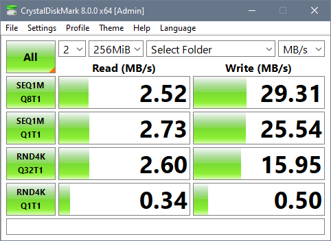

I am currently getting read speeds that don't exceed 3.5 MB/s, and are typically around 2 MB/s when copying files off the array to my other computers.  I am getting write speeds to the array around 25-30MB/s (as shown in the CrystalDiskMark image attached).  From reading other posts on the forum about slow read speeds it would appear that this slow of read speeds are not typical.  I have tried suggestions that others noted as solving their read speed issues, including

To test if this was a hardware limitation, I booted the hardware with the old windows 10 pro boot drive I took out of the computer.  From a shared windows folder I was able to get read speeds of over 40MB/s and write speeds in the 25-30MB/s range.  This leads me to believe there is a setting in unraid, or a driver issue with one of my devices and unraid.
Attached diagnostics files cover the time span of a 750 MB copy of photos from the array to one of my other computers.
