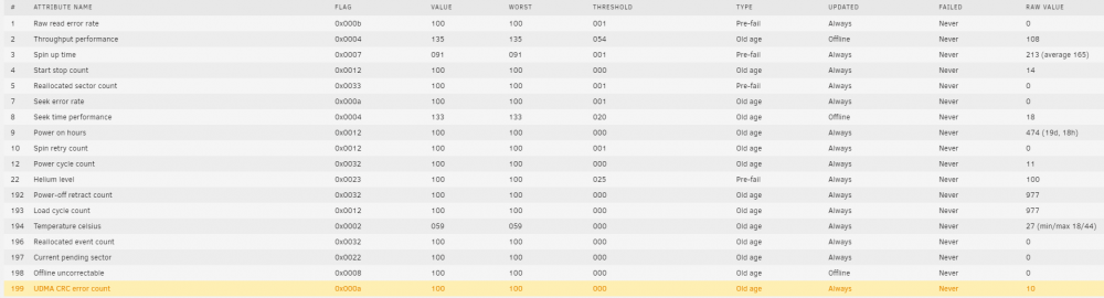

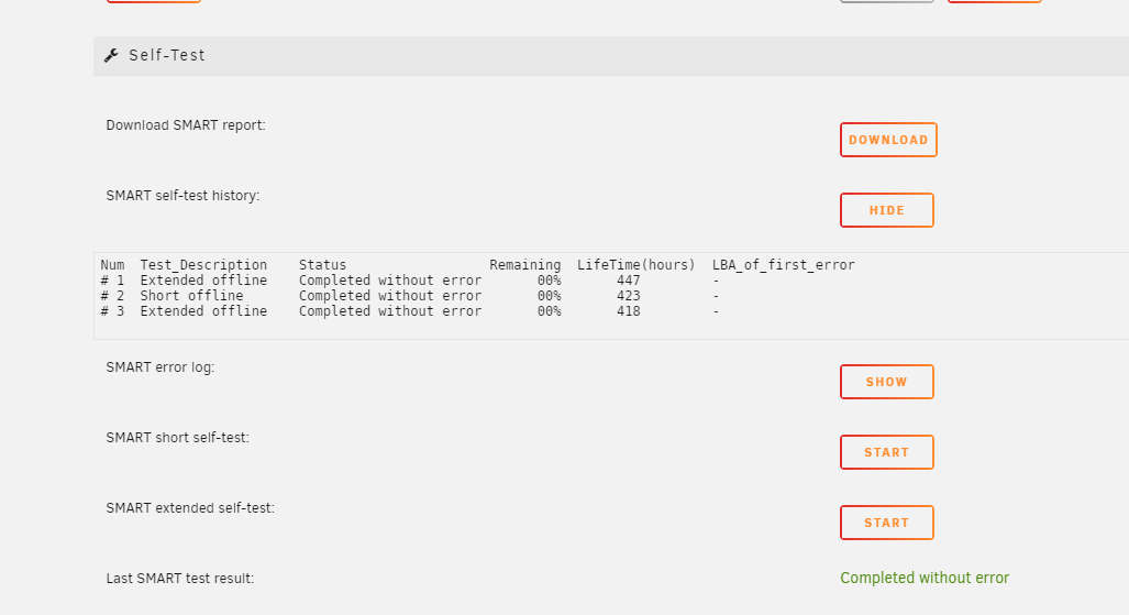

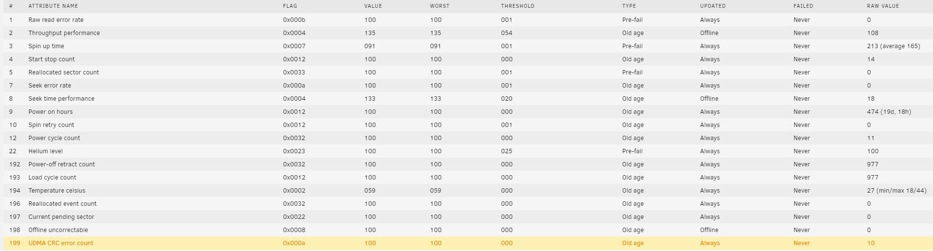

I recently decided to bump my parity drive from 10 to 12tb. This time around I decided to preclear the drive to be safe. The whole process took 4 days and concluded successfully.  I then stopped the array > unassigned 10tb > assigned 12tb > started the array. A day and a few hours later the process is complete so I go ahead and use the old 10tb parity to replace a 4tb drive in the array. Same dance as before the process completes everything is ok. A few hours later I come back to my windows VM and its frozen, I look at unraid and the parity is offline and the drive reports a bunch of errors:
Restarted the server a couple of times after running smart checks on the drive: image.thumb.png.8554e92d17e18617cd8e11c508afc78f.png
I'm not sure where to go from here, do I have to rebuild  my parity once again before unraid will use the drive?

Thank you! by the way, is there any place where I can find out what went wrong. I'm still confused by the whole bit. Can I still trust the drive?
UDMA CRC errors are a connection issue, usually the SATA cable, start by replacing that, note that the errors don't reset, but as long as they don't keep increasing it's solved.
But you can click on the SMART warning on the Dashboard page to acknowledge the current count, and it will warn you again if it increases.
Thank you guys for the information! I will go ahead and change that sata cable (I had another drive there before that also gave me errors I will test said drive in case it was a cable issue causing those errors too, as they are from like 7 years ago). I will back as soon as the drive is back online to update you guys and the post.
