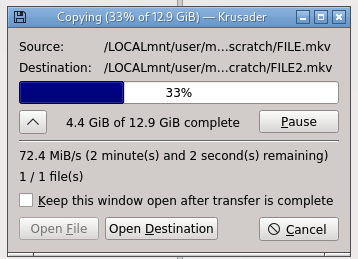

Test 1 - copy file /mnt/user/media/testfolder1/test.file ---> /mnt/user/media/testfolder2/test.file
Result- 60-70MBps

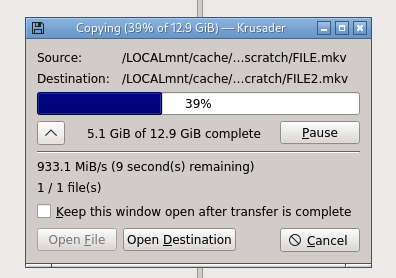

Test 2 - copy file from /mnt/cache/media/testfolder1/test.file ---> /mnt/cache/media/testfolder2/test.file
Results - 990MBps

 246696442_ScreenShot2021-01-11at2_41_56PM.png.dfdd622020abd881326acc4e18d681d2.png996621549_ScreenShot2021-01-11at2_24_29PM.png.5b0b139d78ed49b2469ce9a357957cc9.png

The transfers in the image there is immediately following each other and I can do the cache -> cache transfers over and over and over with no slowness. I've transferred a few 100GB worth of data off/on the cache as well as duplicated files already contained on the cache and as long I do that from within /mnt/cache its near 1GB speeds.
