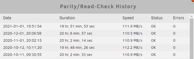

I've had a good parity history, and run at the beginning of every month:
So I had a good parity check about 10 days ago.

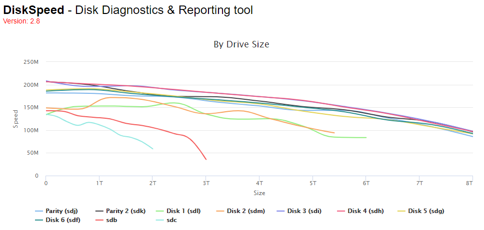

Ok so I downloaded and ran Diskspeed yesterday, and have been running it a few times with mixed results:
Unfortunately, 2 of my disks are slower, but these are the 2x 6TB disks that I'm replacing... so no surprise there.

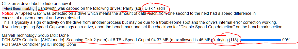

What is surprising, however, seems to be that one of the 6TB disks (Disk1/sdl) is bandwidth capped, and the other (Disk2/sdm) is causing issues finishing the tests, and seems to be retrying with Speed Gap errors every time I ran it:
Interestingly, I never knew about this Diskspeed tool but it's interesting and has definitely confirmed my suspicions about these 6TB drives, being that they are (1) slowing down operations and (2) are proving a bit inconsistent alongside the newer 8TB drives.
If anyone hasn't done so, I'd recommend checking out the Hard Drive Database associated with the Diskspeed tool to see how results of drives with the same model number perform. I assume that the Diskspeed tool uploads test results to this database.
So at this point, looks like a good idea to get these guys out of there.

The bandwidth capped means that the drive is likely outputting data faster than the system can utilize it and is represented by a flat'ish line for a portion of the graph.
Question - when you were getting the Speed Gap errors, was the max allowed size increasing? It's supposed to increase every time it retries to eventually pass but here it doesn't look like it was doing that.
Is that the data in the other graph? That was somewhat linear like this graph, but seemed to have got stuck retrying at 90%. I'm not sure if you're referring to that.

However, I'm still not sure of your question regarding the "Max allowed size", I think you mean the threshold of measured throughput, but I don't know where I can see or verify this. It didn't seem to be increasing above 45MB. I also tried running the same test with "Disable Speed Gap detection" enabled, and it still would not finish the test.

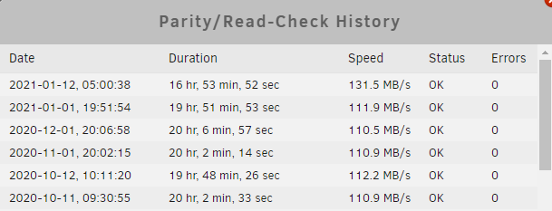

So once the parity rebuild finished, looks like it was a little faster overall, despite the system being under normal load:

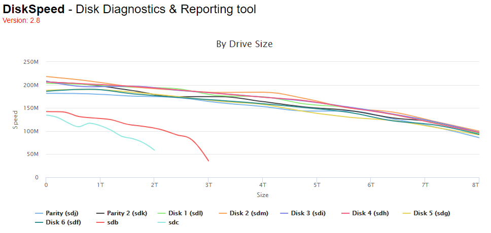

Ran the Diskspeed test again (The test finished this time):
The results look a lot more pleasing, with all the drives performing quite well together.
Interestingly, there was a still a bandwidth cap on Parity1 and (the now new) Disk1:
I'm not sure what to do with this result as yet, but it looks like the system is at least behaving normally.

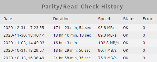

My backup Unraid server is also an aging system on PCIE2.0, that I'm planning to soon decommission, but I still get 95.8MB/sec on Parity-Checks:
I'm not using 16TB disks in my backup system, of course, but it'll be a little faster than 95.8MB/sec when I swap in my currently free 6TB disks in there.
In comparison, I have no idea what you're dealing with that would take that long.
You're using disks twice the size of my primary Unraid, but sounds like more than double the time:
You should post some meaningful numbers, like Parity-Check History and Diskspeed tests, if you want opinions.
