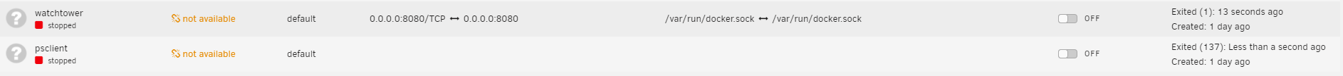

Anyone recognize these Dockers?
I am really new to Unraid. Just about done getting everything set up for the first time. I noticed a few dockers I did not install.
Dose anyone recognize these? If so what do they do, can I uninstall them or keep them off?
watchtower
psclient

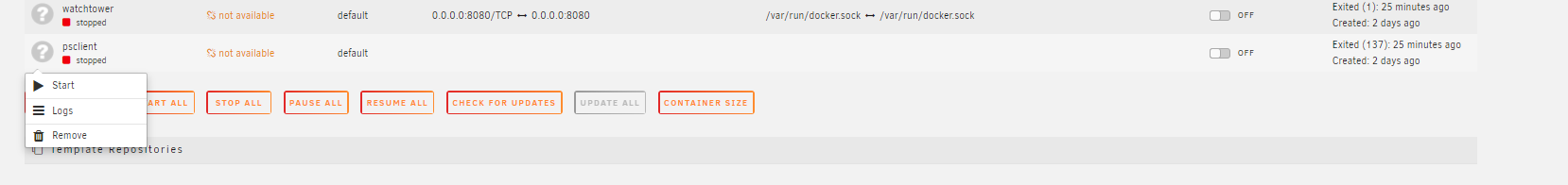

It appears the watchtower and psclient AutoStart every time the array is started even with it off.
If I click on them there is no information such as support
I did locate "watchtower" on the apps page however It is not installed though apps.
Still can not locate anything with "psclient "

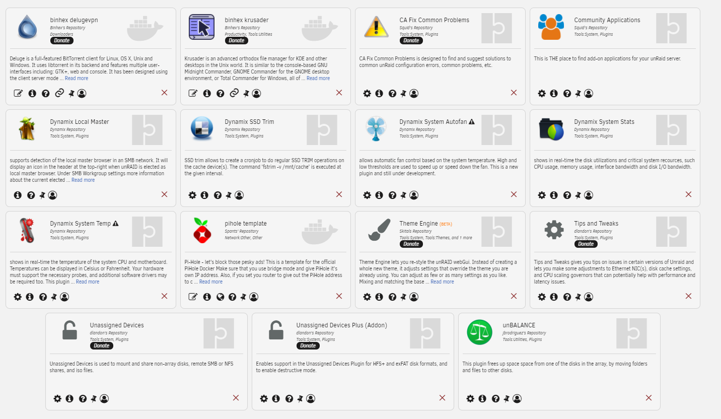

I have attached screenshot of all my installed apps

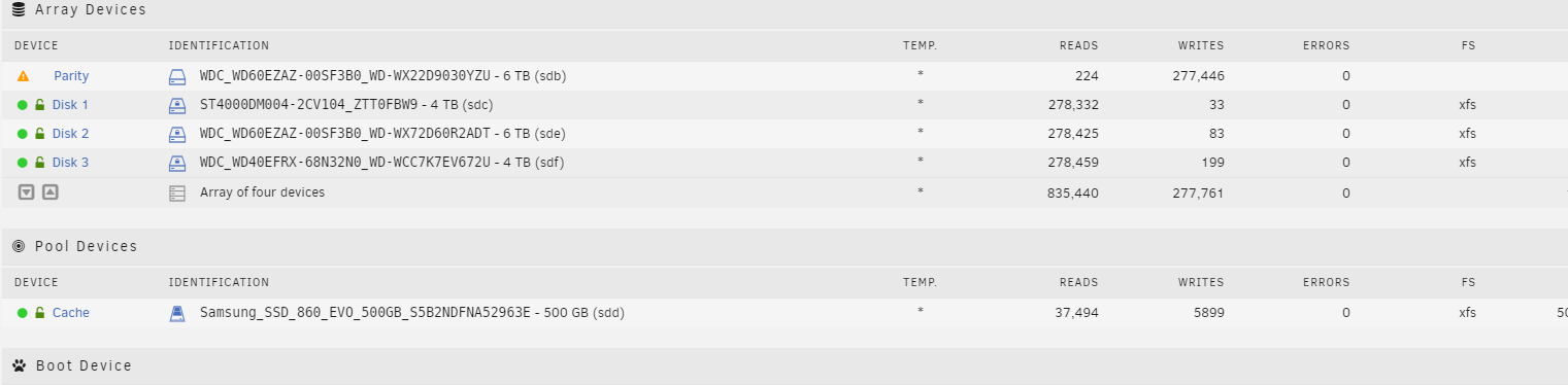

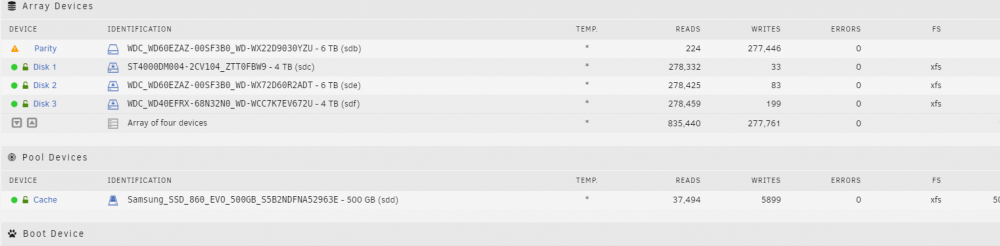

I have how the array currently setup attached below. Let me know if this is correct (The SSD was more of a test).
