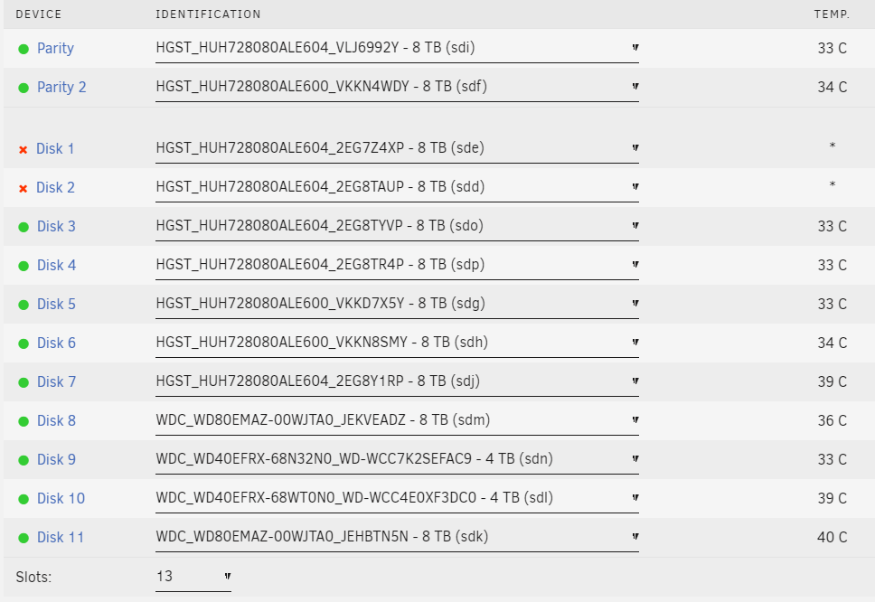

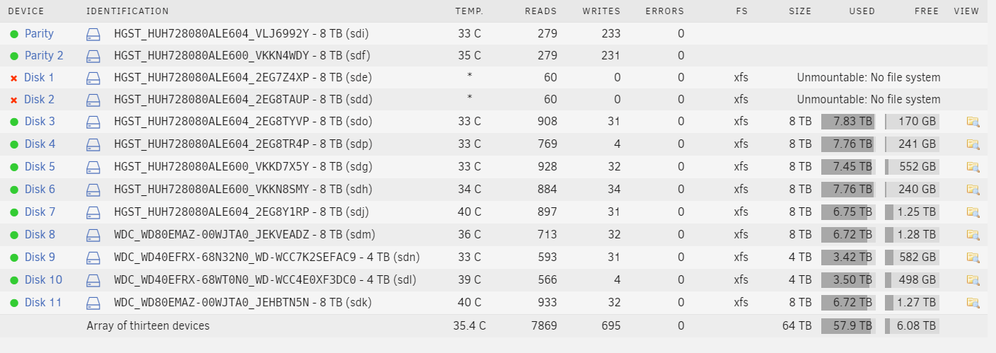

Hey guys.. looks like i had two drives go dark.  Both show "Unmountable: No file system".  Hovering over the "x" shows "Device is disabled. Contents Emulated".  There is no mount points for disk1 and disk2 and no browse icon to the right.  If it's emulated, should i still be able to browse like it's available?
I tried the xfs_repair -n on disk1, it shows an issue, so i ran w/o the -n and it ran for at least half an hour, (it didn't say I needed to use -L) finding all kinds of issues and reporting read/write failures. It finally said "done" but still would not mount.  It also doesn't even report temperature.
Not sure what the best step is next.  Should I just disconnect the drive and assign a new drive and see if it rebuilds?  Or should I first just unassign it and start the array and see if it shows me the emulated data?
I've attached the diagnostics and a couple of screenshots.  Let me know if anything else is needed.

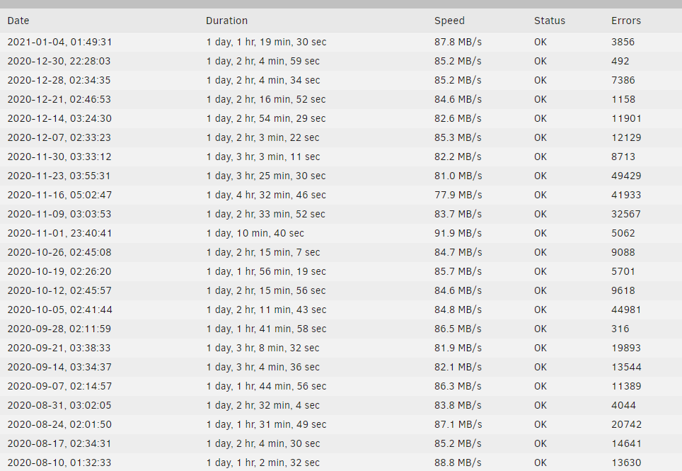

umm.. apparently, i've been pretty neglegent.   Looks like July 20 was the last one with 0 errors.  :/  I thought I had notifications setup to send me emails.  I haven't looked at the dashboard in ages until suddenly the array was offline the other day.
