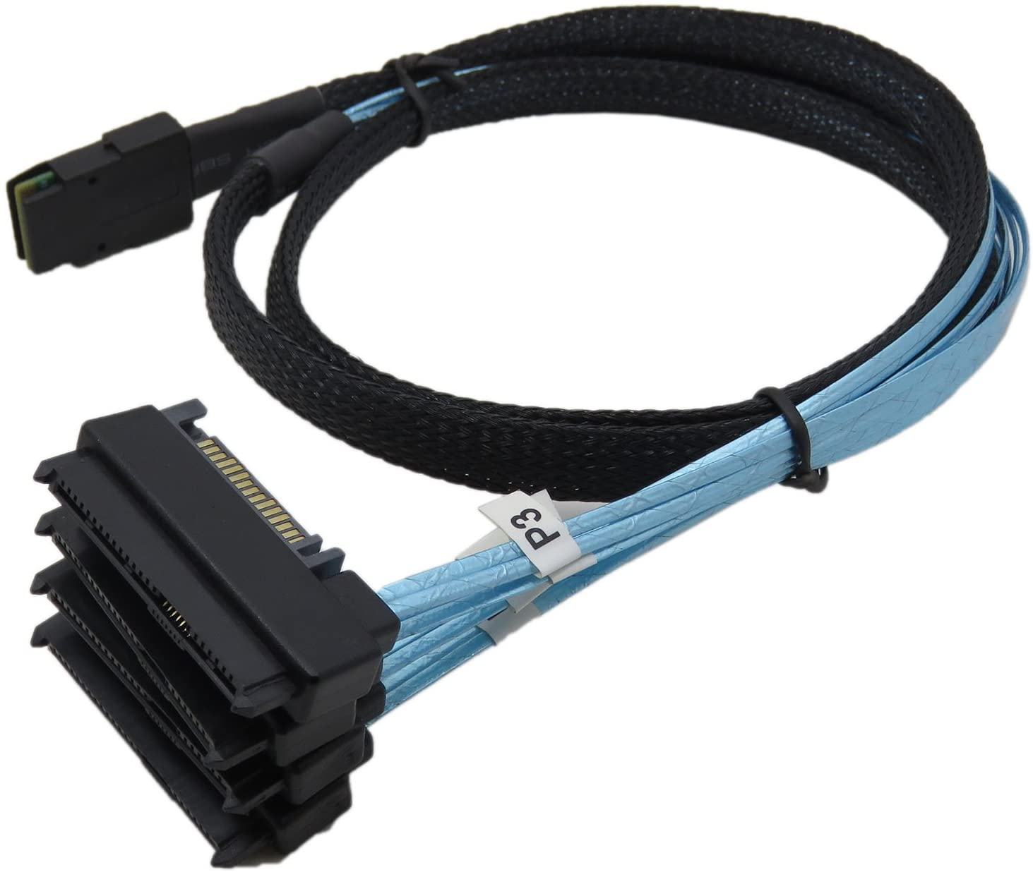

Thanks,  will this work with any sas controller and is there any recommended for unraid or will any do ?
Any will do but the other end depends on the controller, e.g. sff-8087 is usually used for SAS2 controllers, sff-8643 for SAS3.
Thanks , found the cable , I'll have a look for controllers and give it a go.
