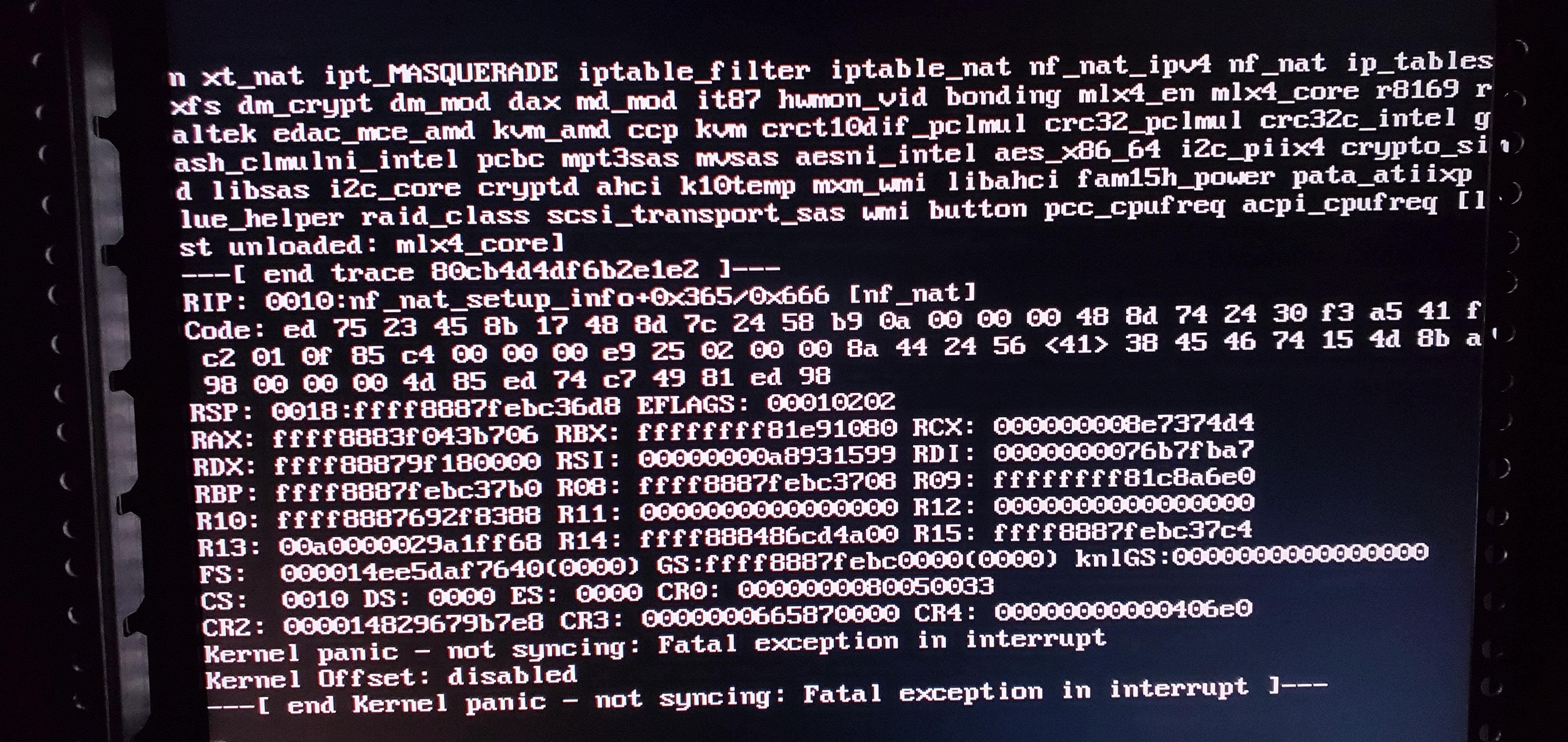

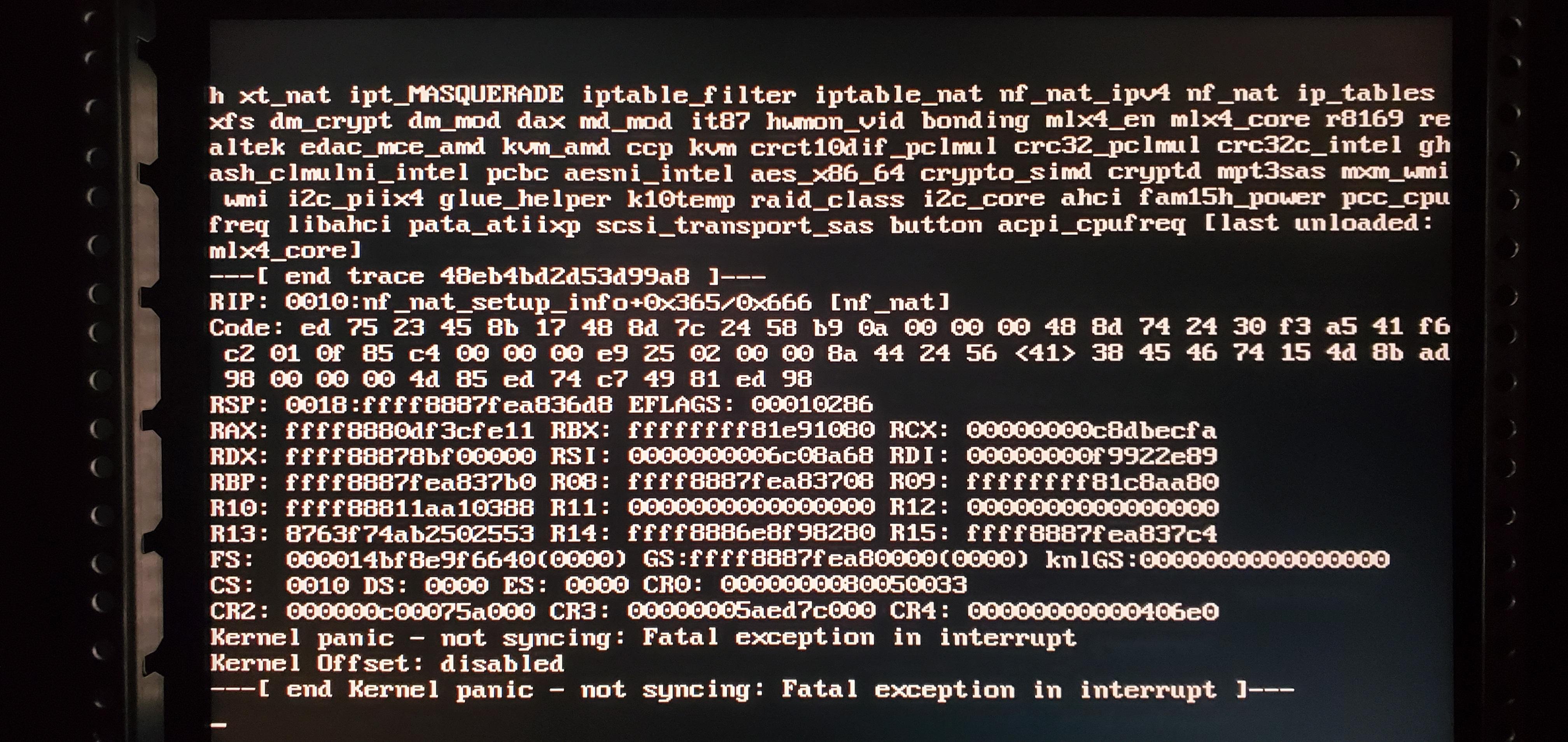

This has been a reoccurring issue where Unraid crashes several times a week.  The server is non responsive and the console has a crash report on the screen with the major error being a kernal panic, see pictures below.  I took 2 pictures from two different crashes.  I read through the posts here concerning other Kernel panic issues.  Step I have tried so far:
1. did mem86 test (the latest one from the website not the one on unraid boot) no issue
2. check the memory speed.  Actually the memory is rated for 2133 mHz but the auto select in bio down clocked to 1600.  I tried to set to 2133 but wouldn't even boot.
3. all other overclocking is disabled just put everything to auto detect
4. brand new powersupply so i'm not suspecting anything strange there.
Here are the syslogs, they are after 2 reboots so not sure how helpful they are.
tower-syslog-20210112-2124.zip20210112_142225.thumb.jpg.73b6891681fb290c5f9e0e84c66a2362.jpg20201210_074050.thumb.jpg.cfa41199175476d490bc9d52add81905.jpg
Thanks for your help
Linenoise
Hardware.xml
Macvlan call traces are usually the result of having dockers with a custom IP address:
Yes, I have several dockers with custom IP address: I have:
br0 = same subnet as unraid 10.0.0.x/24
 Pi-hole br0
NginxProxyManager br0
Nextcloud br0
had shinobi on br0 which was on a separate vlan but disabled that a while ago and still got crashes.
Pi-hole I had running for a few years without issue.  Nextcloud and NginxProxyManager are the 2 I've installed recently around the time the crashes started.
On a similar note, not sure if this indicates any issues or is just a bug with unraid, but when I use a custom IP address with dockers and try to change the host port, it seems to ignore the change and still use the default port.
I will shutdown nextcloud docker and see if the network stabilizes.
thanks

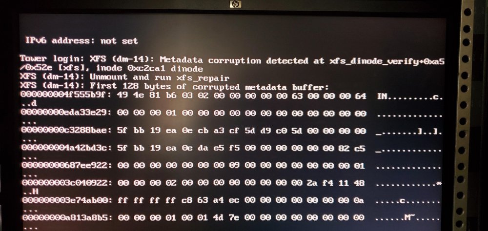

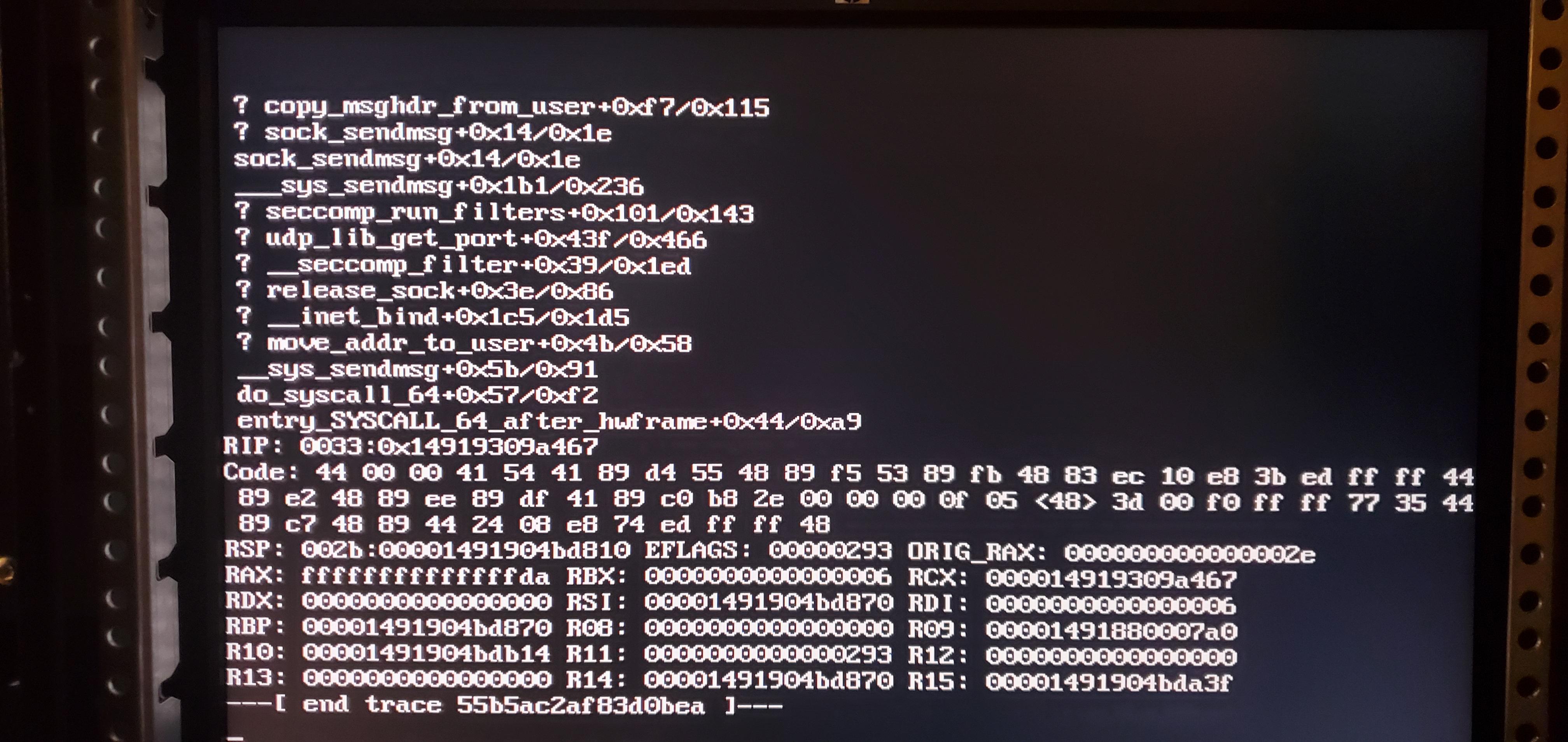

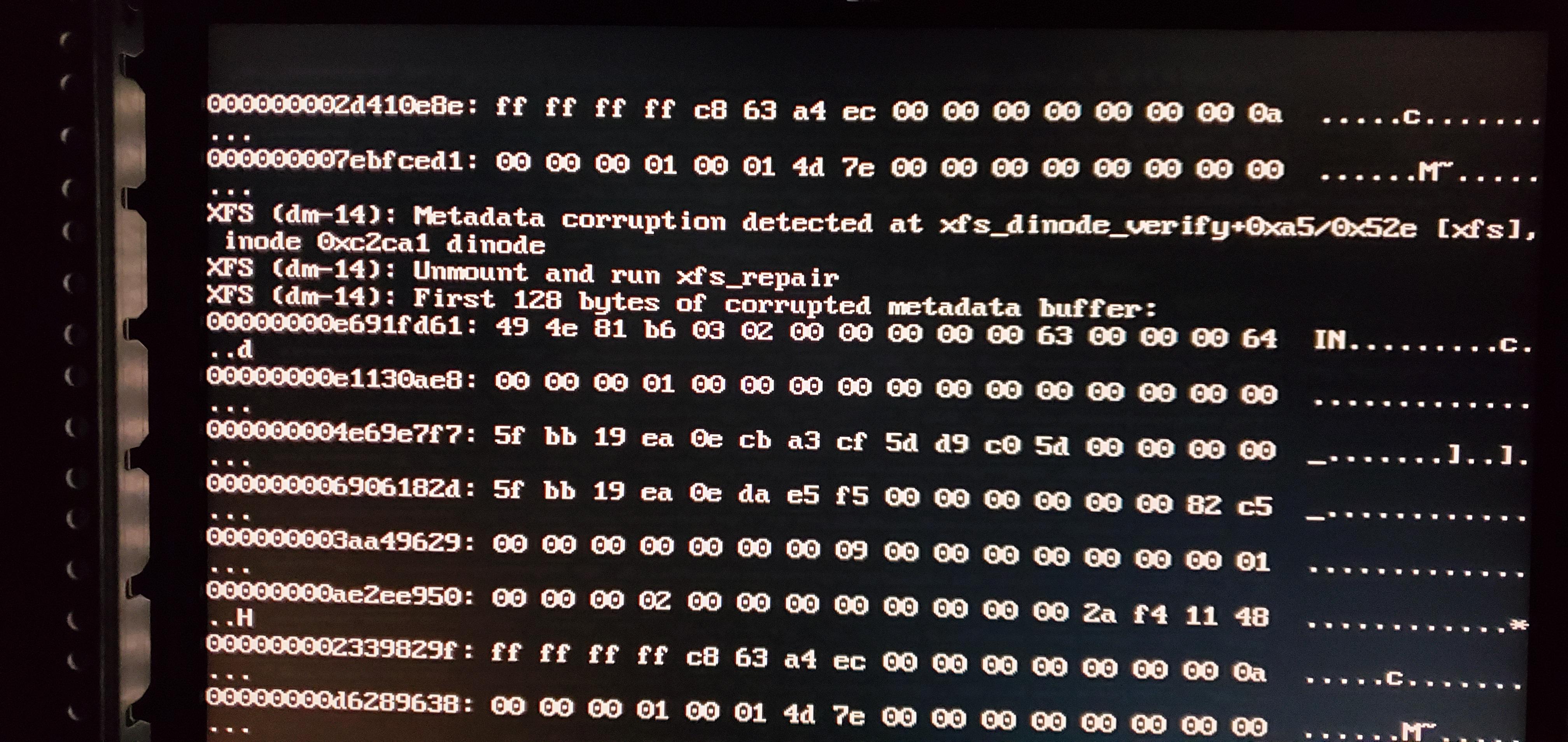

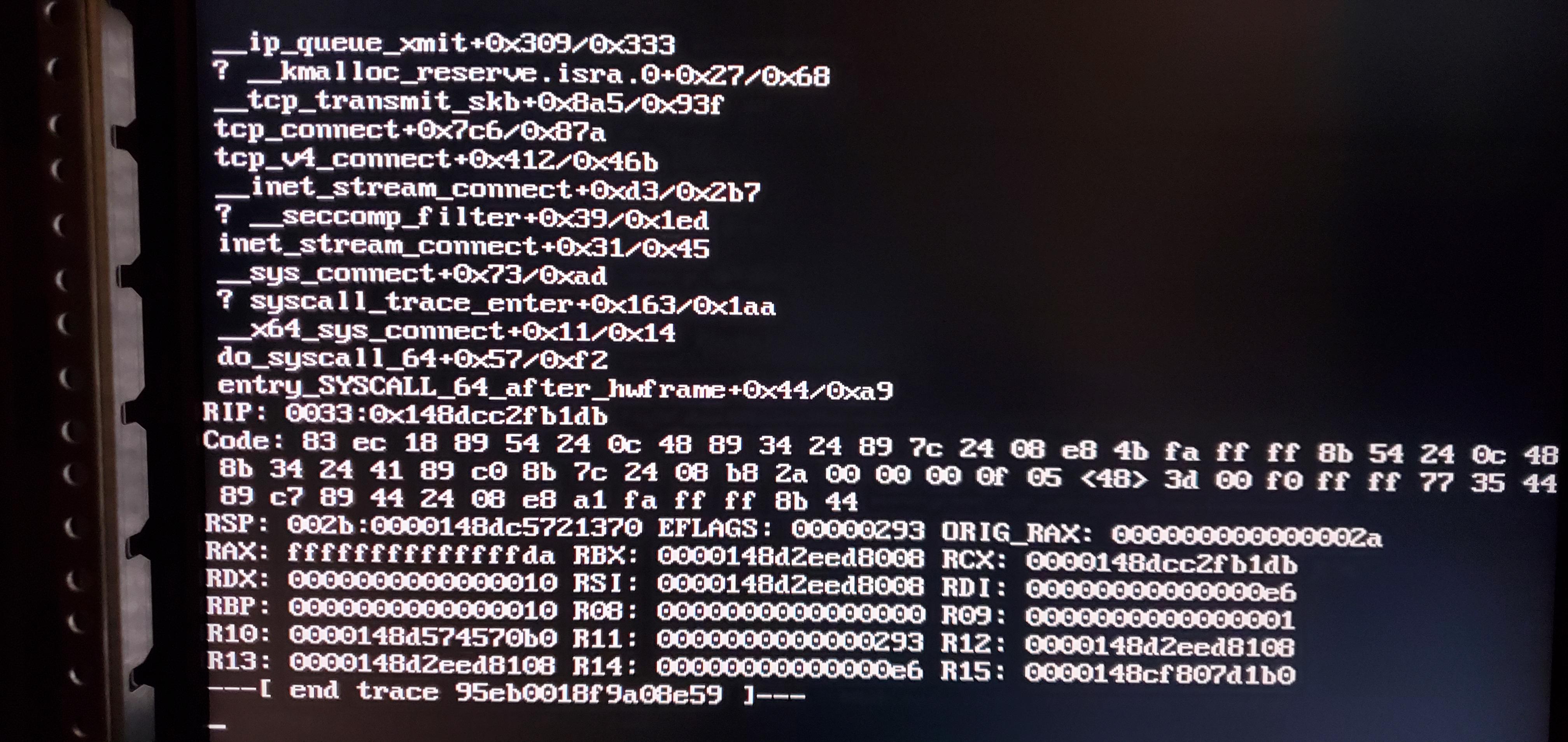

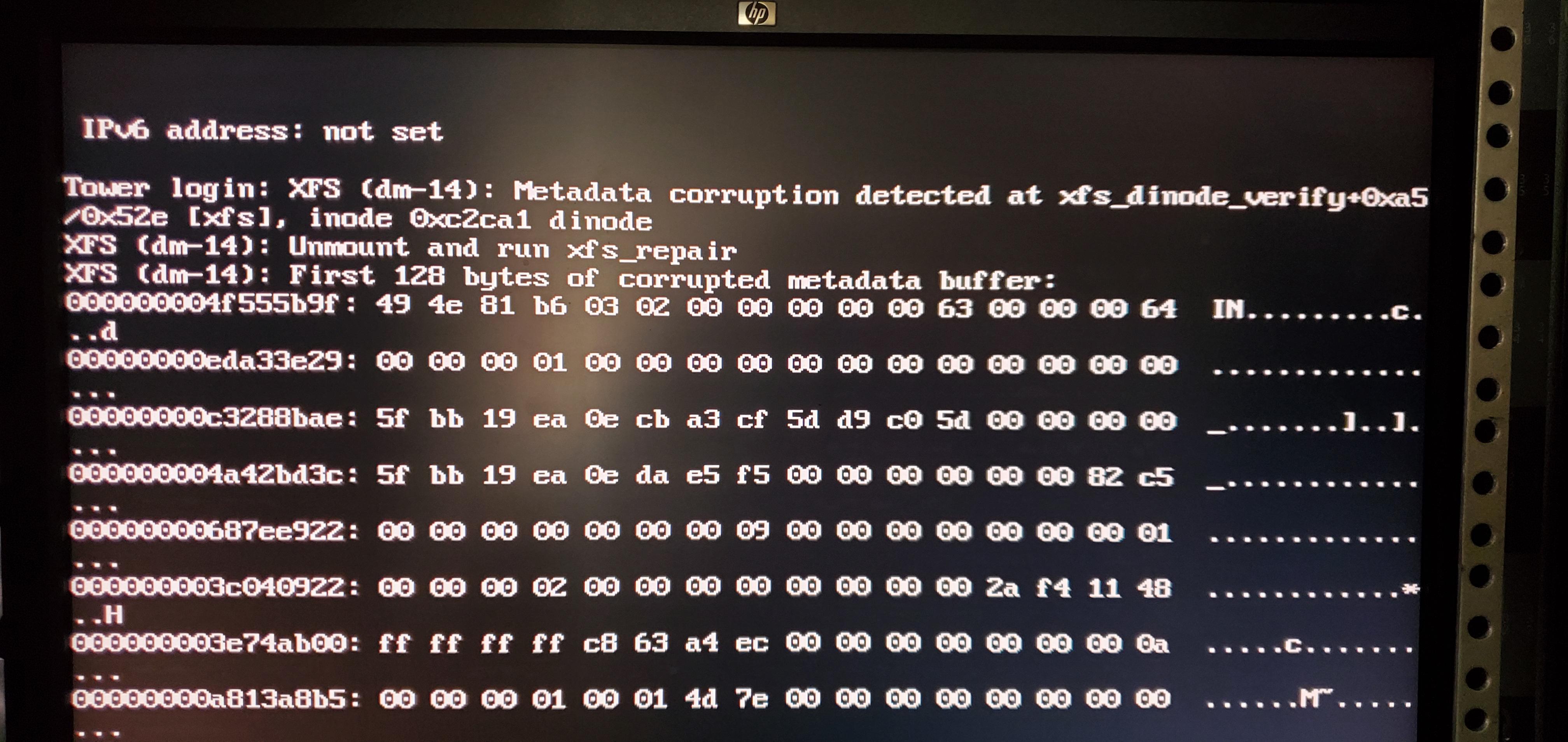

Ok this looks like it fixed the trace issue but now I have other errors, this might be due to curopt data caused by the lockups from the original issue.  These are the error messages I'm getting.
crash on Jan 18 2021
crash on Jan 19 2021
crash Jan 20 2021
Crash
Jan 25 2021
I see the message to run XFS repair but not sure if 1. that is the main cause of the crashing 2. which drive to run it on.

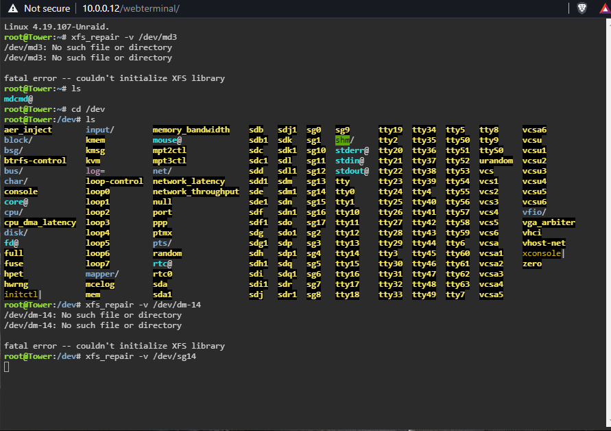

Looking at (dm-14) as the source, and looking at the XFS_repair at https://wiki.unraid.net/index.php/Check_Disk_Filesystems#xfs_repair I ran xfs_repair -v /dev/sg14 which I found in the /dev directory shown here.  Not getting anykind of status, or indication it is doing anything, see screenshot below.  I'll let it sit for a while.
Thanks,
Linenoise
1 hour ago, linenoise said:
Looking at (dm-14)
You need to run on the disk, not the device or parity will be invalid, dm-14 means you're using encryption, it should be disk 15 (or cache if there isn't one), but would need the diags to be sure.
I don't have a disk 15, so I am am guessing the cache drive.  I put the array in maint mode and ran the xfs_repair found in  Main > cache > check file system.  The following is the output I got using the default settings with -n flag.
