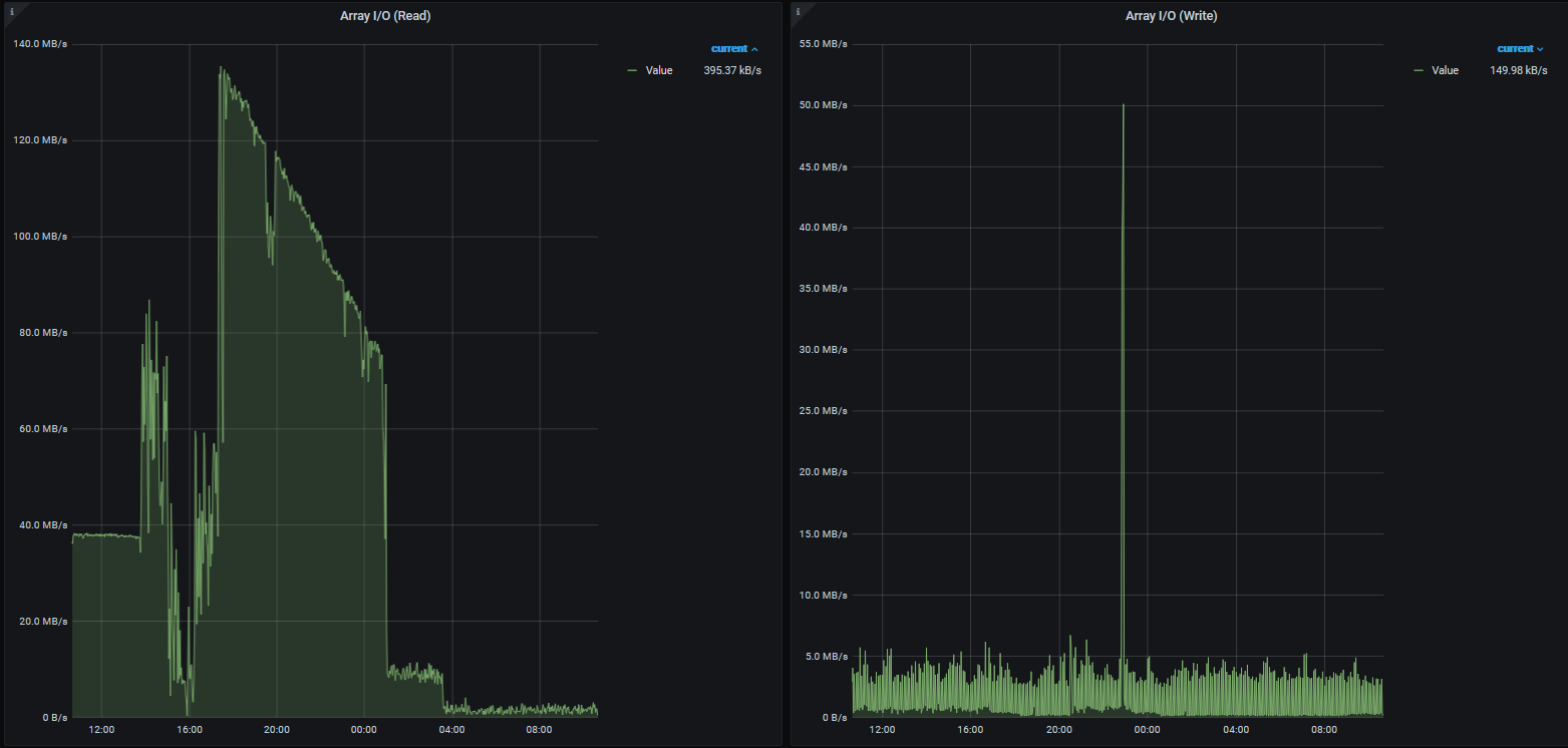

Just checked Grafana and it reports the following so this slow down started around 1am GMT image below

i also uploaded a grafana chart to give an idea when it slowed down

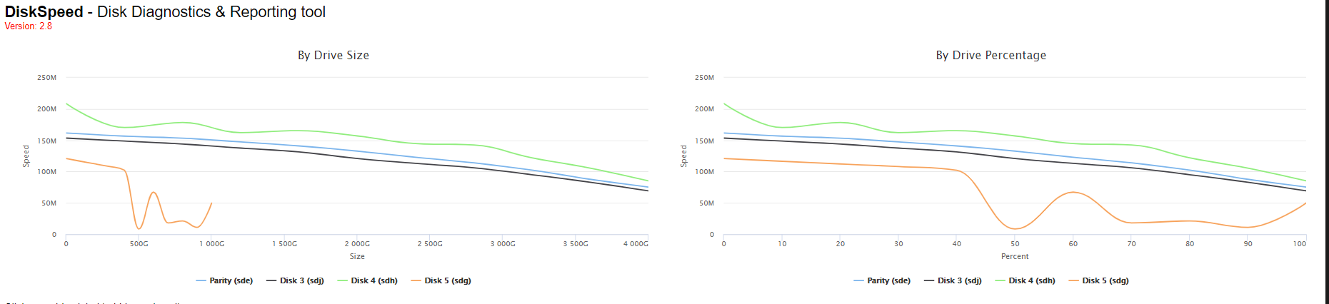

so a small update
i ran the extended disk scan it failed at 90% saying the disk need spin up even though it was, so i decided to run a disk diags test on the drive and got the following results on disk 5 not looking good going by the stats, a huge drop then raise then drop again which is very worrying so i have started pulling everything of that drive.
 i have reran the extended test but tbh it is not looking good

Thanks for your help diagnosing the suspected drive I decided to rip all data off it and it finished around an hour ago thankfully cause I just got an email from unraid saying the disk is not OK and after a further investigation in archived notifications it turns out the disk is now flagging 147 errors
So i have pudged the drive off my unraid and shunk the array for now, but 2 new 4tb wd red disks have been ordered
Also an FYI the smart check still ain't completed and been stuck at 90% for a good few hours.
