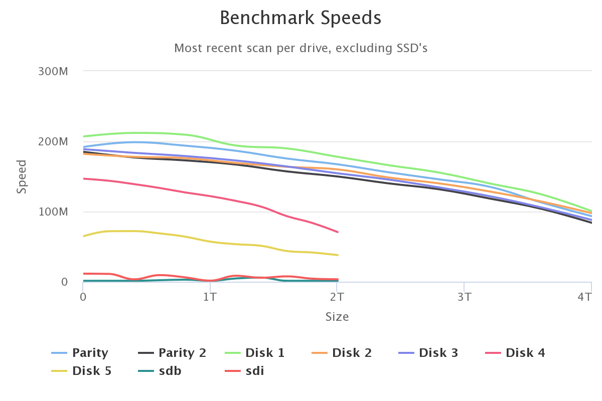

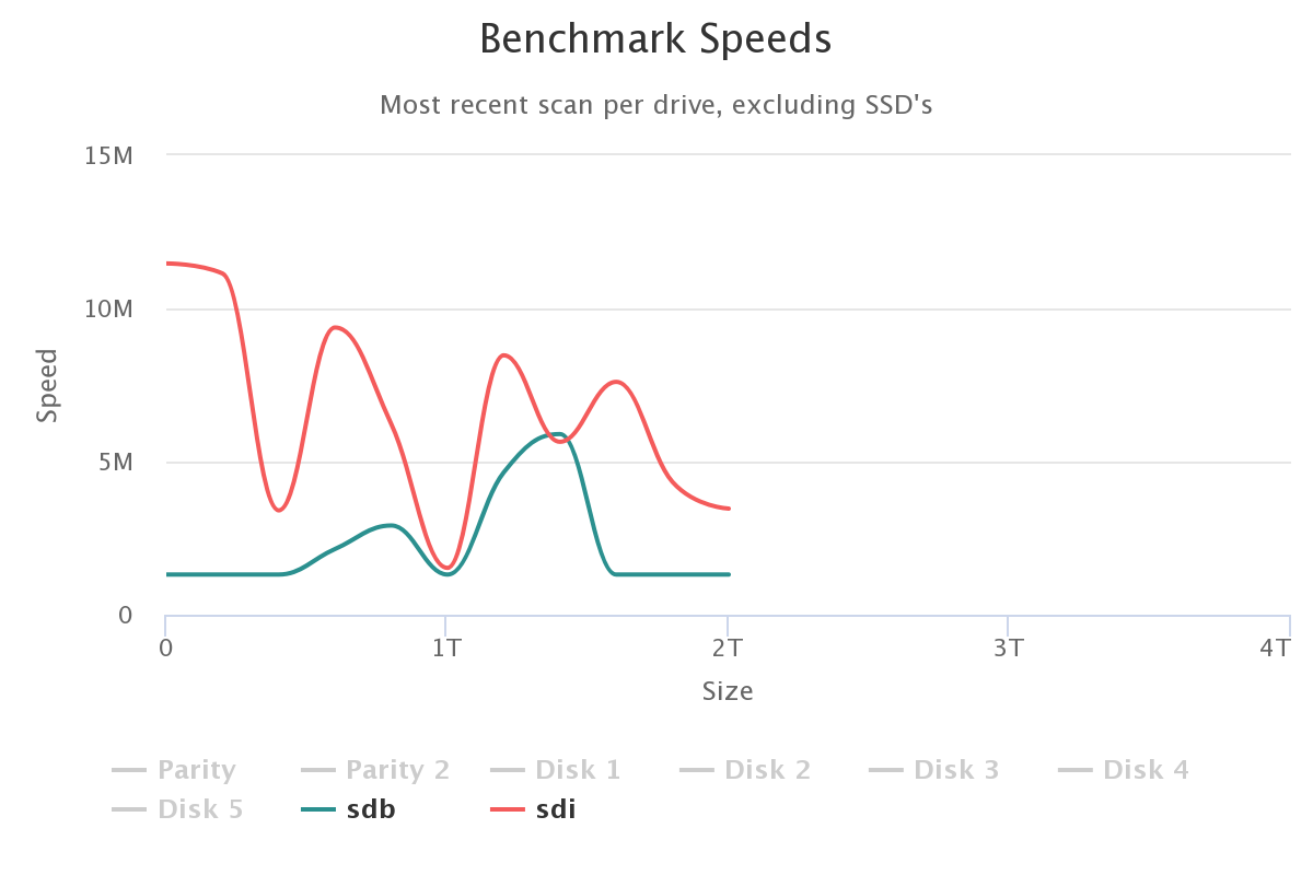

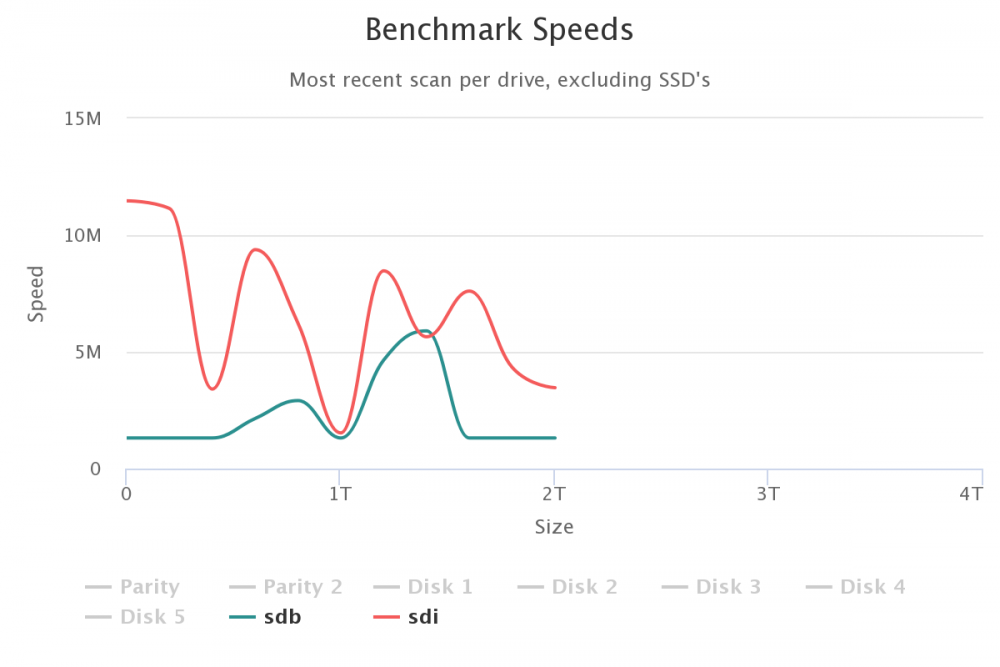

Run a test with the diskspeed docker and post the graph here.
1140611584_benchmark-speedssdbsdionly.thumb.png.a1375f0749dceeb9bf01cb0e774f3191.pngbenchmark-speeds.thumb.png.7982eacfcaf9acf80e5cd690e853e07d.png
Edited by iarp
Oh I just realized I never updated my last post.
After disk3(sdb in graphs above) vanished during the parity rebuild, It dawned on me that disk1 and 2 still had all their data. So I ran out and bought new 4TB's.
In the graphs above Parity 1, 2, and disks 1, 2, and 3 are all new 4TB drives. Disk 4 and 5 are the original disk 1 and 2 respectively. The rebuild of parity completed early this morning.
It's been at least 6 years since I used ddrescue. I'm going to give a shot at the original disk5 (sdi in those graphs above) and see what it can save for me. Original disk3 (sdb) i think is lost as it just vanishes after a couple minutes of attempting to access any file. I'm surprised it lasted long enough to do the benchmark really.
Also seeing those graphs really highlights just how badly one drive brings down the rest. The parity rebuild was going at 35MB/s in the 1.5TB to 2TB range and once it hit 2 out of 4TB completed it instantly shot up to 151MB/s. So I'll be glad to get rid of those old drives just for array speed sense.
Yep, those disks are in very bad shape, but still worth trying ddrescue.
