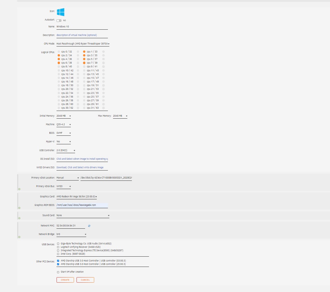

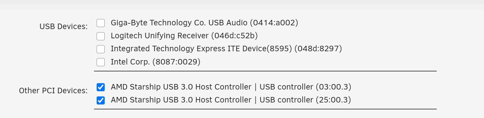

So far  I managed to make some USB controllers selectable in the VM  configuration template and to select them (see attachment USBControllers) . For  new profiles, I could save the profile ok, but the VM would not start and the server would  become non responsive when trying to access it from the browser in another machine.

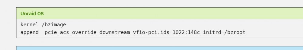

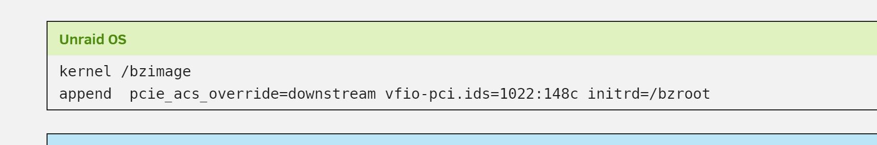

  • Identify it and passed it to the kernel in the dorm of vfio-pci.ids=whatever_id. the whole setting would become:
                    append  pcie_acs_override=downstream  vfio-pci.ids=whatever_id initrd=/bzroot

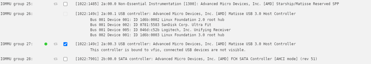

      The IMMO group  of my  motherboard would than be:  https://pastebin.com/2FEURvEu
      in that group  I would chose the controller with ID 03:00.3  which would lead to the USB device address: 1022:148c (exporting the the
      controller 1022:148c would also expose the bus 25:00.3). The configuration line would than become:
                                     append  pcie_acs_override=downstream  vfio-pci.ids=1022:148c  initrd=/bzroot

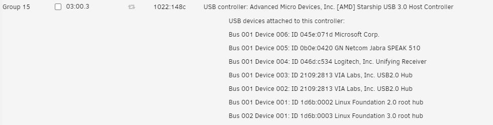

        if I select Group 15, I end up with the same  controllers of the image USBControllers, On a new VM I can select them and save the
        template but the VM would not start and freeze the server.

What do you currently have your PCIe ACS override set as. Go to Settings - VM - Manger - Advanced View: (try switching it to both- always had the most luck) and editing VFIO
Are you running Version: 6.9.0-rc2 of unraid? Edit the VFIO under -- Tools - System Devices and pass though the correct usb controller
If you are not using 6.9.0-rc2 download the VFIO addon under Community Applications and add the USB controller this way
Also I'm sure you made sure the USB controller you are trying to use is not the one that has the UNRAID usb; if you try passing though the same usb controller that has Unraid USB your system will halt.

When looking at your IOMMU group it should look similar to this
Can you post your System Diagnostics
This is telling me what ever controller you are trying to use has the unraid USB connect in someway

I eventually managed to pass through USB controllers when I installed Unraid 6.9. Looking at Tools - > Devices, it now tells you what USB Controllers you can pass through because they are not used by Unraid, it turned out that was my problem, meaning the USB controller(s) I was trying to pass were used by Unraid.
