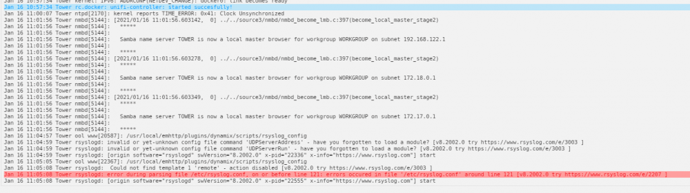

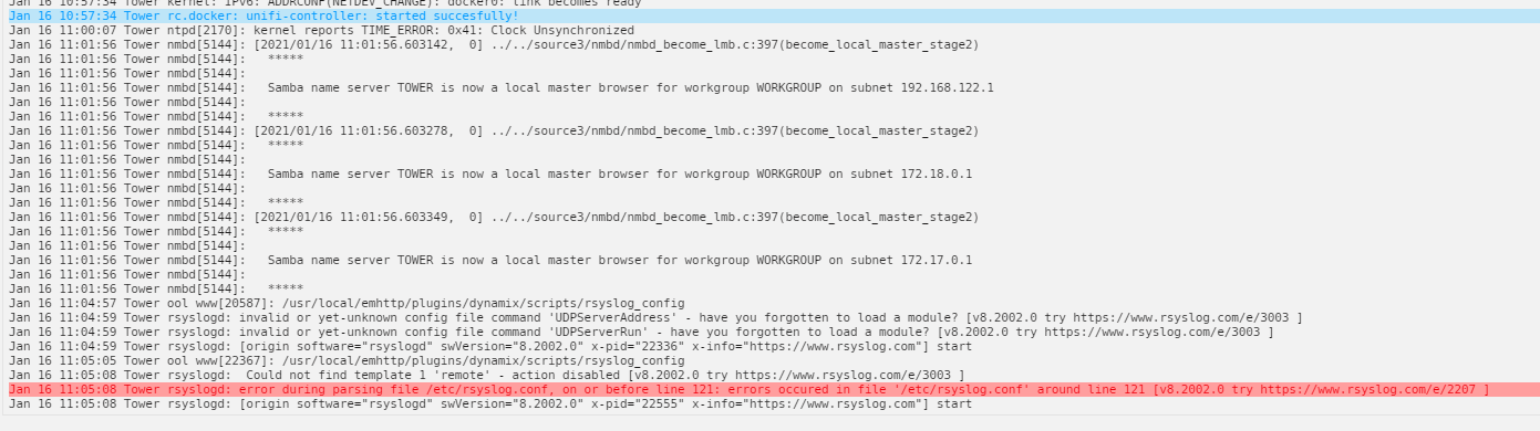

I added the syslog showing the errors, not sure if it will help or not.
Also I am trying to get the syslog fixed using, this fix failed. it recreated the files in boot/config without any improvement.
Should I delete them in Boot/config and  delete the rsyslog.conf in /etc  as well?

These are the last entries on my syslog.
I tried setting the syslog server to mirror to the Flash, but that doesn't seem to work either
Edited by kysdaddy
