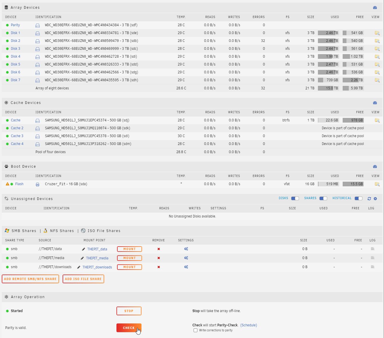

Yesterday I noticed, that one of the disks reported 32 read errors. So today I decided to run a parity check.

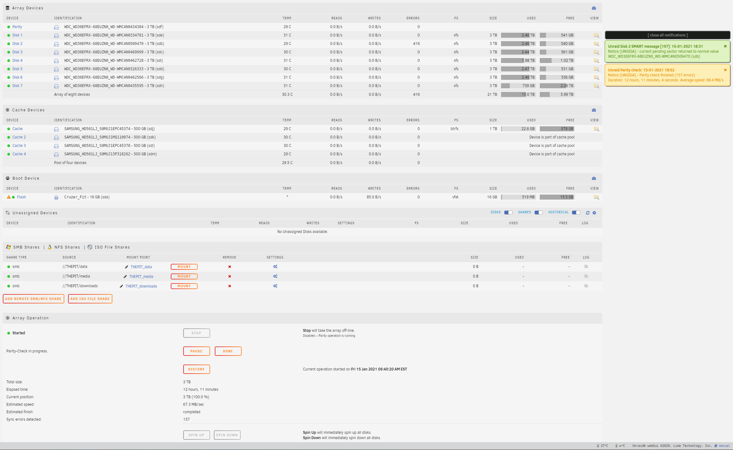

  • As per instructions in the wiki, I ran non-correcting parity check.
  • It finished with 157 sync errors.
  • At the same time, the disk with 32 errors, now had 416 read errors.
So, basically - what do I do now?

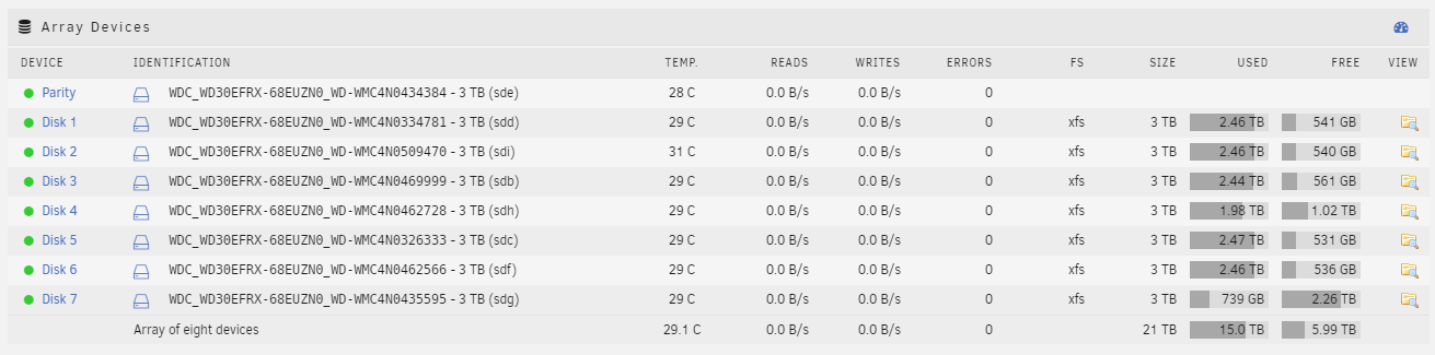

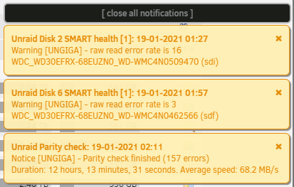

So I ran a non-correcting parity check again - the same number of 157 errors. 🤔
No disk read errors on this 2n run. 👍
But this time - TWO drives had their SMART Raw read error rate increased by 1 (15 to 16 and 2 to 3). 😠

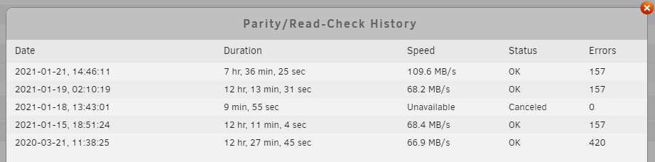

I just finished running Parity Check with `Write corrections to parity` and updated the parity. The log shows a list of corrections, like these:
Jan 21 13:58:50 unGiga kernel: md: recovery thread: P corrected, sector=5455701888
Jan 21 13:58:50 unGiga kernel: md: recovery thread: P corrected, sector=5455701896
Jan 21 13:58:50 unGiga kernel: md: recovery thread: P corrected, sector=5455701904
Jan 21 13:58:50 unGiga kernel: md: recovery thread: P corrected, sector=5455701912
Jan 21 13:58:50 unGiga kernel: md: recovery thread: P corrected, sector=5455701920
I guess, that means that parity has been updated.
What is kind of confusing, is that the results in the UI and the log look exactly the same, as if I had run a read-only check...
Should I run a read-only check again? To make sure that I get the desired 0 errors result?
Edited by shEiD
Yes. Until you have confirmed you have exactly zero sync errors you aren't finished. If you don't get zero after you already corrected parity then that would indicate some other problem.
