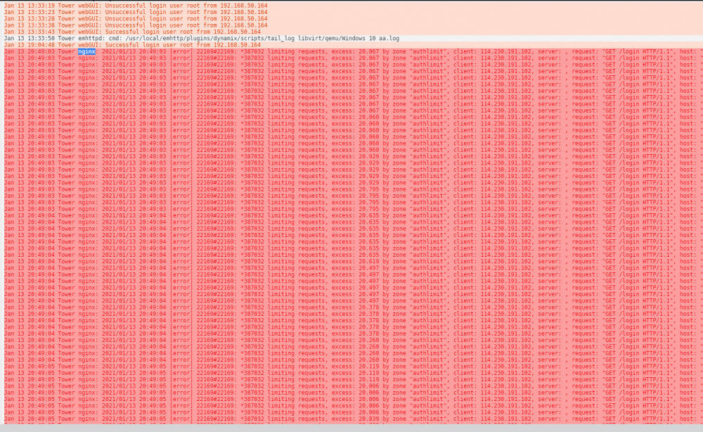

First of I don't have nginx installed and I never had it installed; is that something that's built into unraid; or did someone put in a backdoor before updating my router/etc?
It appears at least once a day a IP will do  what's listed below. they all appears to be from china or similar. Can anyone explain what's going on?
I only cut off the end because it has my personal IP

Nginx is the web server built into UnRAID to handle it’s GUI.
Have you put Unraid directly connected to the internet?  UnRAID is not hardened enough to do that and if you do you will almost certainly be attacked.

I used Unraid as my main PC. I ended up removing any port fowarding I had on my router before to see if this helps.
