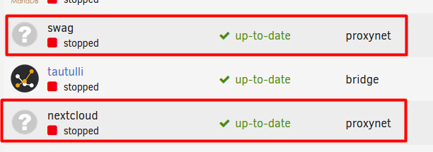

I reasonly had to backup my appdata using 'CA Backup', but atherwards it seems that two or my dockers doesn't seem to work.
'Nextcloud' & 'Swag'.

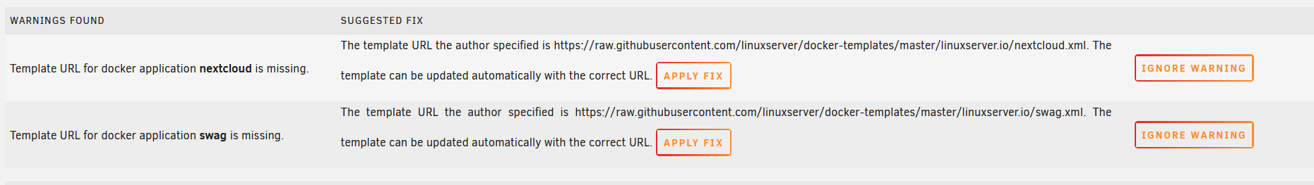

As the pictures illustrates, 'Fix Common Problems' doesn't seem to know how to fix it.
The data & files of nextcloud and swag is still under the folder 'Appdata'.
Does anyone know of this problem? Should I just "download" the docker again, and then the tempale marges with the data/files i allready have?

The error from FCP seems to indicate that the file(s) within /config/plugins/dockerMan/templates-user for swag and nextcloud do not exist or are corrupted.  Did you originally install them via Apps or via the command line?
Community Applications (Apps), following Spaceinvader one video on it :s

5 minutes ago, Squid said:
On the flash drive
my-swag.xml is missing.
my-nextcloud.xml is there.
You're probably right, something is corrupted :E

The templates (.xml) on flash are basically just the entries you make on the Add / Edit Container page, which is where Community Apps takes you to install a docker. The name of the template is the name you gave to the docker when you created it.

Downloading the docker isn't the problem, the download is just getting the executables from the internet. It is those settings from the templates that tell it how to use those executables in a "docker run" command.
The template is the only place those previous entries exists. The Previous Apps feature on the Apps page will reinstall any containers exactly as they were using those templates, but if the templates are gone or broken you would have to do a fresh install of the docker, in which case you would get the default settings just as when you first installed them, and would have to make any changes or additions as needed just like the first time.

Wait... inside the .zip file, there's a "my-swag.xml" I might try to transfer it over and see what happens. I'm so cunfused.
Wtf.. It worked.. Thank you guys. Guess it got corropted while copying over? Maybe? I don't know.
