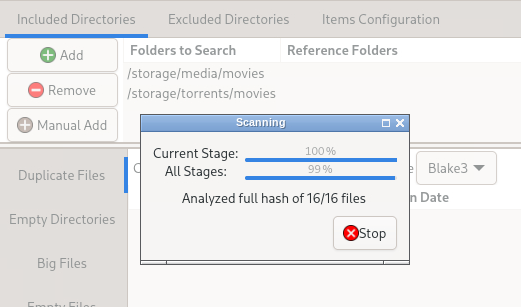

I am trying to use Czkawka to fix hard links. I installed and set the path in the container. When I am inside Czkawka and define the two folders to search in my program seems to just stall out indefinity. Any help would be greatly appreciated!
One thing I noticed is it says 16/16 files. But each folder contains way more than 16 files?
Edited by BartyB

[app ] 17:40:23.901 [INFO] czkawka_core::common::logger: Logging to file "/config/xdg/cache/czkawka/czkawka_gui.log" and terminal
[app ] 17:40:23.904 [INFO] czkawka_core::common::logger: Czkawka gtk version: 11.0.1(<unknown> U <unknown>), release mode, rust 1.93.1 (2026-02-11), os Alpine Linux 3.20.9 (x86_64 64-bit), 16 cpu/threads, features(2): [heif, libraw], app cpu version: x86-64-v1 (SSE2), os cpu version: x86-64-v3 (AVX2), libc musl [build + runtime (glibc <not detected> | musl 1.2)]
[app ] 17:40:23.905 [INFO] czkawka_core::common::config_cache_path: Config folder set to "/config/xdg/config/czkawka" and cache folder set to "/config/xdg/cache/czkawka"
[app ] 17:40:24.162 [INFO] czkawka_gui: Czkawka Gui - used thread number: 16, gtk version 4.14.4
[xvnc ] Sun Mar 8 12:40:52 2026
[xvnc ] Connections: Accepted: /tmp/vnc.sock
[xvnc ] SConnection: Client needs protocol version 3.8
[xvnc ] SConnection: Client requests security type None(1)
[xvnc ] VNCSConnST: Server default pixel format depth 24 (32bpp) little-endian rgb888
[xvnc ] VNCSConnST: Client pixel format depth 24 (32bpp) little-endian bgr888
Edited by eman31
Added info
Is the container crashing (i.e. restarting) or you just get disconnected from the UI ?
