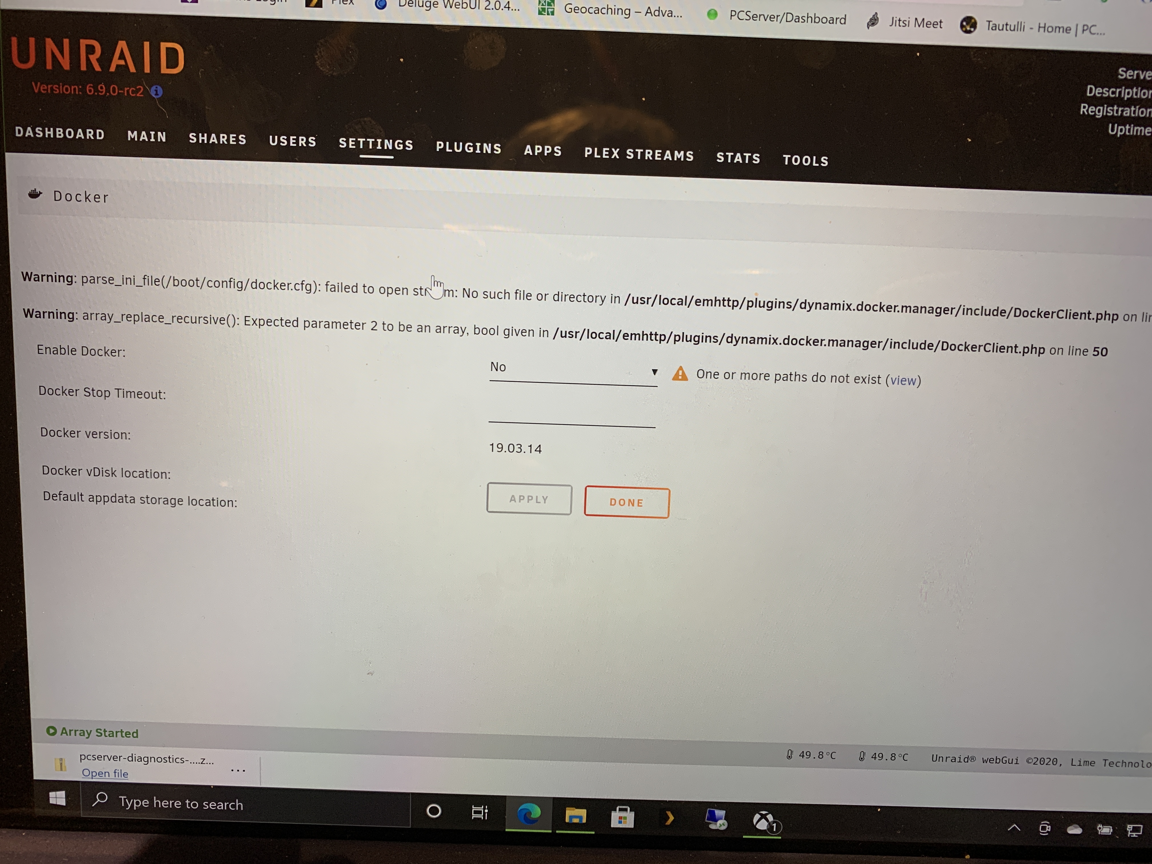

Installed the drive and rebooted. The login screen displayed a white background when it normally was black. I could log in and normally, the unRAID UI is black but now it's white and the machine logo in the description box has changed. Docker and VM's will not also run and there is a parsing error?
I rebooted the server and then I am unable to even see the UI for unRAID, although the shares were all running and available on the network.

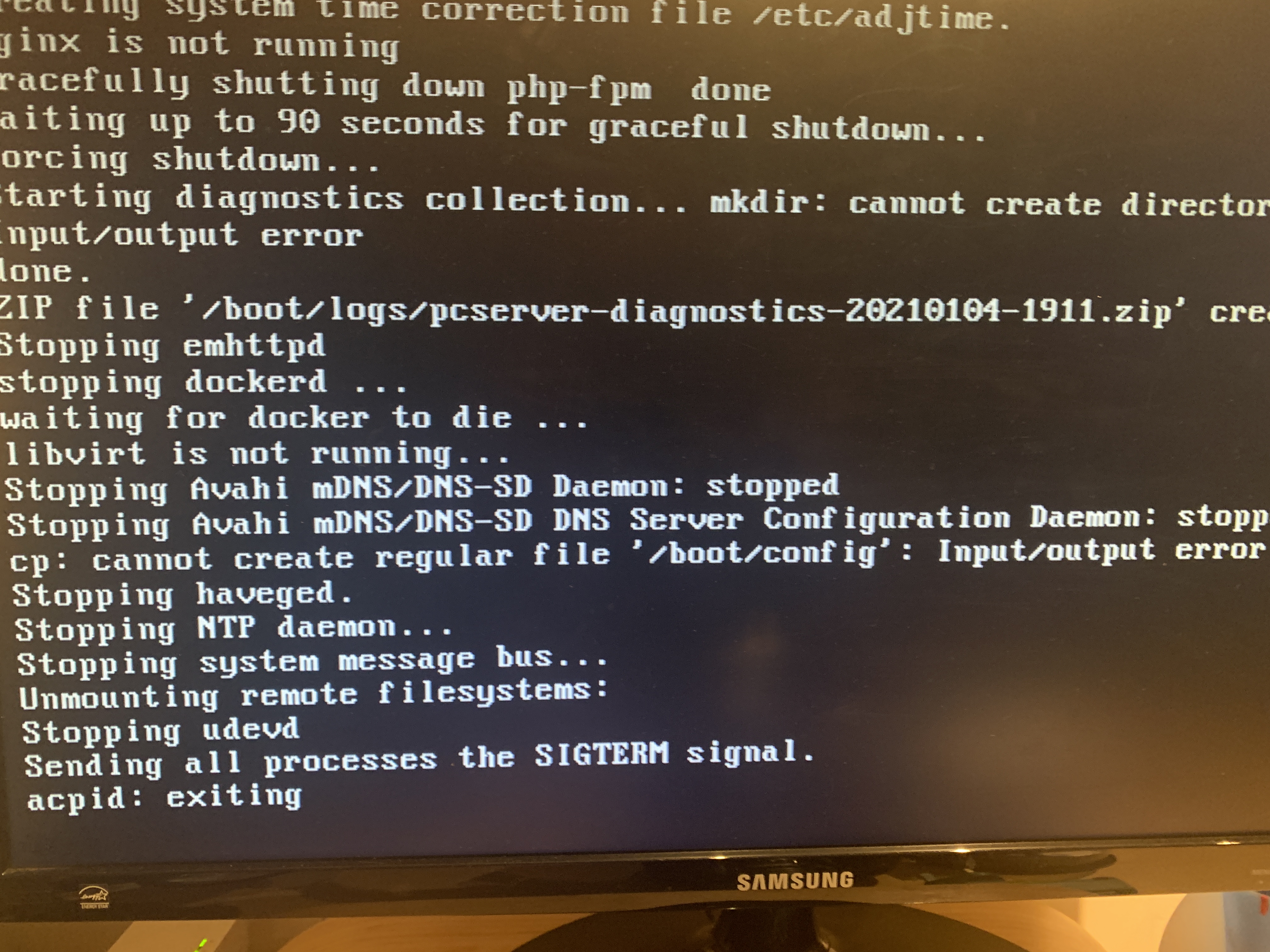

That’s the last log file I have. I thought there may be something in there. I took a screenshot of the computer shutting down when I had the nvme drive in. Looking at it says .zip file is not created? The photo is attached to this post.
The whole server behaved so strangely. It was almost like it could not find some settings or access a part of the system. It was exactly the same when I installed a second graphics card.

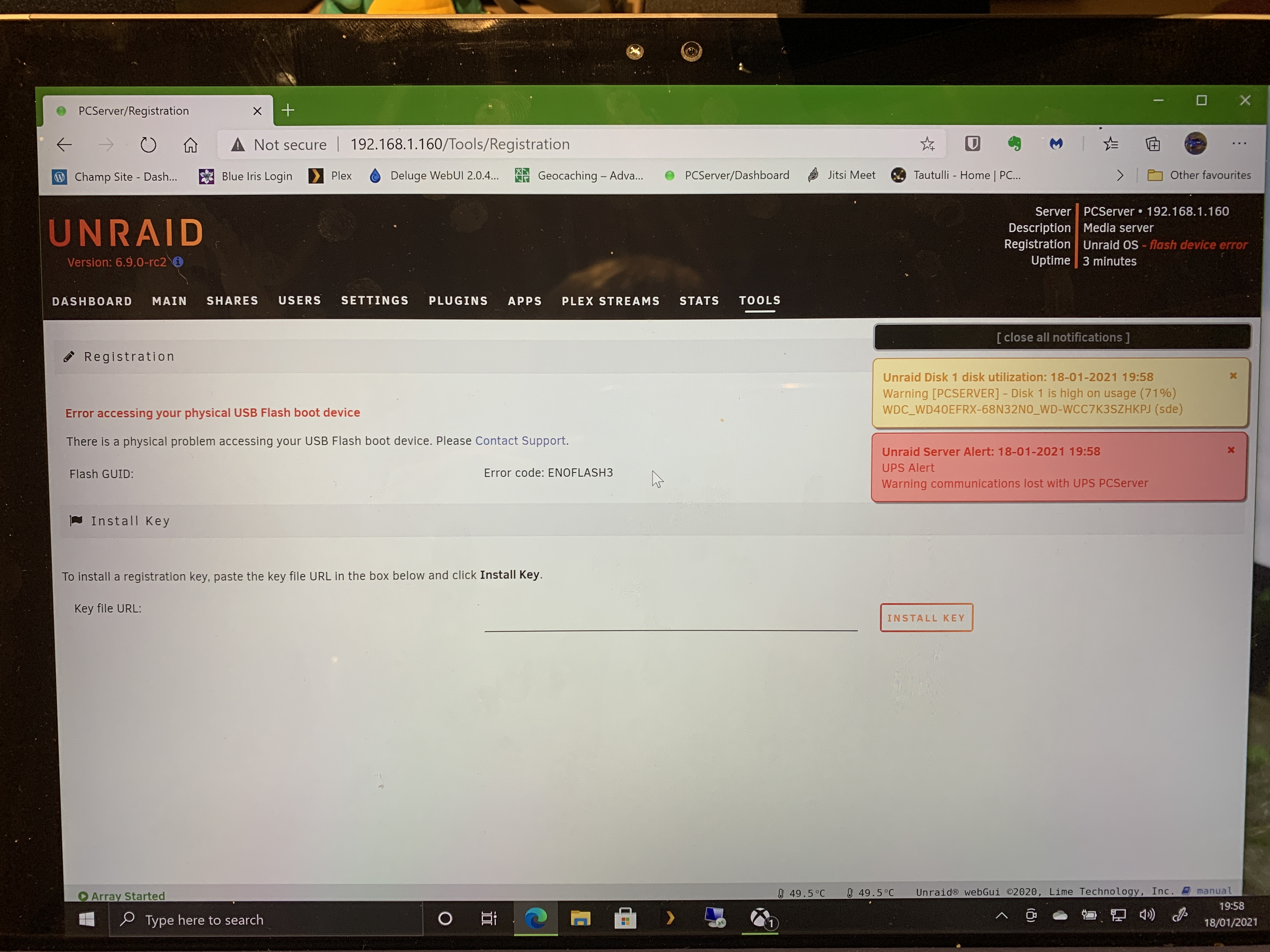

I have installed the nvme drive and had another go. Same errors, however, I have captured as much data as I can. I downloaded a diagnostics file with the flash drive installed. It's attached below. Plus had a look at usb information. Screenshots below. It looks like a usb problem? Took the nvme drive out and system works fine.
The only usb2 ports are on the front of the case so I can give that a try, unless you think there is anything else I should do based on the latest diagnostic report and screen shot.

So it looks like we've found the root cause of the problem.  By any chance did you start a VM in those diagnostics?
What it looks like to me in this snippet is that something took control of the USB controller on 0000:09:00.3, which appears to be where your unraid flash drive is located:

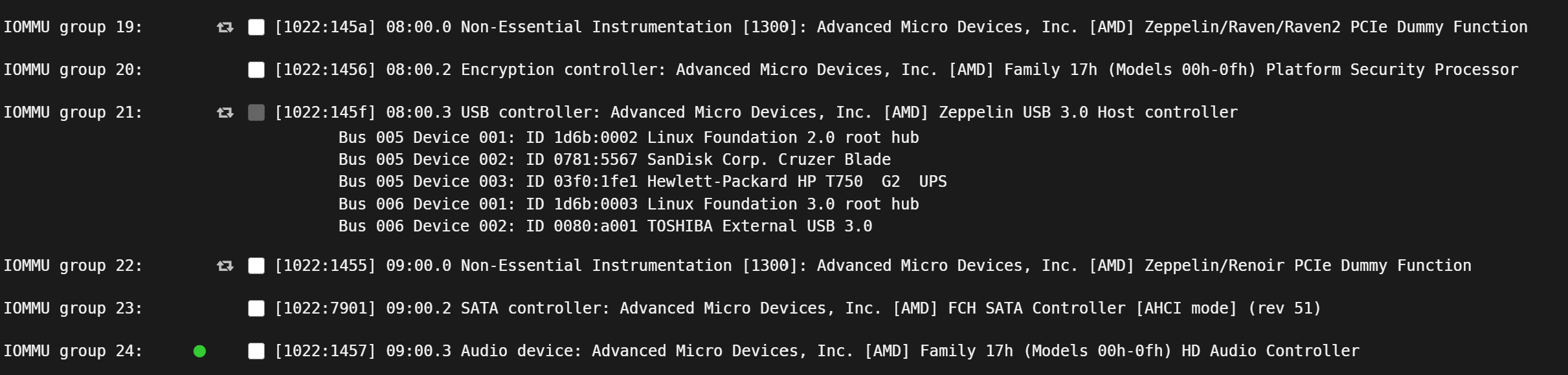

Thanks ever so much for your help! This is exactly the problem. Been doing some research based on your comments. unRaid 6.9 has the plugin you were talking about installed when you inspect the iomuu groups. The sound card is passed through to the VM and the VM is set to autostart. I could get rid of the sound card passthrough but first I will try and split it out in the iomuu groups. Also setting the VM to manual start just in case.
When looking at the groups there is a green dot next to devices passed through to the VM so I will attached them to the vfio.pci file and see what happens. All done via the iomuu page and much easier now that the plugin is incorporated. Screen shot below.

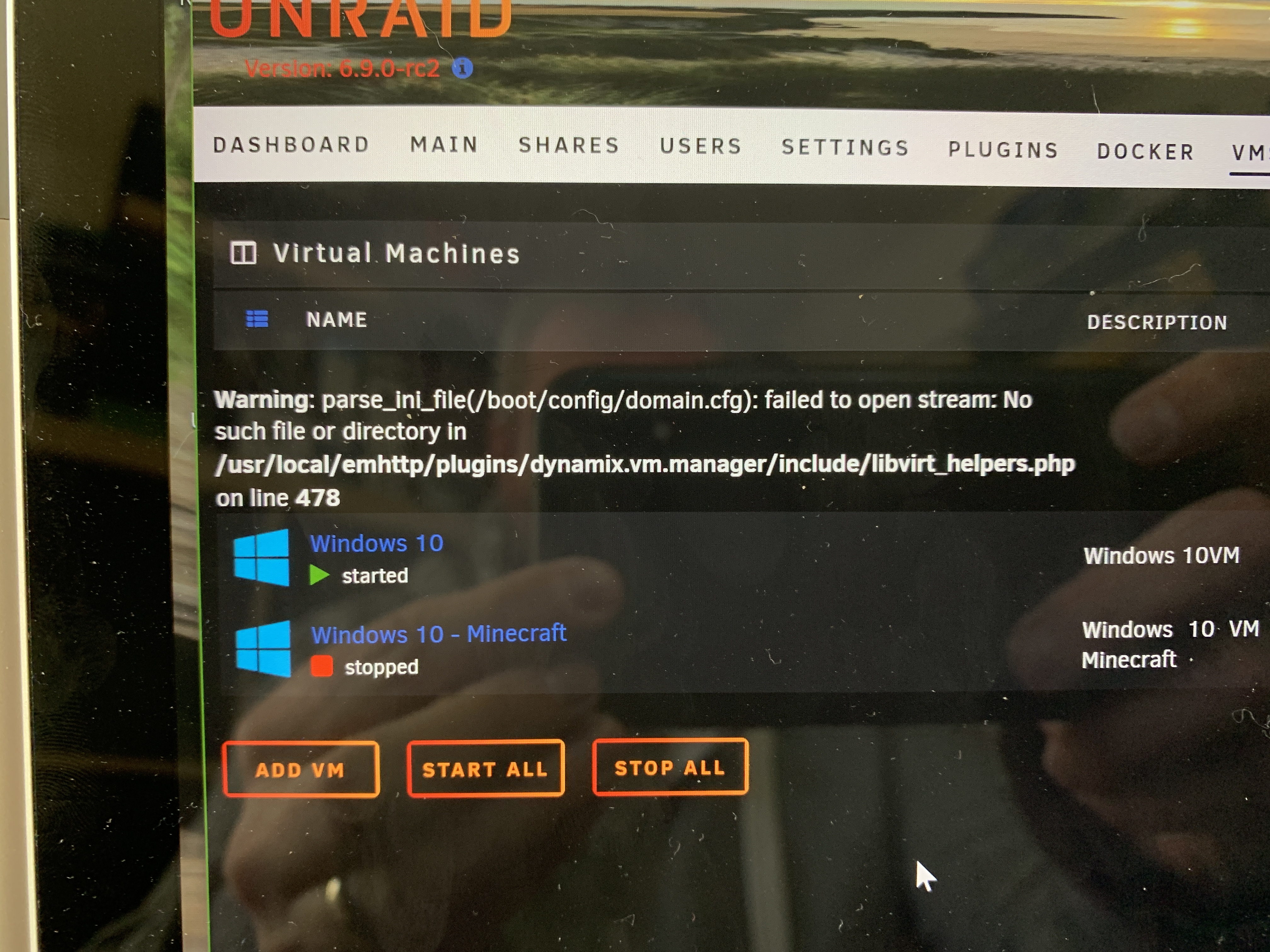

Great advice! I have an update and success, well nearly success. I had a play around with changing the iommu groups and tried stubbing, using in the built ability in teh devices section and wrote the config file. I pass through an external usb drive to record video from Blue Iris and this is passed through to the VM. I got to the stage where I didn't need the sound card so didn't pass that through and could see the nvme and also the external drive and teh system did not crash due to the 'usb error'. My main vm refused to work, it kept crashing the system, but by not autostarting the VM (advice noted and will always be used!) it was easy to reboot and try something else. My other VM worked a treat and didn't crash, so I have moved to that, set up Blue Iris (I had already backed up the settings) and it now works. I will just delete the other VM which was causing problems (see screenshot below when it tried to start)

Looks like you've made a few steps in the right direction.
Now for the bad news, I see an issue right away with that screenshot.  The php warning at the top (Warning: parse_ini_file.........) seems to indicate that your flash drive dropped offline again.  Either one of two things come to mind: 1.  you should use a USB2 port for the flash drive.  2.  when you passed through the USB device for blue iris in your windows VM, you passed through an entire USB controller that the flash drive is one, or the drive itself, on accident.
If you just need a single USB device, then you should be able to pass through JUST the USB device by itself to the VM.  This works well for mice/ keyboards.  If you need more control of the USB functionality or want the entire USB controller to appear in the VM, then yes, you pass the controller through - but anything that is connected to that controller will not be available to unraid (i.e. the flash drive).  If that is the case, then you need to find a USB controller on it's own IOMMU group AND not attached to the unraid flash drive.

The good news for the screenshot is that it’s for the ‘old’ VM which I am going to delete and not worry about. I just included it for info but it actually caused more confusion! Apologies for that! I have had no more issues as such. The external hard drive says missing in the historical section of  unassigned devices but it’s passed through to the vm so that all works perfectly.
