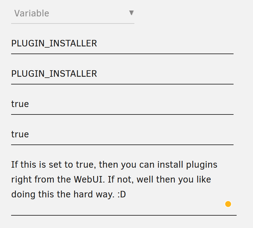

April 3, 20215 yr In case anyone wants to be able to use the plugins right from the UI. you have to add the variable yourself. Like this.
April 10, 20215 yr Author On 4/3/2021 at 6:54 AM, cammelspit said: In case anyone wants to be able to use the plugins right from the UI. you have to add the variable yourself. Like this. Hey, Another way to enable it would have been through the config file in the data folder, but I've added the option to set it when setting up the docker right away. Left it to false as default, since this is how the original config file has it set. Thanks for the heads-up!

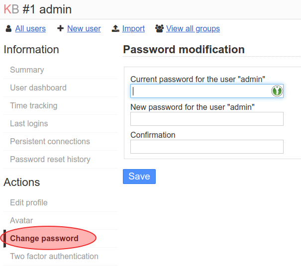

April 23, 20224 yr In case you search for default user to login: user: admin pass: admin I did not find this mentioned somewhere. You can then change the password for the admin user in the user management:

March 16, 20233 yr Hello all, Having an issue - having enabled plugins via the install, when I try and install a plugin through the webui (greenwing as an example), the following error pops up: "Unable to open plugin archive." a quick google suggests this is due to missing php-zip - any possible way to add this or am I doing something ridiculously silly? Thanks in advance. EDIT: plugins work if I wget them and unzip them to the plugins folder - would be good to have it working from UI though! EDIT: if i manually add the variable as shown by Cammelspit, it works - bit random but sorted! Keeping this up for others incase they hit the same issue! Edited March 16, 20233 yr by LewJ Updated
