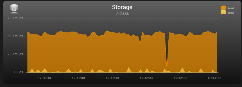

A few hours into the parity check and the same messages hit the log roughly every 3 minutes.  I don't particularly see a hang, but maybe a slight dip in the storage stats as shown in the attach screen snippet.
I'm not sure how I'd test the power, other than having a completely 2nd PSU running this one drive.  Is that even safe to do?
Slight dip could be ignore. Speed chart so flat and look normal, so file transfer dip should not relate controller/disk problem.
