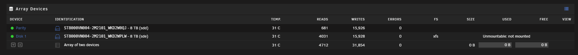

Added a new disk to the array today and stopped the clear that unraid was doing.
Now I'm getting Unmountable: not mounted
Jan 17 17:19:59 MirinServer root: mount: /mnt/disk1: wrong fs type, bad option, bad superblock on /dev/md1, missing codepage or helper program, or other error.
Jan 17 17:19:59 MirinServer emhttpd: /mnt/disk1 mount error: not mounted

A ‘Clear’ is the action Unraid takes when adding a disk to a parity protected array as that is the action needed to ensure parity remains valid.
i am a bit confused as your screenshot shows only 1 data drive - were you trying to add disk2?   Has disk1 ever been formatted in Unraid?
Hi @itimpi Yes I was trying to add disk2. I have removed it from the array.
4 hours ago, itimpi said:
Has disk1 ever been formatted in Unraid? - To my knowledge no, unless Unraid does it by default when loading the array for the first time.
What was the output from the xfs_repair commands?

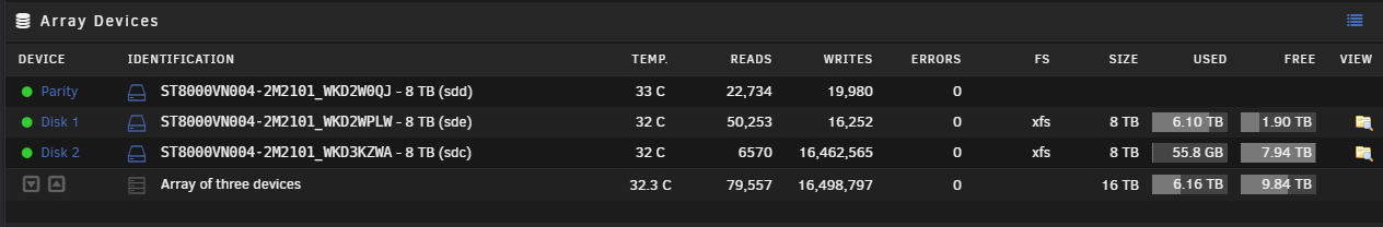

Jan 17 17:07:05 MirinServer kernel: XFS (md1): Filesystem has duplicate UUID eb78e917-4f51-464e-8114-d251dc7845f5 - can't mount
I had an unassigned SSD that changed its dev name. I have changed my boot script to use UUID instead.
Everything is now working as you can see below.
Thanks for the help @JorgeB & @itimpi
