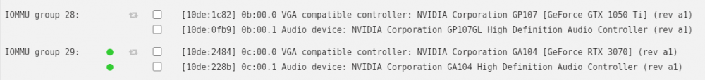

System:
unRAID 6.9.0-rc2  • ASUS x570 Crosshair VIII Hero (wi-fi) (Latest BIOS 3202) • AMD Ryzen 7 3700x CPU  • 64GB (2x32GB) Samsung DDR4 ECC Unbuffered RAM
• ASUS 1050 Ti 4G Strix Gaming (SLOT 1) •  Zotac 3070 Twin Edge OC (SLOT 2)
Current Issue:
I have created a Windows 10 VM following the videos from Spaceinvaderone. Initially without passing through any gpu.
After completing the setup of the VM I tried to passthrough my 3070 (or 1050ti) without any luck. I checked with both i440-fx and with q35 as well as using the vbios and not using them.
The strange thing is that the guest starts and I can vnc (I have setup a vnc server). However, the connection is extremely slow and unresponsive so cannot do anything.
I have attached the VM log as well.
Any ideas?

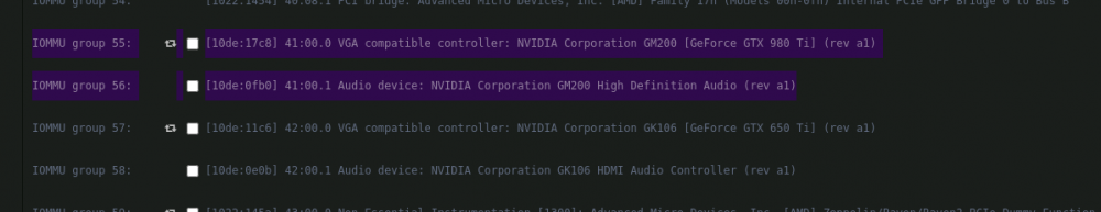

Sorry to hijack this thread, but this is basically also my problem. In my case, there is only one difference, the GPU (Nvidia 980ti) and its sound-counterpart are in different IOMMU groups. Before I repeat everything which is mentioned here, can this a problem and should I solve it?
Thanks
hundsboog

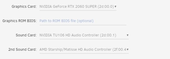

Um this is Normal. That's because a GPU is and Video and audio card. Depending on the card you may have to fix the Multi-function under the XML.
It will look like this below when you are setting up your VM. Under sound card the the video card must be primary.
Thank you very much for that lightning fast answer. I just wanted to exclude anything which could interfere passing through my 980ti. The OP had the gpu and the sound counterpart in the same IOMMU group, so I just thought it could be a good thing to ask. For some reason I got the same error 43 which I had not on UnRaid 6.8.3. Me idiot deleted the perfectly running GamingVM. Thats the price to pay not properly backing upo, I guess 😄
This is how mine looks on my gaming VM. Hope that makes you  feel better.
Let me know if you are still getting Error 43 after doing that.
