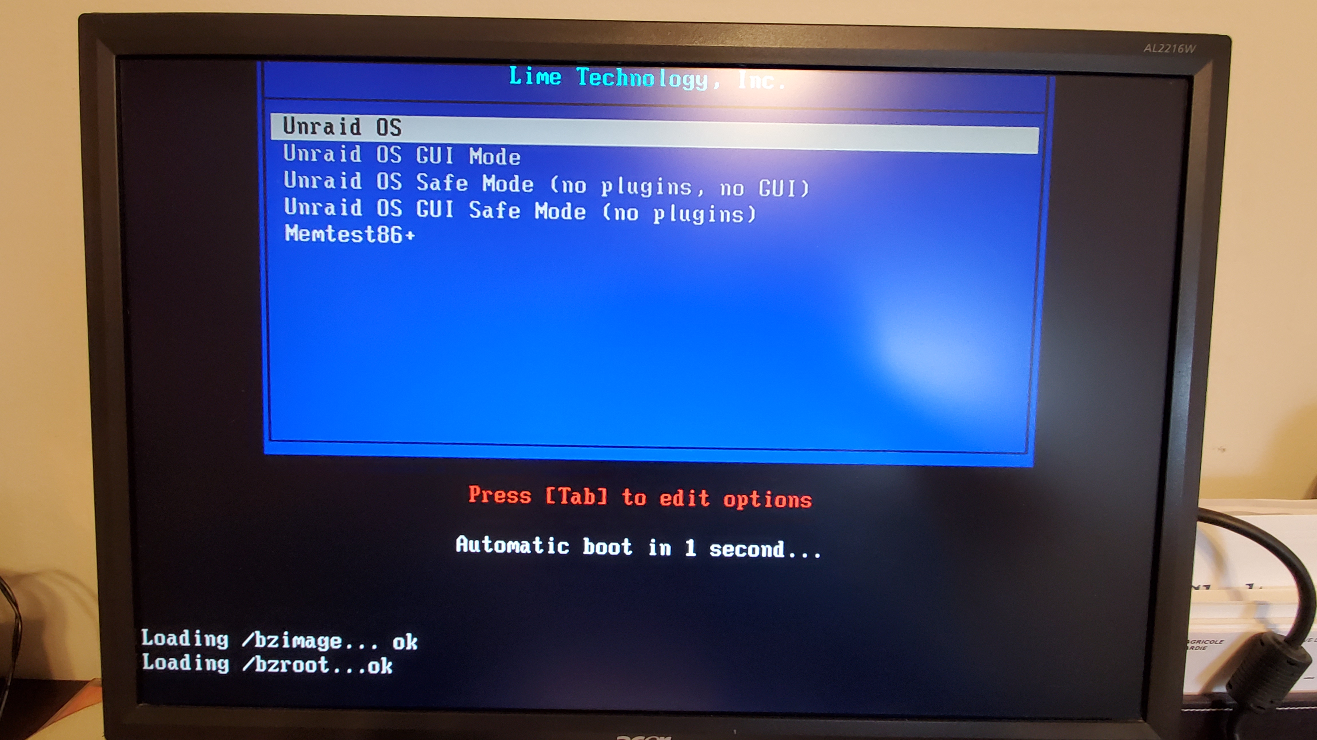

I just replaced my old motherboard+CPU (Atlhon X2 250) that has been working perfectly for several years (as a vanilla server) by a faster CPU (but still old) a Phenom X6 1055T (with another motherboard as well)
I just swapped the board, nothing more......
I was able to access the BIOS, to tell the motherboard to boot from the flash drive
But when I get to the attached screen, it seems to stop.....!
The cursor under the 2 lines is blinking, but nothing happens
What should I look for ?

I tried to download the latest release (6.8.3 - the one I was running) and extracted bzimage, bzroot and bzroot-gui and replaced them on my flash drive
Didn't change anything
I also tried the safe mode (with or without GUI) but nothing
Same thing for the memtest.....it says download memtest, but nothing happens

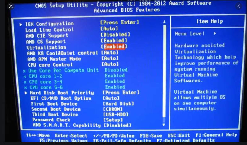

Or try disable SVM ( AMD-V ) / IOMMU in BIOS.
It's an old motherboard (Gigabite GA880) and I don't think I've seen anything about SVM ( AMD-V ) / IOMMU in the BIOS................But I will look again

Well, I just tried with a Kinsgton Datatraveler 2.0, and I'm getting the exact same results. Blinking cursor after "Loading  /bzroot...OK"
That's weird
Even when I try the memtest86+, it says loading memtest...OK, but then nothing other than a blinking cursor
That's very frustrating......!

Try below BIOS setting
I did come across this post, and set it to Enabled, but it didn't fix the issue unfortunately...
Not exactly BIOS for GA880, pls check have Virtualization option or check EFI CD/DVD Boot Option too.
Edited by Vr2Io
1 minute ago, Vr2Io said:
Not exactly BIOS for GA880, pls check have such option or check EFI CD/DVD Boot Option
I have virtualization in my BIOS, and it is set to DISABLED...
