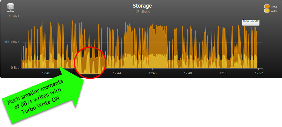

I didn't mess with the RAM cache settings yet, but I did turn on Turbo Write.  Since enabling it I have been able to run a MS Explorer SMB drag and drop style transfer from another machine (2 huge writes total) without having either transfer fail.
The Explorer based copy has slowed a bit.  The bulk of it happens between 80-100MB/s which tells me it is still RAM caching like crazy.  It still goes near 0B/s when flushing and if it is a single huge file it will completely bottom out at 0B/s.  The good news is these stalls don't last long enough to cause the transfers to fail anymore 🥳
Turbo Write seems to allow it to flush fast enough and prevent the major stalls that I was seeing before.   My attached graph seems to verify this because the gaps between the bursts of array write activity are MUCH tighter than they were before.  I haven't timed it, but I assume it was stalling at 0 for ~60-90 seconds VS maybe 5-15 seconds with Turbo enabled.
I assume I could reduce the stalls even more by changing the max RAM cache to 4GB as per @JorgeB, but I dont want to touch anything because it is finally running without me having to babysit.
