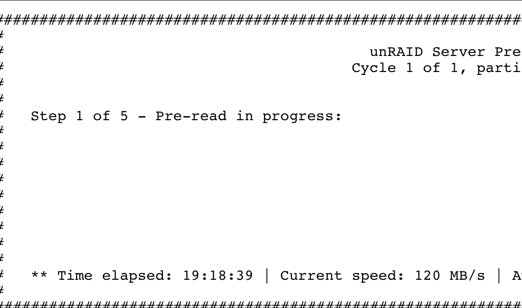

Preclear 100 hours?
I’m at the end of the pre-read. It’s taken about 20 hours. It also says that’s step 1 of 5. Can I ballpark the total time to 20hrs x 5 =100hrs total?
these are 17TB drives.
Whew.
Not all steps are of equal length so 100 hours will be pessimistic.    Basically there are 3 time-consuming steps with the pre-read and write phases taking about the same time, and the post-read being a bit slower.    However as you are seeing this is definitely not a fast process with the very large sizes now reached by modern drives :(
