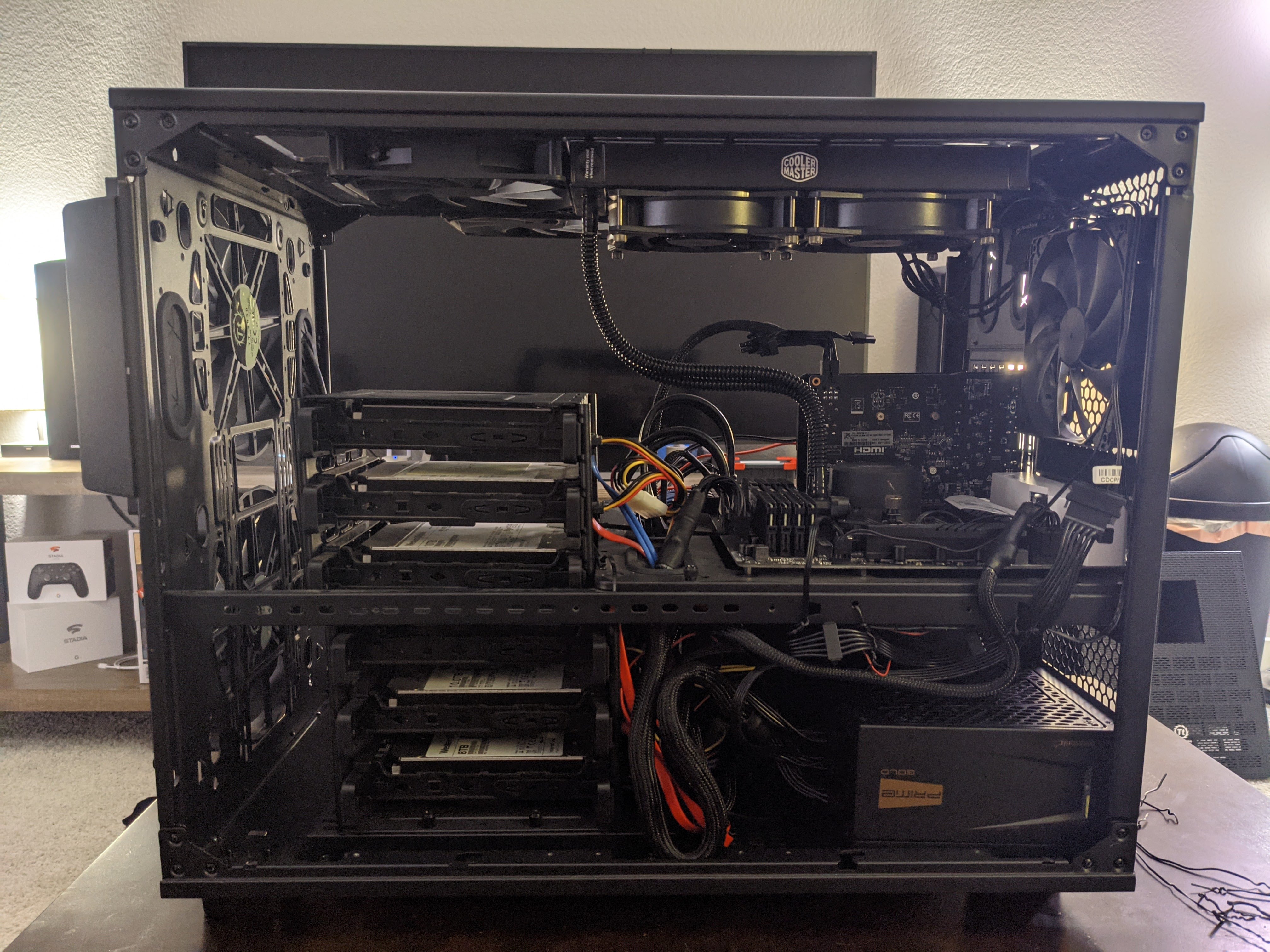

To start, we should talk about my setup. To simplify, I'll post my old signature to cut to the chase. But in short, it was built up over time. Slowly adding drives as needed to satiate my data hording. Much of it was Plex media but I had setup things like a Pi-Hole, Nextcloud, personal VPN (for when I wanted to use public Wi-Fi on my phone in a safer manner). Much of this I think is pretty common in our community so my server wasn't really that out-of-the-ordinary.
Config - Pre-incident
Unraid Plus
MB: ASRock X370 Taichi | CPU: AMD Ryzen 7 1700 | RAM: 32GB DDR4 | Cooler: Cooler Master MasterLiquid Lite 240 | Case: Thermaltake Core X9 | Cache: CORSAIR FORCE Series MP510 (960GB) | Parity: 2 X WD Red 10TB | Array: 3 X WD Red 8TB, 4 X Seagate 8TB, 2 X WD Red 10TB | GPU: XFX Radeon RX 560 | PSU: EVGA SuperNOVA G2, 80+ GOLD 650W
(Side note- never went full enterprise/rack mounted due to some confusion around backplanes and concerns over fan noise)

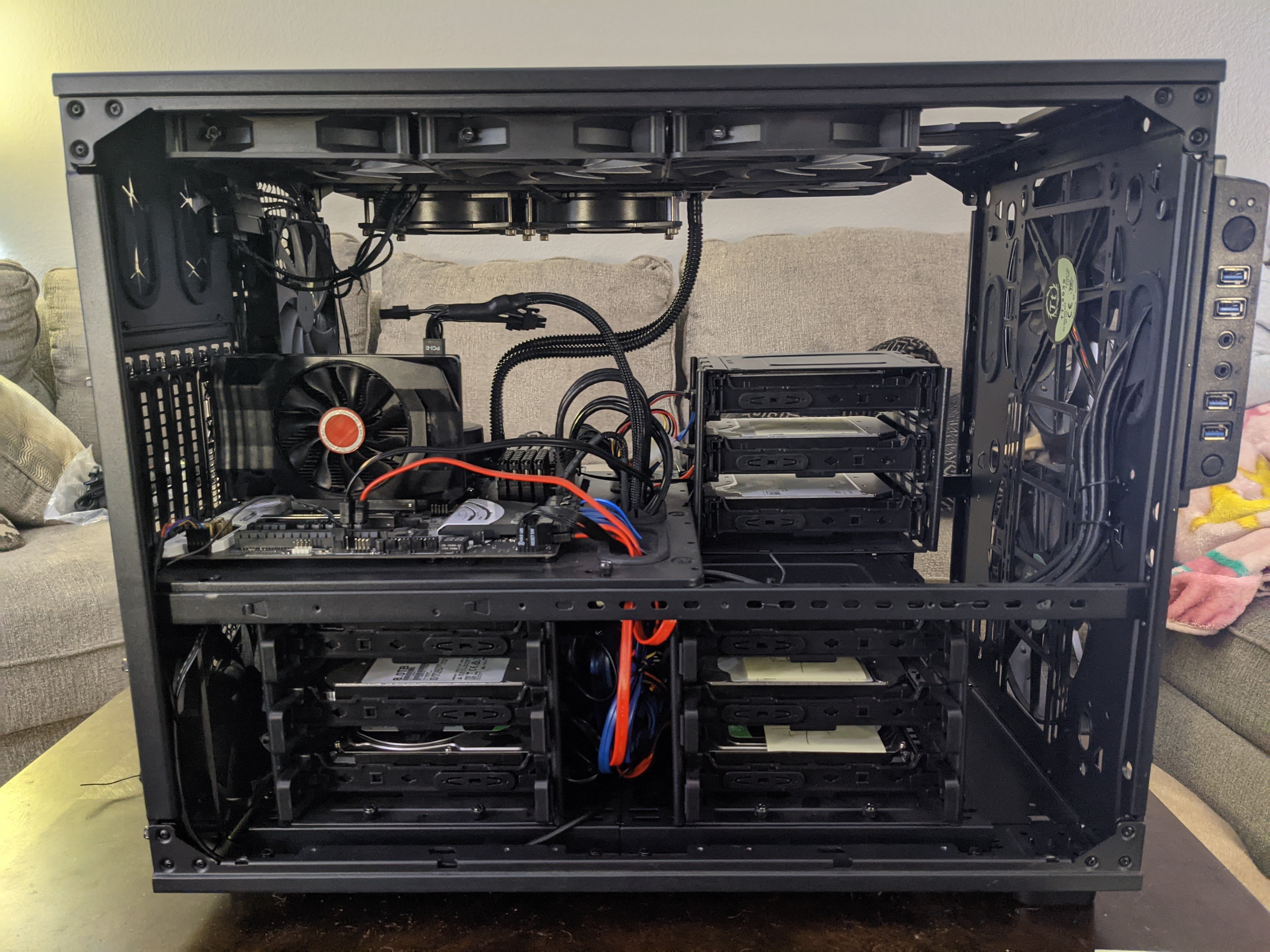

So this all started back when I resolved to add more streaming capability to the plex server. I simply wanted to be able to more comfortably encode/direct-stream more concurrent streams. Toying with the Idea of adding a Nvidia GPU rather than my Radeon which doesn't support hardware acceleration. But thanks to some great advice on the unraid discord, I would only add 3 or so streams, not a meaningful improvement for the cost. So was still debating a full motherboard and CPU upgrade. But one thing was clear, I would likely need to upgrade my power supply to support any major changes, GPU, CPU or otherwise.
Christmas came and my wife, the incredible Rockstar that she is, blew passed our gift giving budget (for each other) to buy me a Seasonic 1300 gold. (before anyone says it, platinum or titanium would be nice, but the power savings would be nominal and the return on investment was negligible especially at the premium). Needless to say, I was elated.
I planned to turn down the server and and carry out the upgrade in one day. If you have ever upgraded a PSU, its not that big a deal usually.
For anyone who doesn't know. Power supply units convert my American 120v AC power into DC and deliver multiple voltages to the various components. The connectors on the PSU side of the power cables are often keyed or shaped in a unique manner to ensure that they only fit/plug into the correct voltage ports. Square peg, round hole type of thing.
Skilled hardware builders out there, you know what's coming.
I checked the preexisting power cables. The motherboard and GPU cables didn't fit. Easy enough, new unit has cables. I swapped those out. I double checked my work, plugged it all in, flipped the switch to turn on and the PSU clicked. A Common sign of a power fault or fault protection. Something was wrong. Perhaps something wasn't fully connected or maybe a new cable was faulty. After all, even Seasonic for all their track record, isn't infallible. But nothing looks wrong and I don't NEED the new PSU today, so I'll reinstall the old unit PSU and have the new PSU exchanged as faulty and try again in a week or two. No big.

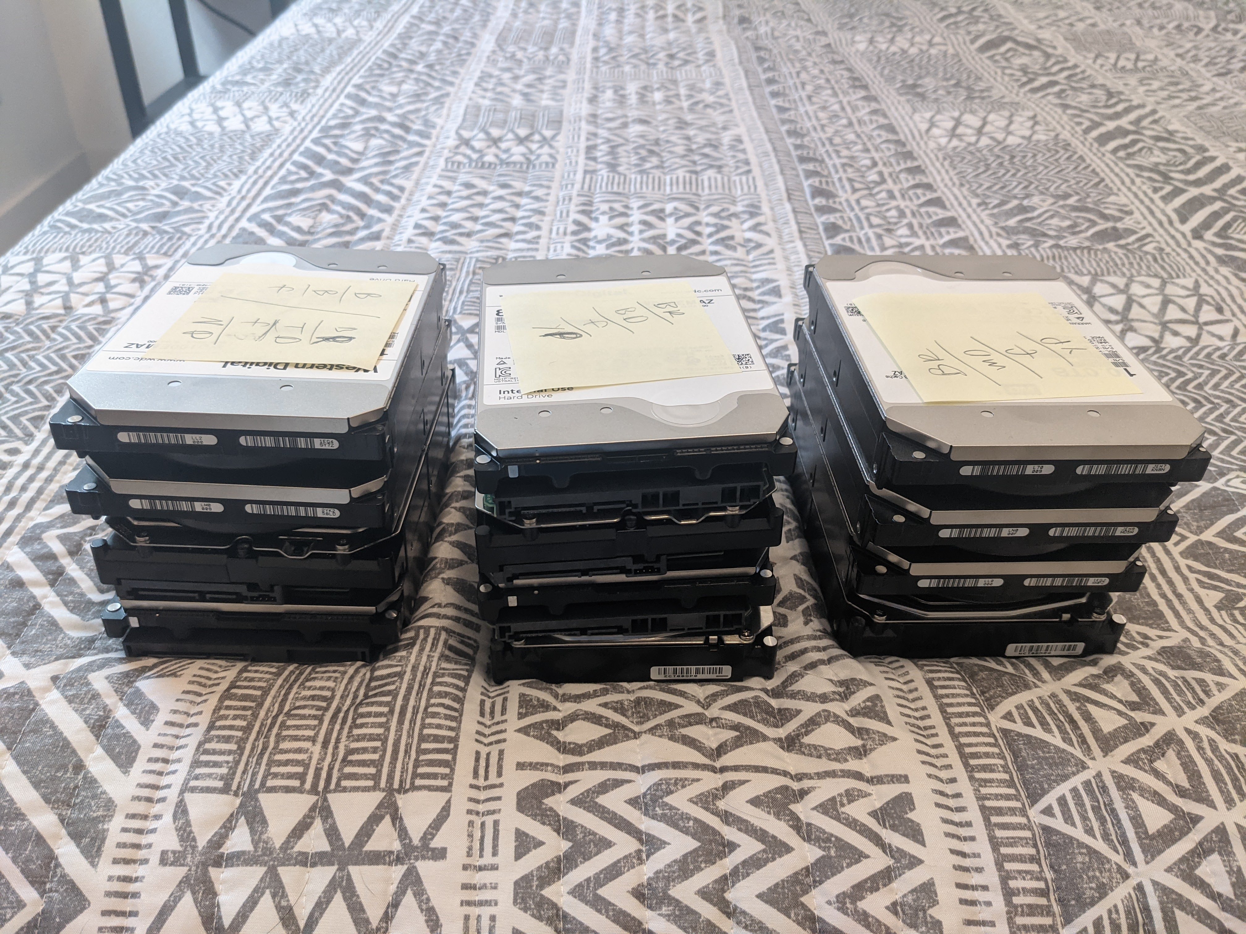

Old PSU reinstalled, turned on, BIOS shows no SATA disks....started trouble shooting and checking. Pulled HDD and attempted to connect directly to a windows machine to just see if the device is detected.... nothing. None of them.
If you didn't connect the dots to what has transpired. Though a square peg doesn't fit into a round hole, many other shapes do fit into a square. Including the wrong voltages being unintentionally sent to my disks, frying the circuitry to all 12 disks including the parity drives, not that 2 of those could repair this level of dumassary.
I can only explain the emotion I felt as mourning the loss of a loved one. I mean, you must understand, this was my biggest hobby and pleasure. Learning the endless capabilities of what I could do with Unraid.
I did check with well known data recovery services but with the sheer volume of data... the quote was $9,000-21,000 dollars. Though they did say that if no data was recovered, It would cost me zero. A testament to the undoubtable quality of work they would be able to offer. But this isn't enterprise data. the financial risk to me was nil. For more reasons that the obvious, this was not a viable path forward.
