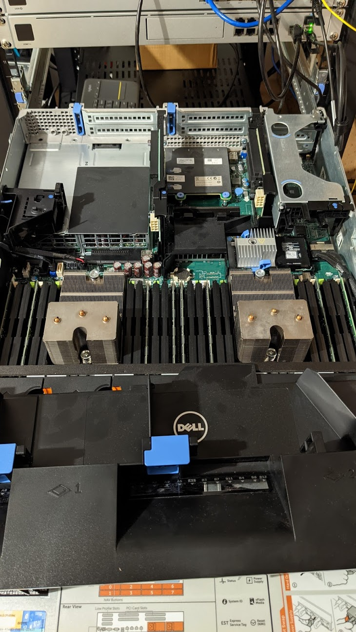

For what it's worth, this is my server here:

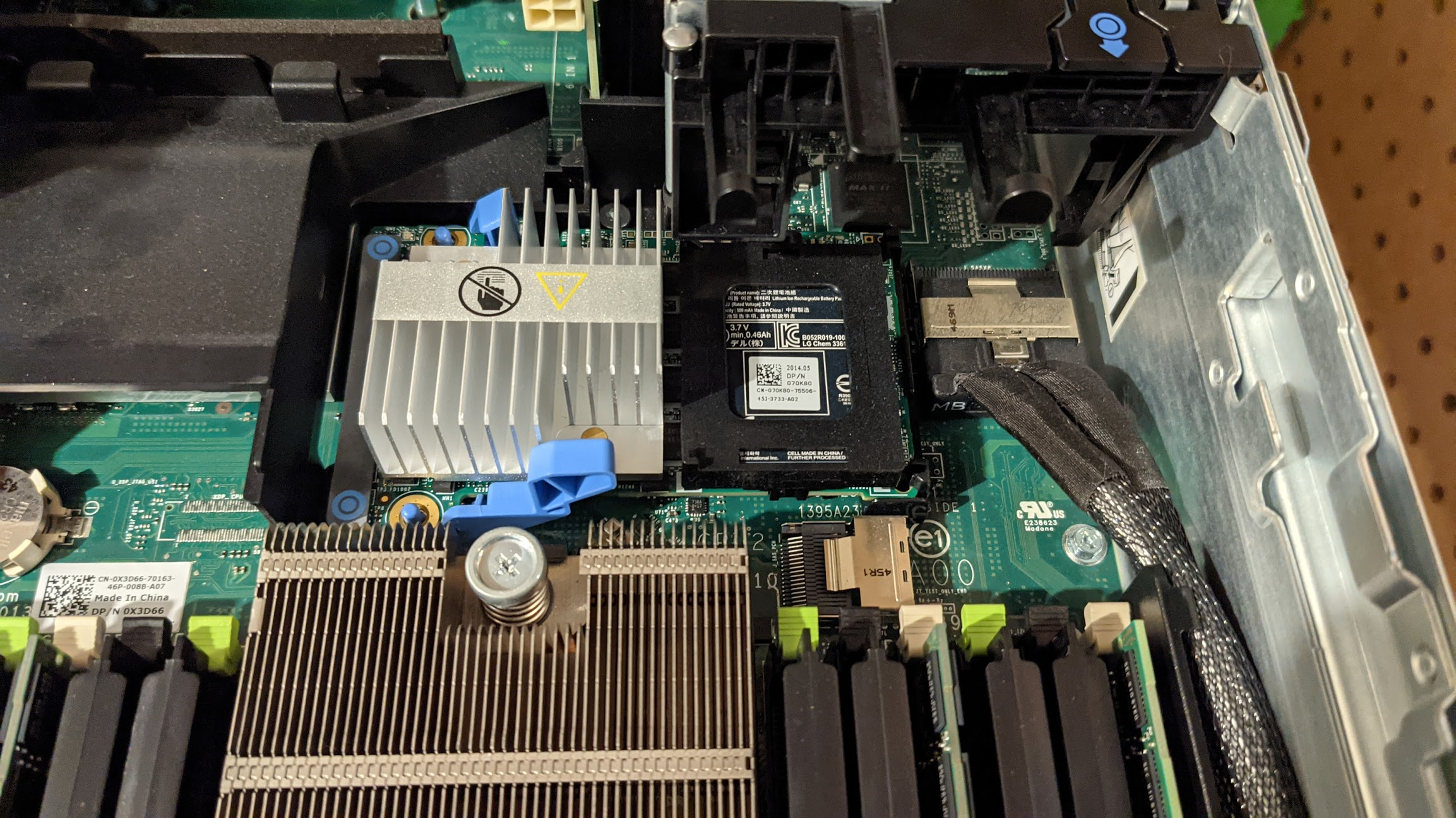

And If I'm correct, this is the H710 mini?
Guess my other concern is how to go about swapping that.. it looks easy enough, but I assume if this is the H710 mini, I need to replace it with a H310 mini that would install in the same spot, right?

2 hours ago, NVS1 said:
I can get a mini, and replace the H710 Mini with that one.
Prefer this option because you no need care about original cable, otherwise you need reroute the cable to add-on PCIe card.
Edited by Vr2Io
You have the option to flash the H710 you currently have yourself:
https://fohdeesha.com/docs/H710-D1/
I was able to follow these instructions and flash the one that came with my R720xd

Interesting, Chip model also change from 2208 to 2308.

Hmm.. this is interesting for sure. I assume worst case scenario, if I happened to brick the H710 doing this, it's just a matter of swapping it out with the H310, right? No other damage to the system, BIOS, etc.

Note, never mind the misunderstanding. Flash H710 should be best the options.
Edited by Vr2Io
Just an update on this. I was able to flash the H710 Mini, and the server is now back online, and the system is running through a parity check. Everything seems to be in order however.
