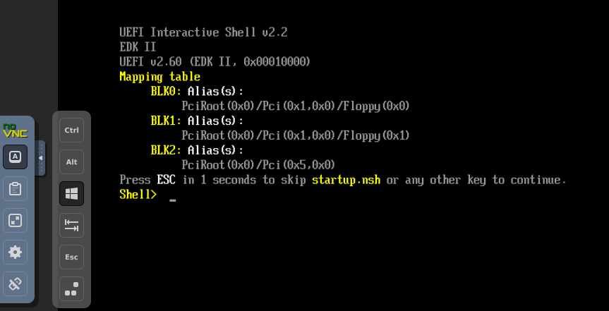

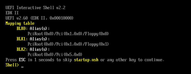

I installed windows 10 VM and Win Server VM, how do i access it. Is there a video or instructions?
35 minutes ago, TechRay said:
Now that I got it running with the 2TB and 1TB.
Did you setup these VMs to have their own video cards?
No, I didn't I just went into VM and added
Have you watched any of Spaceinvader One's youtube videos?
