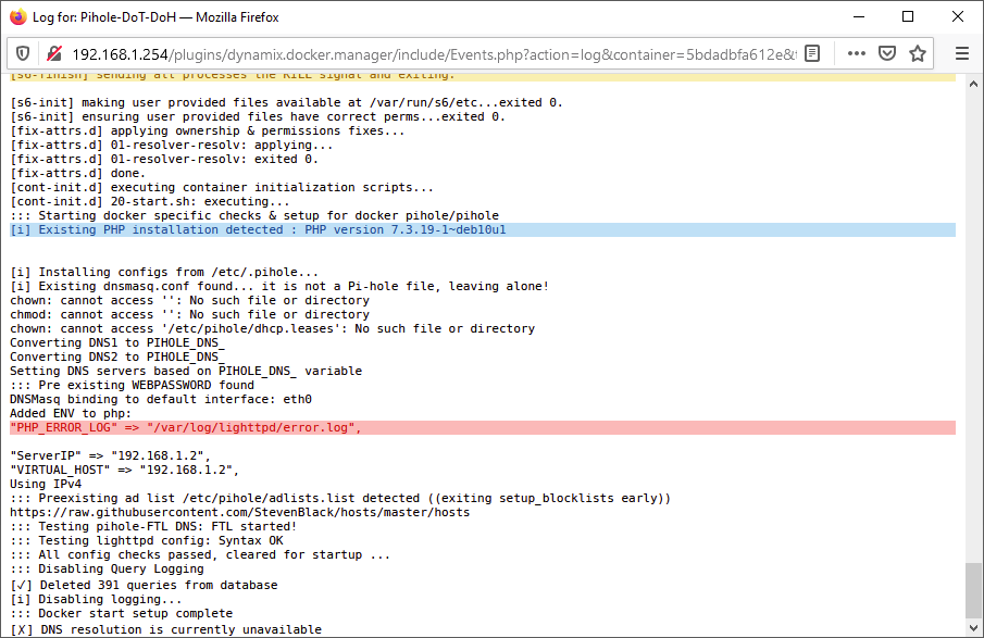

Docker was working fine for awhile, but last night I restarted the server and could no longer access the web UI anymore.
I pinged the docker's ip (192.168.1.2) address and it is responding, and I checked my router's device list and can see the static ip of docker is there.
I went ahead and download the "pihole-template" docker and that worked just fine. Not sure what happened after the reboot.

This is quite odd.
Could you please try force an update for the pihole
(Hit basic view slider to make it advanced, and then click force update on the pihole docker)
After the update is complete please try start the docker again and see if the web UI loads correctly

@FlippinTurt
Thank you for helping. I tried many things, and sort of able to recreate the problem.
1. Docker and router dns server all setup and working properly
2. Server reboot, the pihole-dot-doh stopped functioning.
3. At this point, I can get it to work again by setting the router’s dns server back to known server such as 1.1.1.1 or 8.8.8.8, etc., and restart/reinstall the docker.
4. Change the router dns back to the pihole-dot-doh address.
Somehow the pihole-template docker is immune to the server reboot.
I still need to experiment a few variables such as setting the pihole ip address in my asus router’s “LAN DHCP” menu or the “WAN” menu.
@FlippinTurt
Sorry to waste your time. The answer to my problem is right in front of me this whole time.
"NOTE 3: UnRaid network settings DNS server cannot point to a docker IP."
When I set the pihole address in the "LAN DHCP" menu of the router, it automatically updated the unRAID's network DNS server to the pihole's IP.
The solution is to strictly use router's "WAN" DNS server setting and leave the DHCP's DNS menu blank (for asus router at least).
