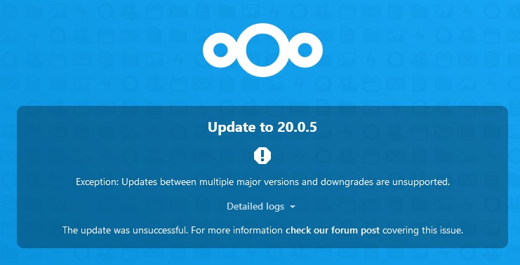

Oh, yes - before anyone asks this is a new NextCloud Server as I have been using the Linuxserver Nexcloud docker for ages, but everytime there is an update I end up with it failing to update, so this time followed the manual process as is said that it wasnt compatible with PHP7.3 and wouldnt even let me login... but now after the manual process I have this error;
So decided that the more robust way is to create a Nextcloud VM on 20.04 LTS rather than using a docker and mounting my \mnt\user\nextcloud share from UnRAID (which is where all my data is) then using occ on the Nextcloud VM to rescan all my users data 🤔. Any assistance will be greatly appreciated as I know I am so close with mounting the share in my VM and my Nexcloud Server has been offline for 3 days now 🤨
