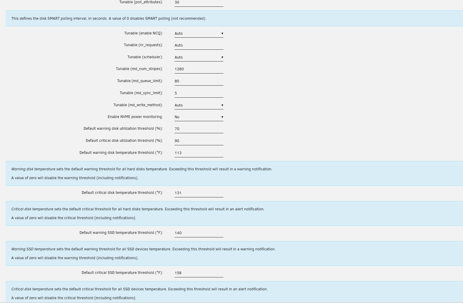

I believe tHe frequency is determined by Settings -> Disk settings -> Tunable (poll_attributes): which has a default of 1800 seconds (30 minutes).   I normally change it something shorter like 300 seconds.
Thanks itimpi, I had no idea what that setting was for.  300 seconds seems perfectly acceptable to me, so I have now modified it 🙂

Default setting was "30" and is not labelled as Seconds vs Milliseconds in the Settings UI (UNRAID 7.1).
I belvie default its 30 seconds... I remvoer seeing that value some where before...

Disk settings is the interval to read smart data. I think itimpi is corect that the same setting also affects the read...
per chrome inspect this is being php pulled from the disk log. not smart.
