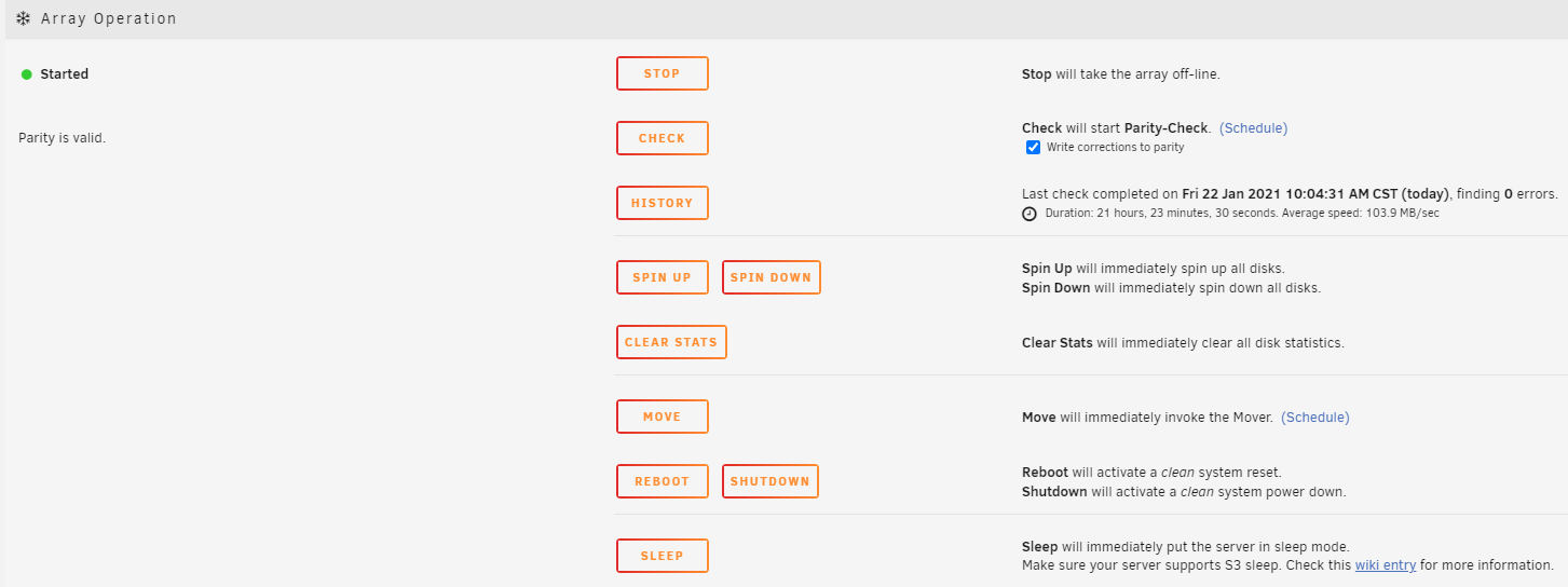

parity check caused disk to disable
i had to rebuild my drive array to shrink the array,
then, i added a 2nd parity drive.
i did a parity check and got no errors.
i added 1 new drive, did a partial parity check to see if i had any issues with other drives because this is where i can see the issues. saw no issues around the first 250gb so i stopped the parity check.
i then added another new drive, did a parity check again and saw no issues.
i then went to do another parity check, and towards the very last 2 hours at 8am, disk 1 got disabled with errors. parity check said it had 0 errors and says it completed at 10am. what happened to disk 1? i have not moved or disconnected cables from parity 1, parity 2, disk 1, disk 2 for over a year. the reason i added parity 2 earlier was due to the array rebuild during a shrink but 1 week ago till when i added the drive, parity 2 was enabled and working.

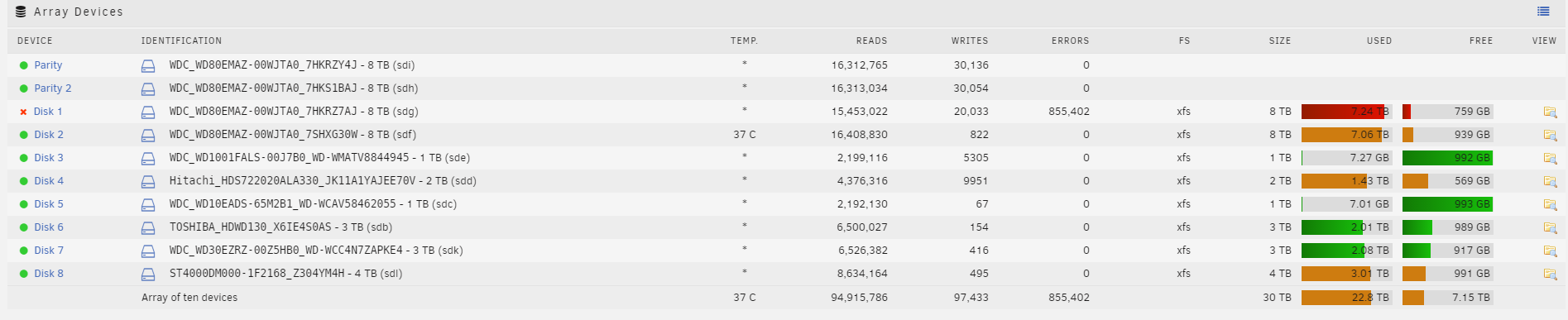

Looks more like a connection problem, replace/swap cables on that disk.
Not like disk problem, but the disable disk have 16903 UDMA_CRC ERROR, other same type 8TB disk have't, pls swap cable or port and enable SMART monitor on item "199" until it not raise again.

Stop the server, check or change DATA and POWER connections on both side, including splitters.
Power back up and post new diagnostics.

so i have two LSI 9211-8i P20 IT Mode Dell H310 cards in my system. parity 1-2 and disk 1-2 are using sas cable 1 on port a of pci card 1. since it was advised to replace the cable, i just disconnected it and am using an unused sata from the other pci card 2 port a. i started the array back up and got the log. also checked all the power down the line from the disk all the way to the psu too. unplugged, plugged in.
